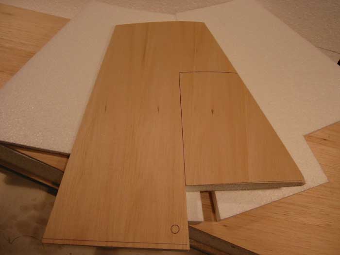

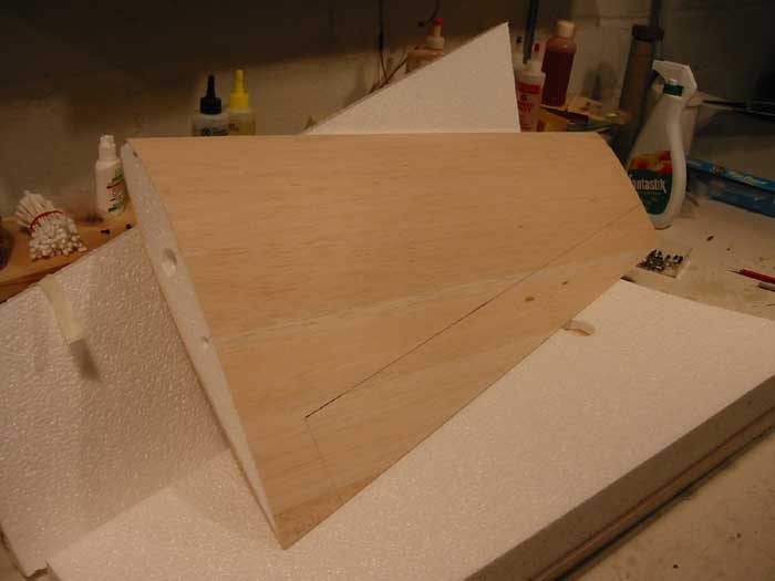

My CA Models Extra 24% Extra 300L arrived yesterday, and this thing looks phenomenal. This is my first quarter scale airplane, and my first kit that uses foam. Everything came presheeted; wings, tail surfaces and turtledeck are beautifully sheeted foam. Over the coming month or so (hopefully I can have it done that soon), I'll detail my building progress here.
The things I forsee being difficult:
-Cutting out the control surfaces
-Attaching the canopy
-Hinging - I'm going to use Robarts, and I've never used more than 3 per surface (a smaller model). This requires 8 or so per surface, so I'll be seeking help for those steps.
The cowl is gel coated fiber glass too! All for $189.00. Pretty great deal if you ask me.
Other than that, everything is laser cut, so I anticipate a smooth ride. Here's some pics!

Old 05-15-2003 | 02:49 AM
Joined: Jun 2002
Posts: 366
From: St. Paul, MN
Default CA Models 24% Extra 300L Build
A shot of the elevators...

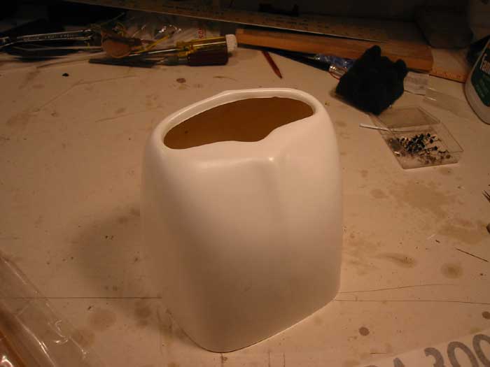

And the cowl. I always thought the cowls on extras make the airplane look sad.

Some tips from the get go. The plane will come out tail heavy with an OS 160. Dont know what your going to use but I am thinking of selling my 160 and buying a RCS 180 gasser. The cowl is too short. I plan on adding about a 1/2" to the length of the cowl. This is the reason the plane is tail heavy. The firebox has to be cut off , all but about 1" of it that is to accomodate propshaft length. adding some fiberglass or looking for a new cowl would allow you to push the engine out further and balance the airplane better. THE GEAR IS WAY TOO SHORT. an 18-6 prop will only have about 1.5" prop clearance even with a 1/4" spacer under the gear. The small cowl also makes my 160 overheat when in a harrier. You might want to consider a baffle in the cowl (my next mod) if your going to use a side mount motor.It's a good flyer but a few fixes could make it a great flyer

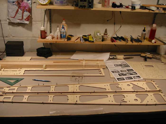

Here's tonight's progress. This manual is a killer. It took me about an hour just to put these longerons in because I had to decode the instructions. Nonetheless, progress continues. The picture on the wall came with the kit!

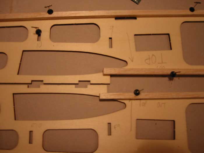

Hey Wreckman and Smallfly-
Do I have these longerons in correctly in the tail area? The only ones that I'm not sure about are the ones on the top. I believe that is F9, which according to the manual, the longerons should overlap by 5mm. It seems to obstruct the stab mounting bracket though. Is that just supposed to be trimmed away, or do I have it in the wrong place? I haven't glued anything yet because I wanted to ask you guys about it.
Thanks!
Reid
My "out" markings on the fuse are wrong. They're old. I'm definitely NOT building two sides of a fuselage! Although I have done that in the past...

Just trim it the shape of the stab cutout...
Also if I were you I'd assemble the wholw fuse before gluing anything. just ue rubber bands to hold it together then go back and glue it all.
PS. You think your instructions are killer and you have the updated version. LOL
You can get it to this stage without any glue.

I had planned on glueing the longerons in, and then doing the "3D Puzzle" until the step you showed me. Thanks for the tip! I'll go glue the longerons in now, and then cap off the glue bottle for awhile.

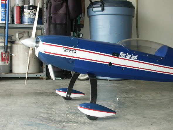

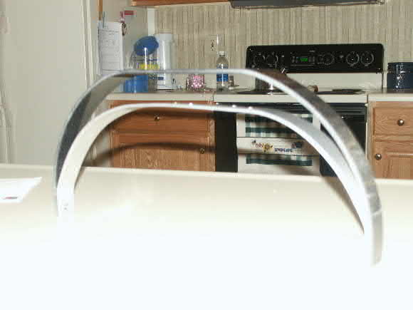

I got the CF gear yesterday and got it installed. I went from about 2" prop clearance (with the gear shimmed 1/2"in the well) to 5"
Awesome. I can even hang a bigger motor on it now if I choose and use a 20" prop. I'll post pics soon

I did not weigh the CF gear. It is longer but they felt like they weighed the same just by picking it up. The guy let me try the gear without paying for it (good guys are still out there) and he hasnt given me a cost yet but I would assume it would be in the 35-40 dollar range. The gear looks good. It has what I would describe as intermittent small foggy spots in it that was probably caused by high humidity while he was making them, but it is only noticable on close examination and has no effect on strength. Heck I might paint them anyway as the black CF doesnt really look all that great on my blue/white covering scheme. Similar gear that I have seen runs between 45-50 dollars elsewhere but no one had any to fit the CA specificlly.
Old 05-16-2003 | 06:24 PM
SMALLFLY-'s Avatar
My Feedback: (19)
Posts: 2,156
From: Evansville, IN
pic new gear vs old

New gear on : I still have a 1/4" shim under the gear that I will probably take out
e mail me If you want the contact for the CF gear
