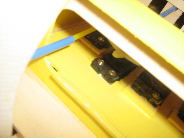

I've been working on it, but I've forgot to take the camera the last few trips.

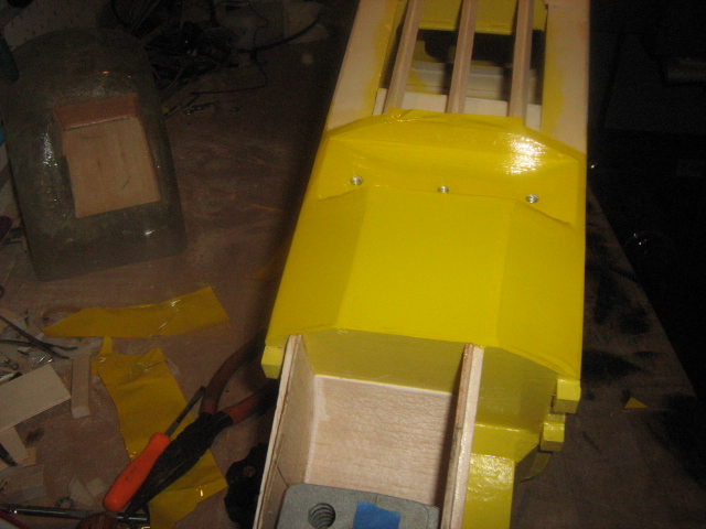

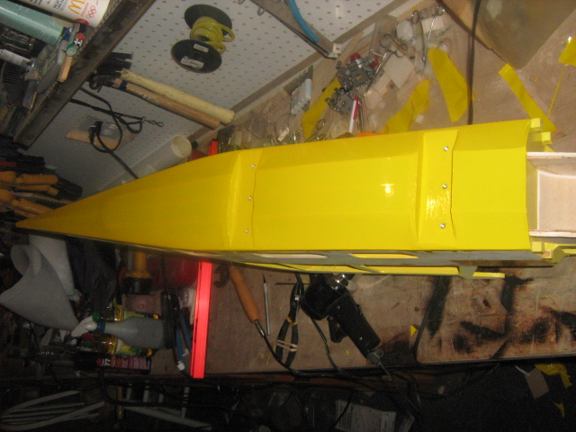

Today I made a block to it over the landing gear. I wanted it to look clean when assembled. I also made a block to fill in the rear float mount when not in use.
Put on a second, final, coat of yellow paint on the motorbox and inside the fuse. Tomorrow I will sand any runs off the outside of the fuse and cover it.

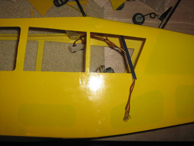

Got the fuse covered today.

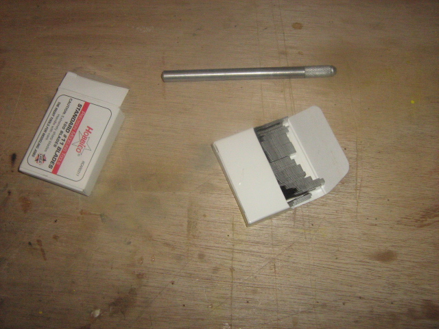

Most important tool for covering.... #11 exacto knife and a box of blades. I usually get about 10 cuts out of a blade and then it starts getting dull enough to rip through the monokote instead of slicing cleanly.

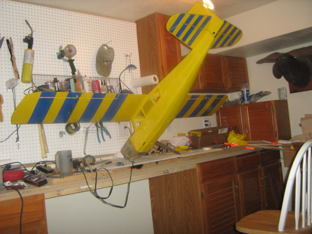

Covering the fuse sides and turtledeck.
2nd pic shows what happens when you get greedy with the heat gun. This looks like a GREAT spot for a sticker. [sm=lol.gif]
Pics of the turtledeck covering BEFORE I shrunk out the wrinkles.
And finally some bench flying. She's lookin' pretty good.

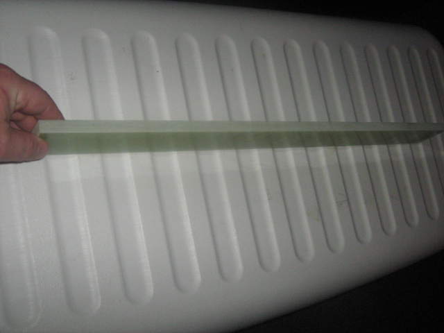

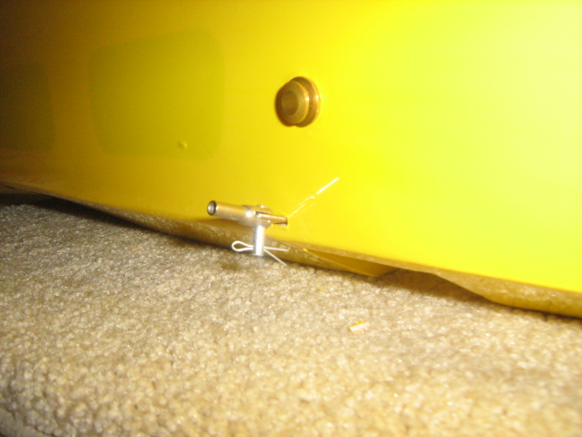

No building tonight, but the big brown truck did drop off a hunk of G10 epoxy board. Tomorrow I will start on the twister intake for the carb.
This 2" x 24" x 1/2" chunk cost about $30 delivered. Not cheap, but enough to make a handful of carb blocks.

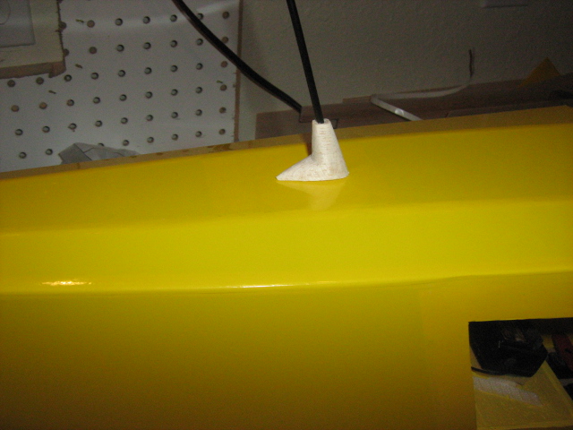

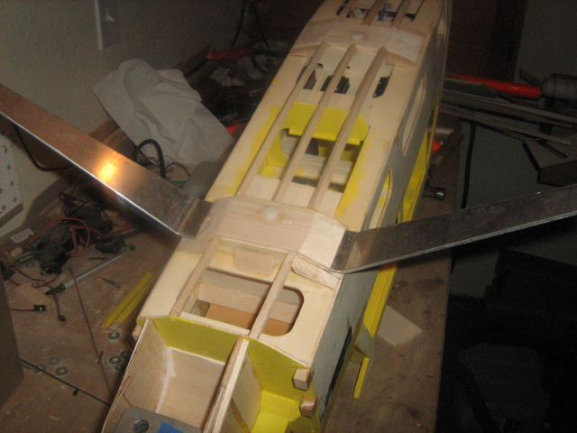

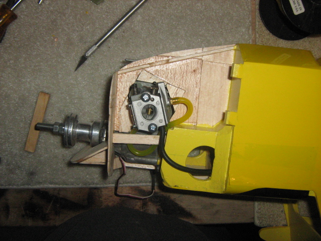

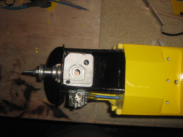

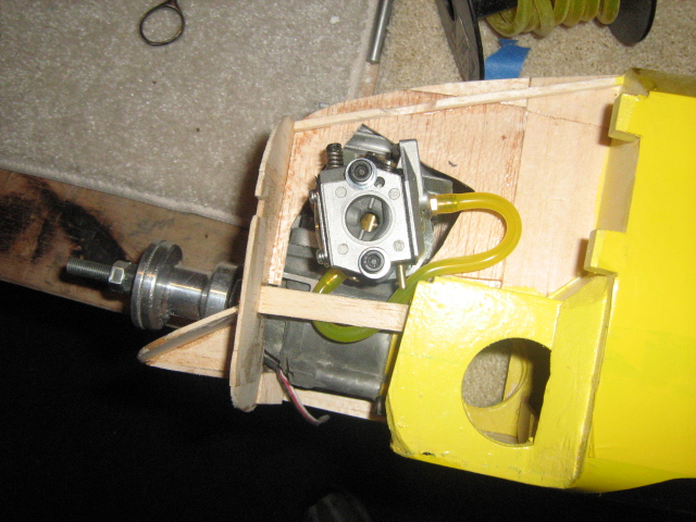

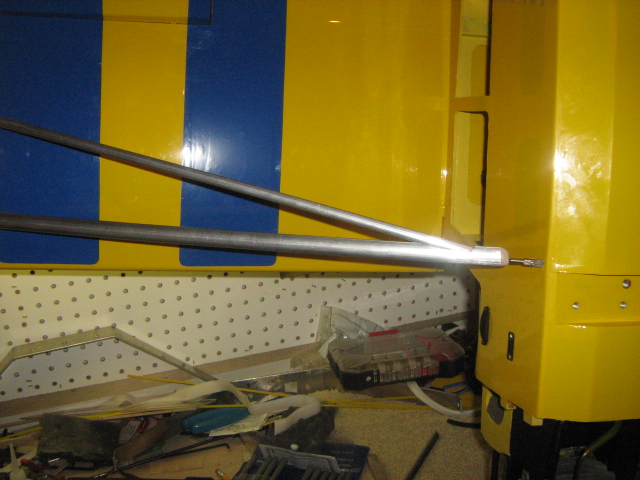

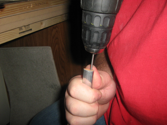

Making the carb twister intake and running some fuel lines.

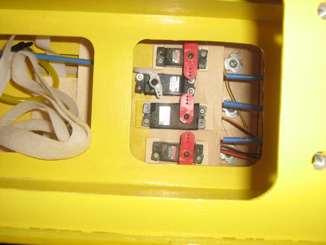

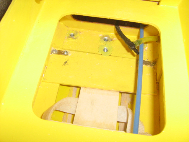

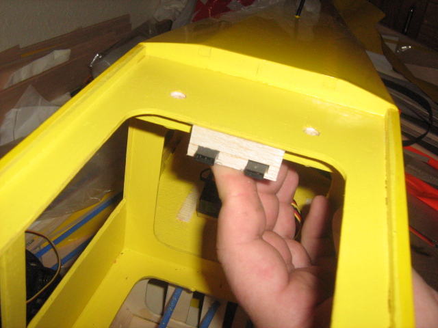

Working on the throttle pushrod and throttle servo. Can't get it quite perfect. Endpoints are H - 61 and L - 69. Not the best resolution, but at least it's linear.
Painted the baffle tonight. Tomorrow I will put some foam gasket around the baffle to take up the gap between the cowl and the baffle. I'm hoping this will be just thick enough to compress a bit when the cowl is attached and provide a good seal to keep air directed where it needs to go and at the same time provide some isolation between the cowl and the baffle. I do not want the cowl touching the baffle. I want the cowl to compress the foam gasket just a bit but not touch the baffle. Thats the theory anyway. We'll see how it works after I glue it on the baffle on tomorrow.
Yes, I know the elevator and rudder servos only have 2 screws in them. I plan to put the rest of the screws in the servos before I fly it. Don't have a cow and send me a bunch of PM's calling me an idiot. Remember, I'm still BUILDING it. Not done yet.

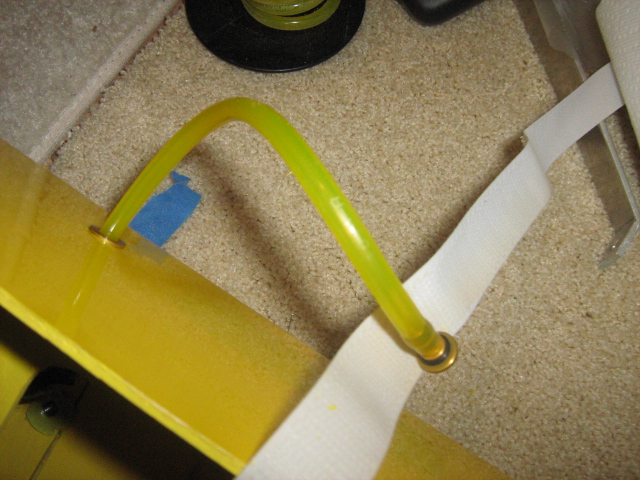

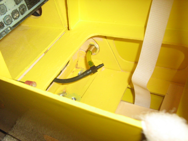

I put some foam weatherstripping around the baffle today. It works perfect. It stays in place and compresses just a bit when the cowl is on. I think it will seal up just fine and keep 99% of the incoming air directed down over the cylinder.
I worked on my aileron leads today. The RX is buried under the "suitcase" behind the back seat. I am not planning to take the suitcase off and attach my aileron leads every time I fly the plane. I cut a hole in a piece of plastic drinking straw and routed the wires through. The wires pass through the horizontal straw and into the vertical straw. Then down under the rear deck and back up through the hole where the rest of the servo wires are. Pain in the butt to route the wires, but I did it.

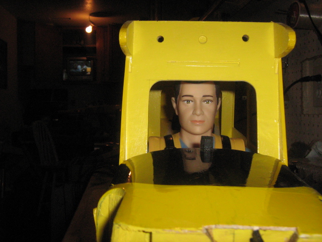

I didn't get much accomplished tonight.

Your pilot looks great. Who makes him and where did you get him? Everything else looks good too.
You're going to be cutting it close.

Man, you've been busy! I love the antenna base you made!
When you get it finished it is going to be a great entry in the build show. It is a beautiful example of what you can do when you put your mind to making a stand-off scale plane while keep the weight and complication down to something reasonable. Most of the best (read contest winning) warbirds and scale planes are so grossly overweight that their flying and trim characteristics are totally blown. Which is why they are kept out of the air, and in the garage 99.8% of the time! You are going to have a great flying, fantastic looking airplane when it's all said and done!

The pilot is from airborne models. It's the 30% size.

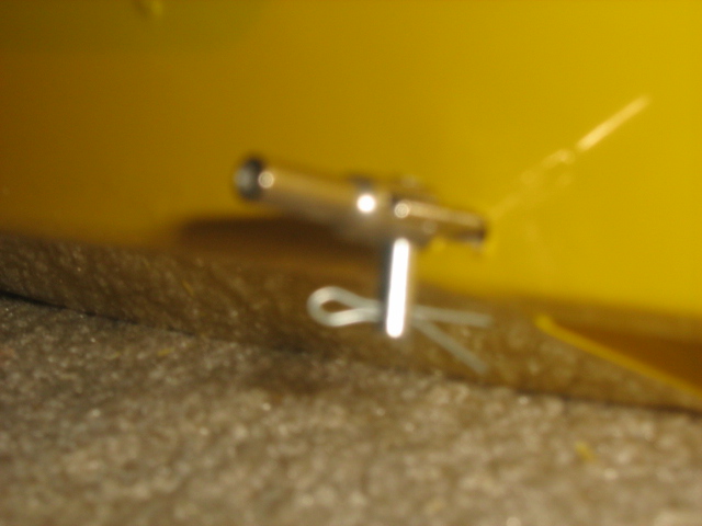

I bought K&S streamlined aluminum tubing tonight at Hobbytown. I'm going to use it for wing struts. I'm going to use these triangle brackets to install the struts to the bottom of my wing. The triangle pieces would screw flat to the hard points in my wings. I'll have a 4-40 ball link out on the end of the strut. Run a 4-40 bolt through and use a nylon nut to secure it.
http://www3.towerhobbies.com/cgi-bin...7&I=LXGKG9&P=K
The struts will stay connected to the wing all the time.

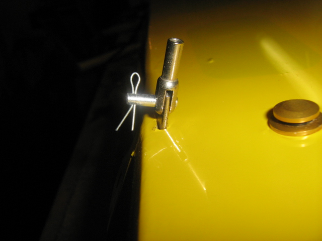

I want to use a pin for the bracket on the fuse. The pin can be one of these aluminum pins that come with the DuBro #866 heavy duty control horns.
http://www3.towerhobbies.com/cgi-bin...?&I=LXDCU2&P=7
I am hoping to use a body clip for RC cars to secure the pin. For removal, I would simply pull the clip and then pull the pin out. The struts would stay attached to the wing all the time.

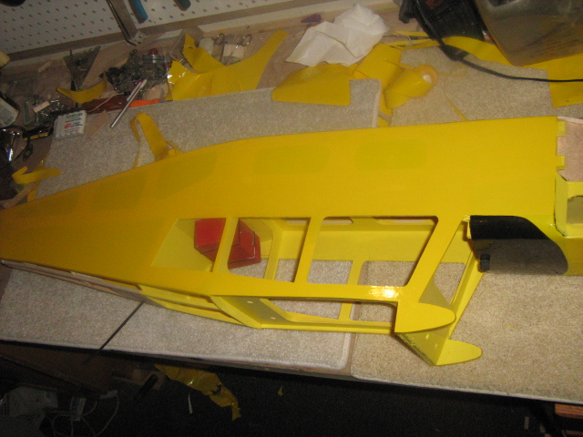

I put the pushrods for the tail in tonight. Cut them off about 3" long.
Pins for the struts. Still need to get an RC car body clip.
Painted the antenna base.
Working on the wing struts.

Mocking the struts.
Codiddley helping out with the templates before the actual cutting of struts.
I put the balsa blocks in the struts and use a little thin CA. It wicks all the way through. Then drill a 1/16" hole. Cut about 2" or 2.5" of 4-40 all thread and chuck it up in the drill. Run it in the balsa to make threads. Back it out and then fill the hole with PLENTY of medium CA. Run the all thread back in and then release it from the drill chuck.
Plenty of time was spent drinking black-n-tans, made with Guinness and Boddingtons pale ale or Guinness and Buffalo Gold pale ale.
I got both sides mocked up tonight. Waiting on the Tamiya suspension brackets to come in at the LHS.
I plan to use JB weld to secure the smaller struts inside the leading edge struts. I'll sand it down and make a nice fillet. Etch the aluminum with some vinegar and then use an etching primer on it. I don't know how well Krylon will stick to etching primer, but I'm gonna find out.
