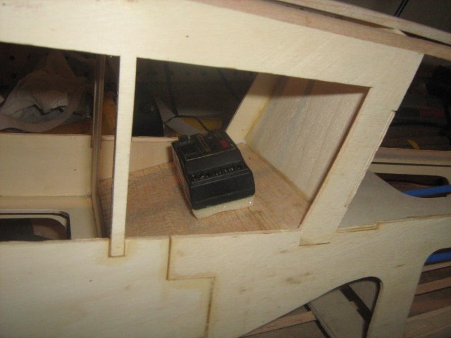

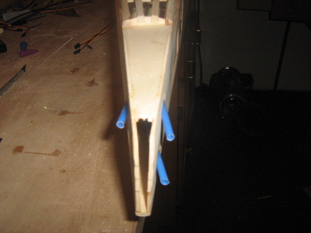

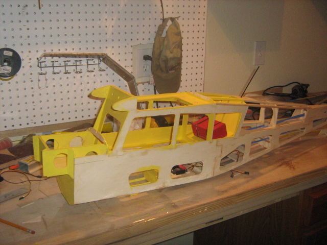

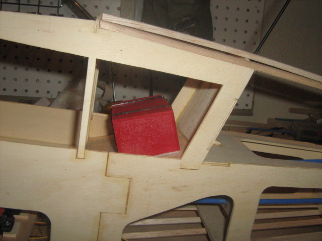

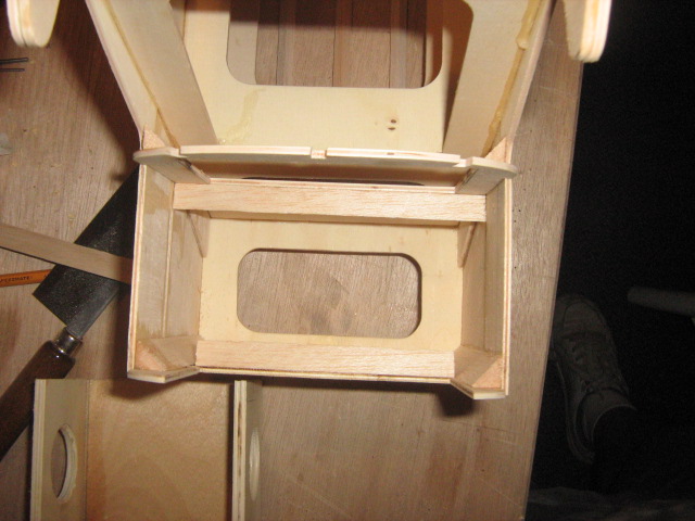

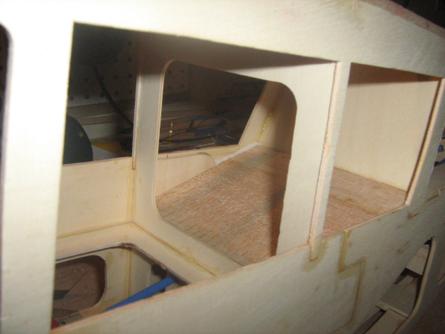

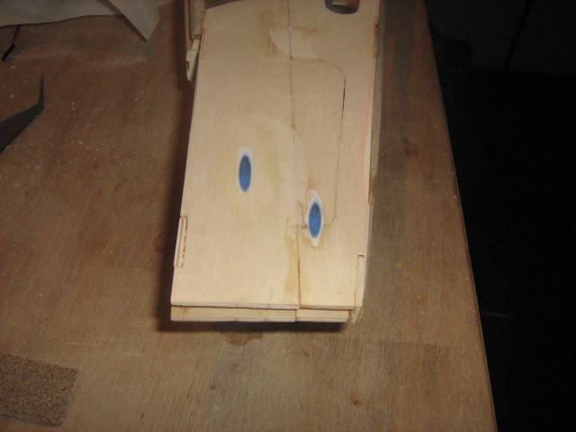

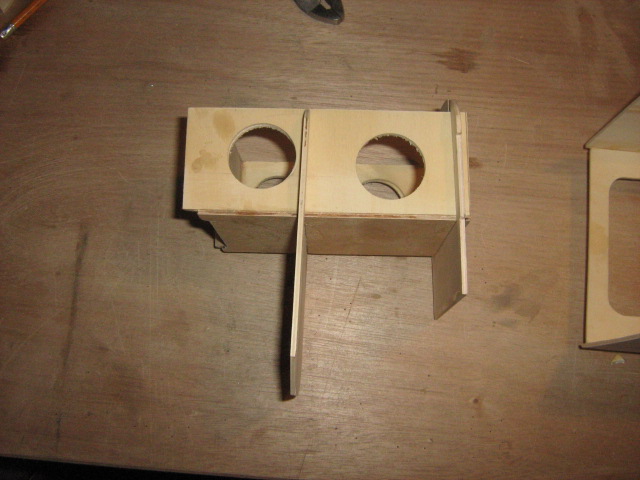

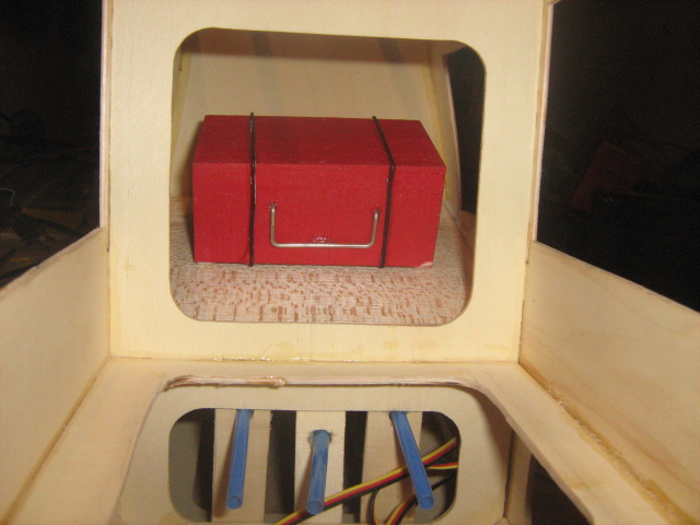

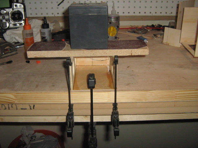

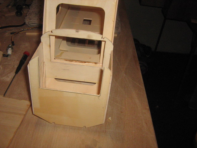

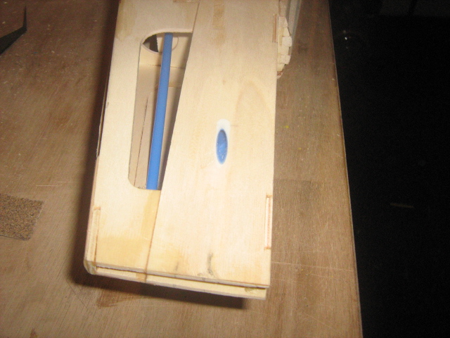

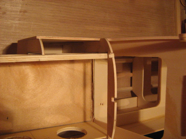

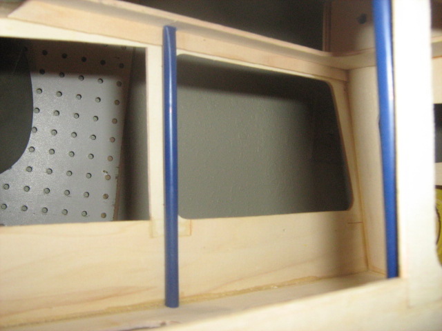

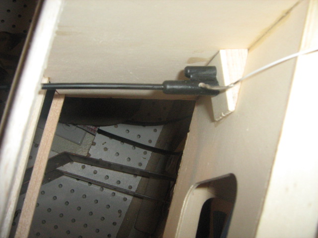

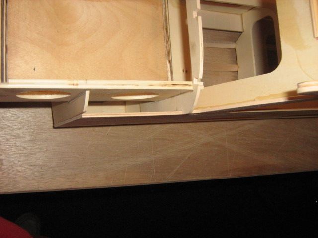

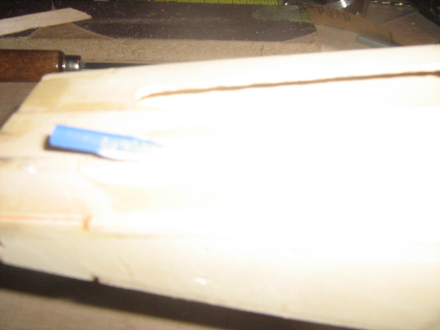

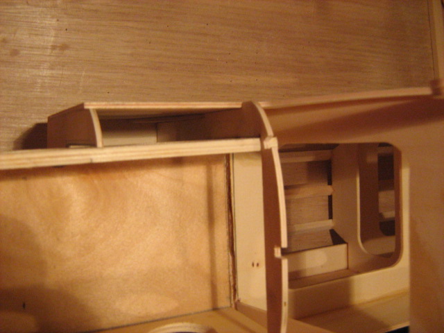

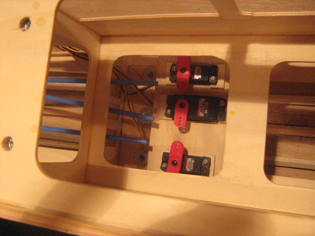

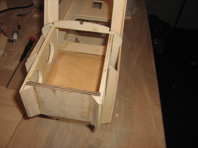

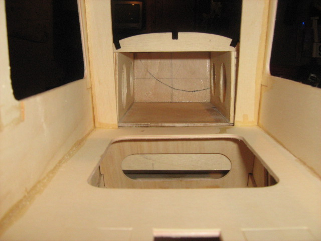

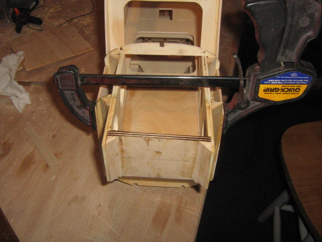

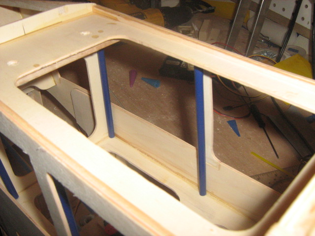

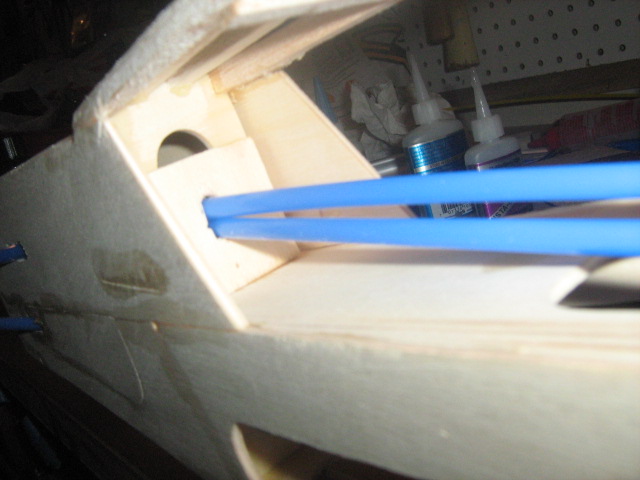

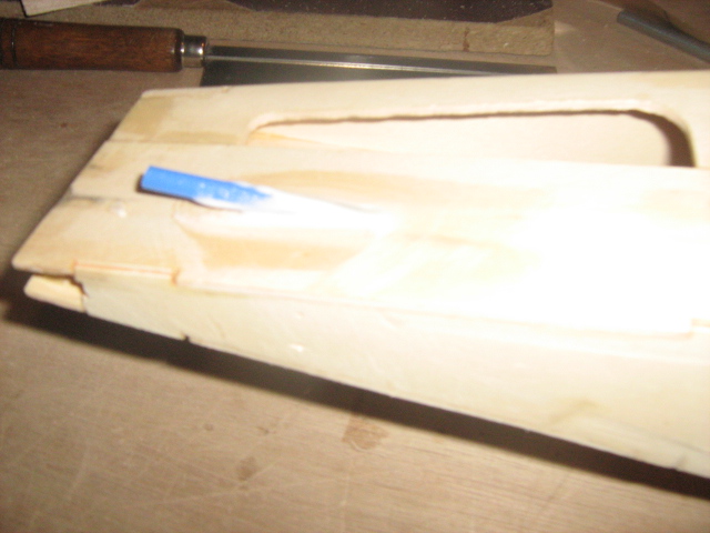

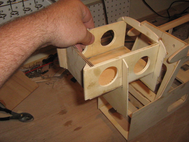

Still working on the motorbox modification.
I dialed in some right thrust and also a bit of down thrust. You can see that I've used 2 layers of 1/8" lite ply as the sides of the motorbox. Glued these together last night with some 30 minute and pressed them overnight under about 20 pounds of weight. The inside piece on the right side of the motorbox is 1/8" shorter than the inside left piece. This gives me the right thrust. The bottom of the firewall is 1/8" back than the top. Thats my up/down thrust.
Did I measure anything to calculate exactly how much down thrust I need? No. I'm using the old "thats about right" engineering philosophy. Been using it on a lot of kits over the years and I'm getting pretty good at it. Worked on the Sig 4*120. Worked on my last Extra before that.
All I did was cut the right side inside piece 1/8" shorter. Both pieces the bottom is move back 1/8" for some down thrust. Thats it.
Had to make a couple formers. I took the F17 former off the bottom of the fuse and incorporated it into the former you see in the pics. I'll call it F2a. I added a former at the back of the motorbox. You can see the center former that runs horizontally through the fuse has been cut out at F3. The top fuse former (1/2 moon and 3 notches for stringers..F20?) that makes up the top of the dash panel has been replace with the lite ply former you see at the back of the motorbox.
Still need to glue it all in. The front of the fuse sides will be measured and squared up perfect. They are within a "frogs hair" right now, but I want it perfect. Then I'll set the rear motorbox former in place and line it all up so my motorbox is level. Clamp these all in and when they are dry, I'll add tri-stock in a few places around the formers.
Then I'll need to glue the motorbox into the formers. Tri-stock it. I'll leave the top of the motorbox open until I'm almost done with everything. It's usually one of the last pieces I put on a plane. Once it's glue on, there's no getting your hands in there anymore.

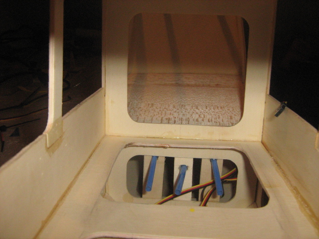

Took a break for a week when his beloved dog died.
I glued the motorbox in and started covering the horizontal stab and vertical fin this weekend.

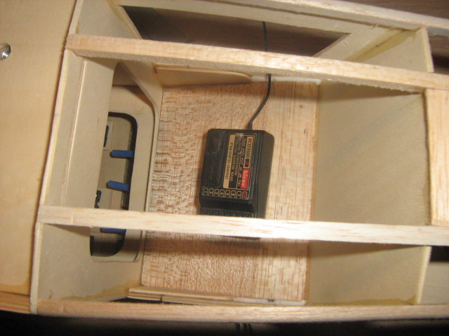

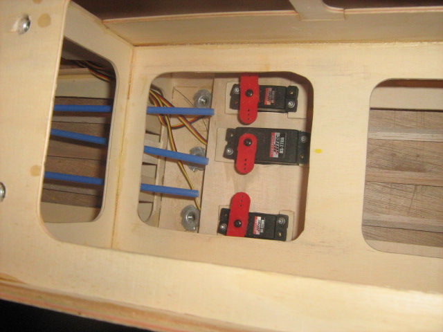

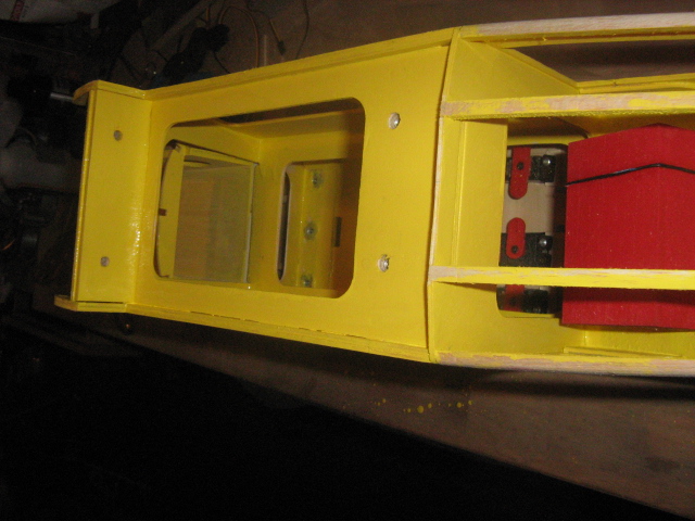

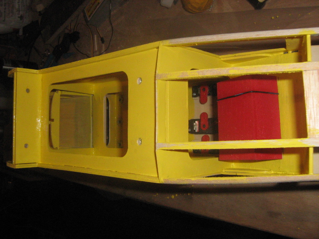

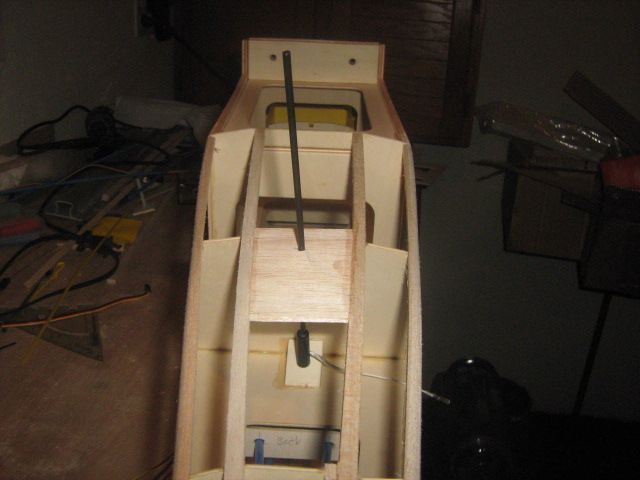

These are pics from last week. Glued the motorbox in.

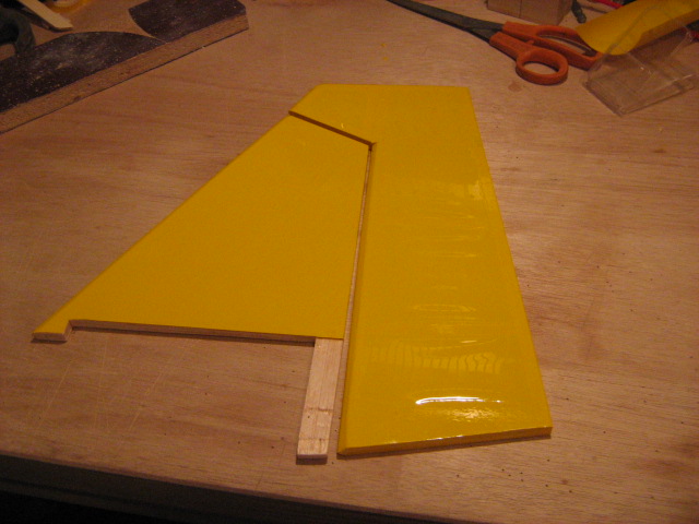

Started covering this weekend. I'm going to have to push hard to make it for this float fly on October 5th. [X(]

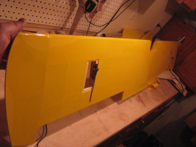

ID:	1028440   Click image for larger version
ID:	1028441   Click image for larger version
Old 09-08-2008 | 08:12 PM
  #60
RR24's Avatar
Joined: Dec 2006
Posts: 270
From: Liberal, KS
Default RE: Midwest Citabria - Build Thread
looks good, keep it up you will make it
Wes
Old 09-08-2008 | 11:50 PM
  #61
Joined: Jul 2006
Posts: 1,588
From: Ann Arbor, MI
Such great resourcefulness with an old Weedwacker engine. I just consider myself as lucky I was able to finish a standard kit! Keep up the good work, and yes, we are watching.
NorfolkSouthern
Old 10-05-2008 | 01:17 AM
  #62
Rcpilot's Avatar
My Feedback: (78)
Posts: 7,808
Received 9 Likes on 8 Posts

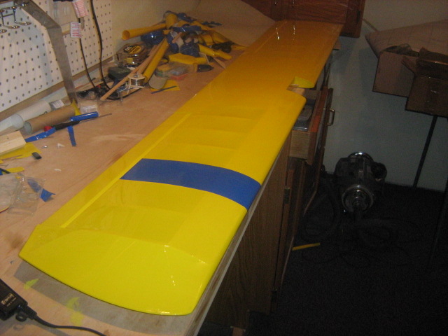

Sorry for the delay guys. I discovered the game of golf. I'm hooked. I get paid to go golfing during working hours. The rounds are paid for, the cart is paid for and I'm supposed to be sitting in my office working, but they let me go play golf occasionally. I bought some clubs and a 3-wheel pull cart. I live on a golf course, so it's been really easy to come home from work and walk 9 holes in the evening.

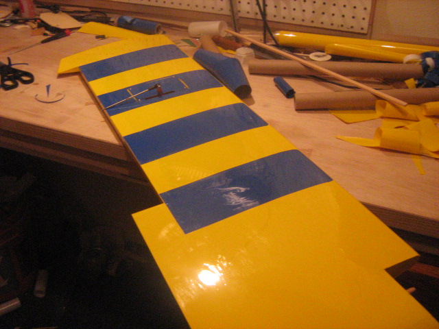

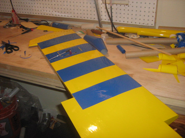

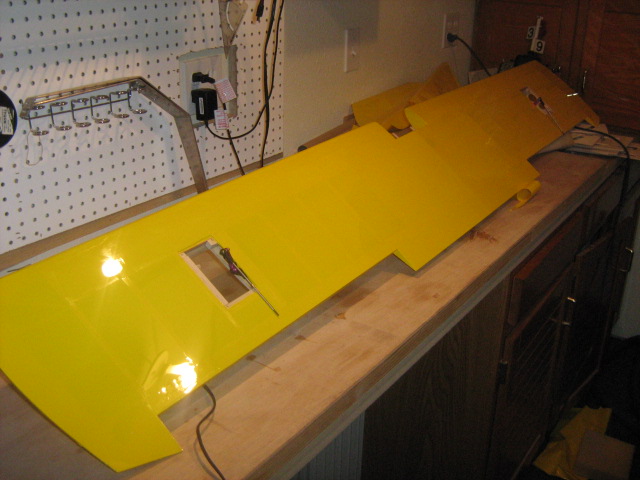

Here are some updated pics of the wing covering. Puttin for Bogie on the 18th hole.

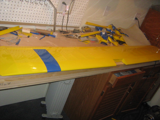

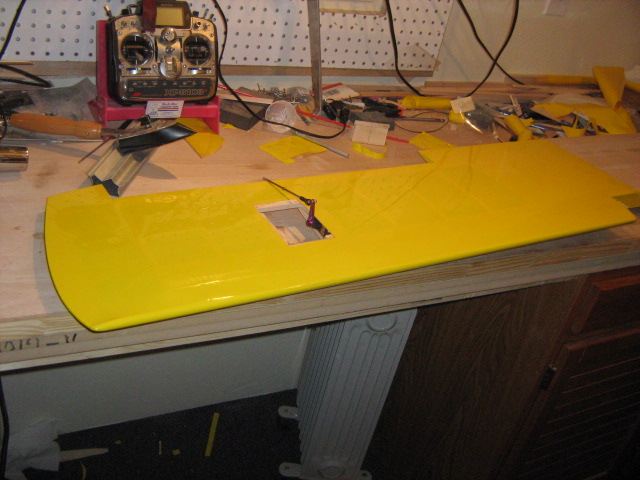

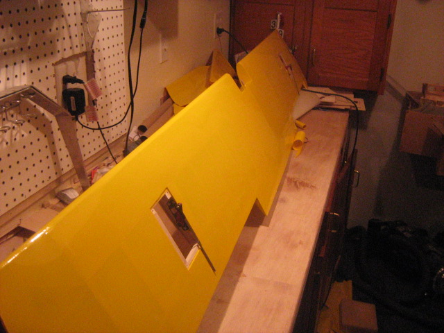

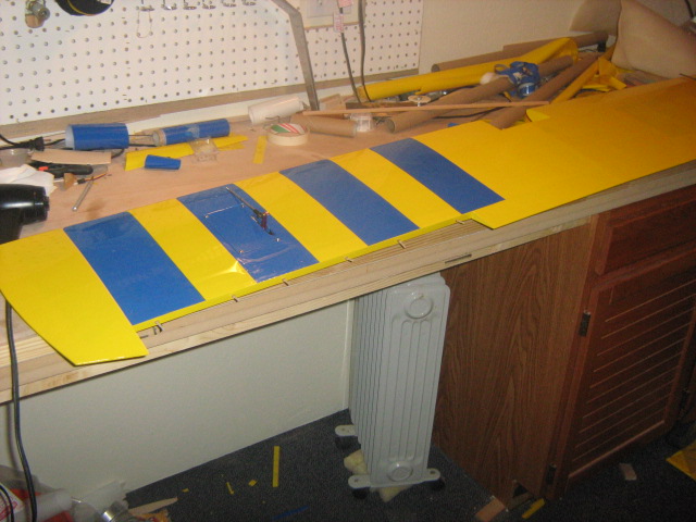

A bit more covering on the wing. We had a club float-fly today and I wasn't ready. That was the goal when I started this project. Oh well. There will be another float fly next spring.

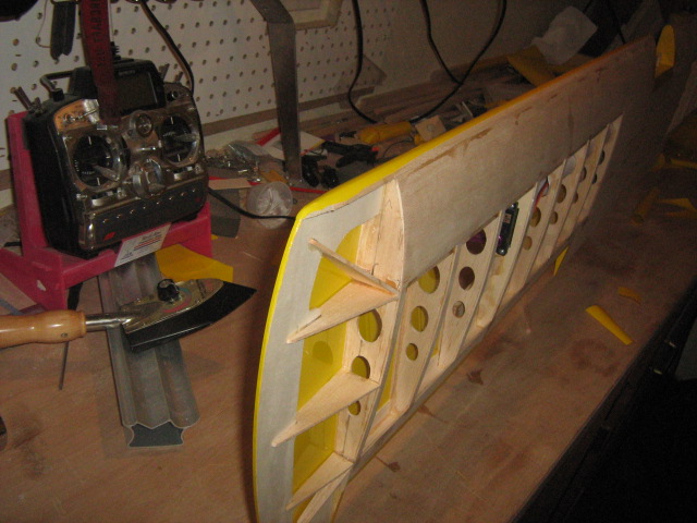

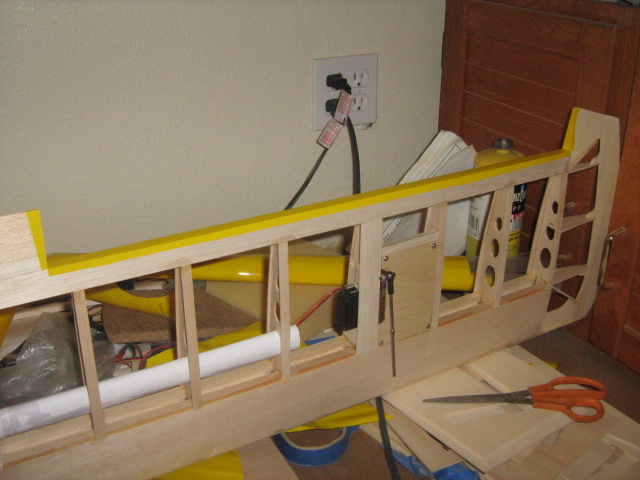

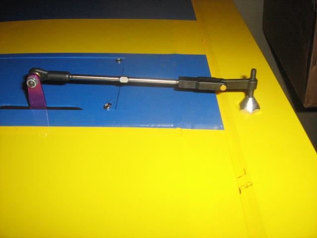

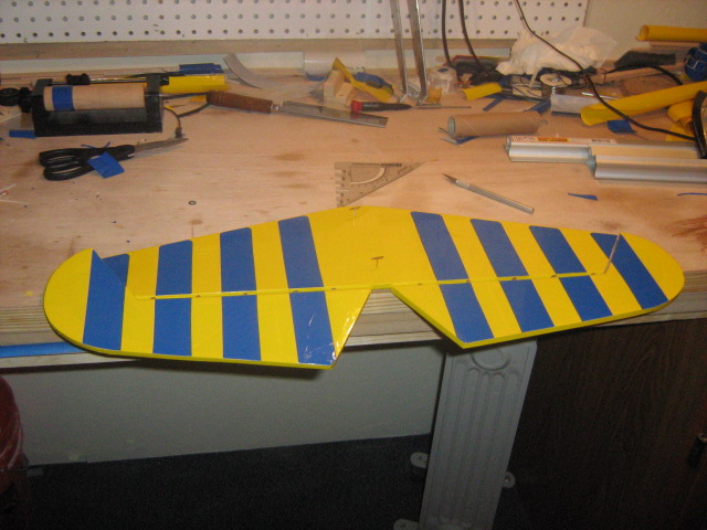

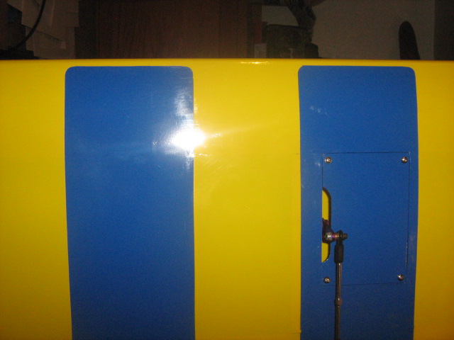

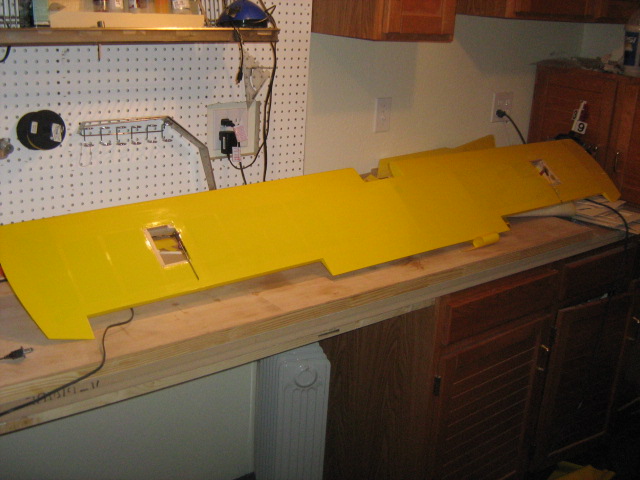

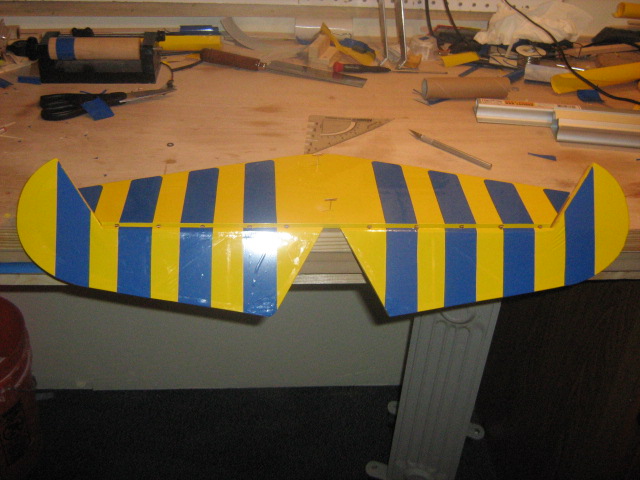

Covering and hinging control surfaces.

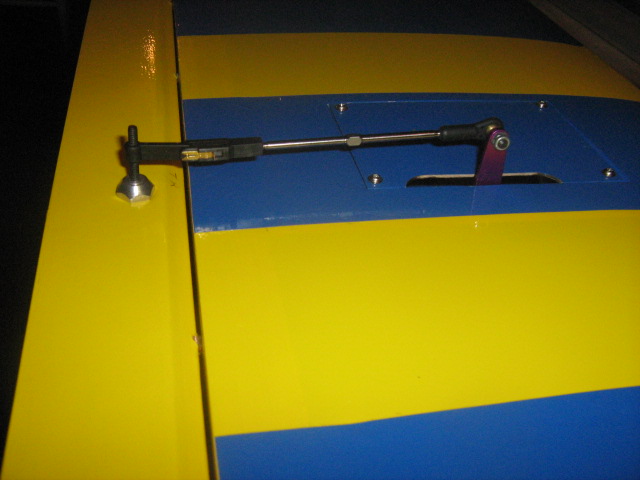

Got the aileron servos dialed in. I measured the servo arms beforehand. The JR4721 servos have a tiny screw in the top of the pot. If you remove the servo horn screw and put a tiny flathead screwdriver down the hole, there is a tiny screw that can be adjusted to re-center the pots. This keeps me from having to use sub-trims when I do the setup with the radio. I know it's a programmable radio and I know how to program it. [8D] I'd rather do it mechanically if there is a way.
Set the servos arms equal distances from the hinge line. Select the correct length H9 Pro-Links. Line up the controls horns and drill.
Turn the sound down if you don't like AeroSmith. I didn't realize my pocket camera had sound. [X(]
http://s198.photobucket.com/albums/a...rrent=1715.flv

I want to put a cockpit in this plane. I've never done a full cockpit before, but it's always something I've wanted to try. I'm not talking about a 100% scale cockpit here. I just want a reasonably scaleish cockpit that looks good at 5 feet.
Can anybody offer tips for where to get the right decals (1/5th or 1/6th scale Citabria or Decathlon)?
How do you make seats? I was thinking about using some foam and sanding it to shape. How do you glue or stitch leather to the seat backs?
I want to put in some tubing that looks structural. Mainly up in the windscreen area. There are a few X braces and some vertical uprights that can be seen through the front screen. What do you guys use for fake metal tubing? Gotte be round. Paint it the same color blue as on the wings and stabs?
How do you make a flight stick? Where on earth would you get a tiny rubber grip for the stick?
Other details you guys could provide would be great. I don't want to go crazy though.

Sorry for the delay guys. I'm gettin' there. [:-]
I decided to use Hitec 225BB on each elevator half and the Hitec HS77BB low profile for the rudder. Had to cut out the former in the middle of the cockpit and build a tray to hold these 3 servos. I'm using 2-56 pushrods and bracing them at every former.
I wanted to use one of the base loaded antenna to simulate the scale location. It was too tall and didn't look anywhere NEAR scale when mounted on top of the turtle deck. I mounted it on a balsa block and buried half of it inside the airframe. Looks "sorta" scale now.

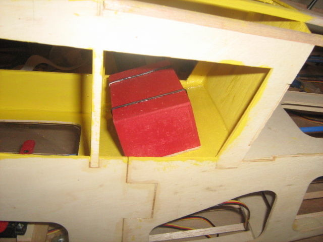

I want the push rods to look as clean as possible, so I mixed up some 5 minute epoxy and a TON of micro balloons. Spread it around the push rods where they exit and then cut them off and sand flat. Looks alright.
Last pic shows the area behind the passenger seat. I am planning to put my RX here. The base loaded antenna is directly behind this former.

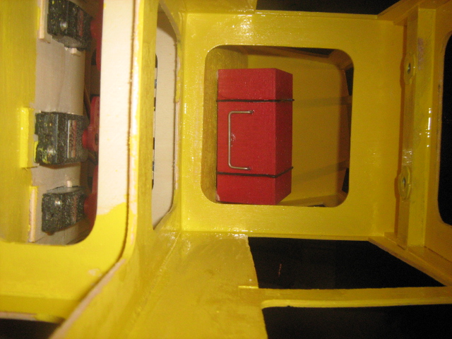

A few more shots of the pushrods.
The RX sitting kinda where I want it.
Made a suitcase out of balsa and used some of the insulation from the RX antenna lead that I cut off as bungee cords to secure it.
Started painting inside. I plan to use some blue plastic drinking straws inside to simulate the airframe tubing. Might have been a few pics of dry fitting the straws a post or two back?

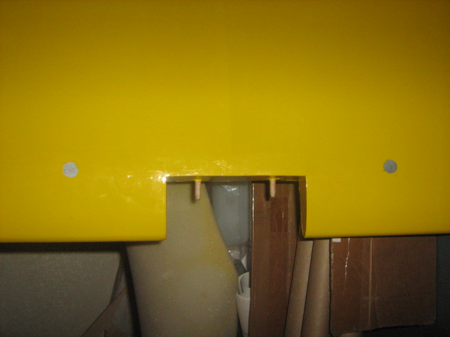

Finished painting inside the fuse.
Put a couple silver circles on top of the wings. Fuel tank caps.
