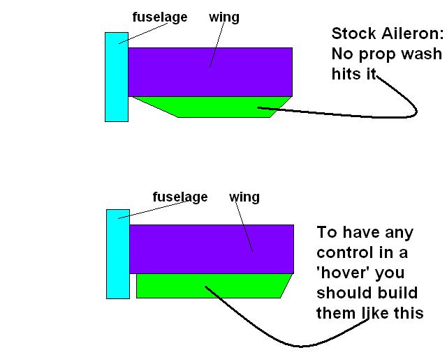

My Uproar 60 is powered with a ST G-90-its not overwhelming-don't see why the 1.20 would not work-except you may have a balance problem with heavier 4 stroke-you can always build a hatch back towards fin area and move battery to tail section. Not sure about ground clearance for larger prop for 1.20, check that aspect before you go too far. I used some old landing gear from another plane, so there is a way around GC also-mine uses a 13/7, a 14/6 might work, but it would be close as I fly off grass. Great plane and loads of fun-let us know what you decide.

#36

Yes giraffe gear is going to be the need with the prop, and yes, I've already drawn all over my plans to mod the ailerons. I was considering adding some tail weight to the verticle stabe or fuse in the rear during the build. Its going to need it....

I've long since finished my Uproar with the Magnum 1.20. Its AWESOME.. I call it my lazy plane. It just floats around. I put a 5 cell 6v, 2000mah batter all the way back in the tail, just in front of the tail servos. I also added the mods to the ailerons making them go all the way to the fuse. I increased the rudder size by 1 inch and added giraffe landing gear.
It flies great. I have an anoying problem with fuel leaking at my carb for some reason. Doesn't affect idle, transition, or full throttle, but still, fuel is leaking... gonna have to fix that.
I put the gear on with 1/4-20 nylon bolts in anticipation of a pancake at some point. I was right. The 1.20 gives me almost unlimited veriticle with a 16x4, true unlimited veriticl with a 16x6. I need to move the CG back tho. Not getting very good spins, or Walls, or Harriers.... very stable,... need to add more stupidity to the plane.. LOL..
OH.. and to heck with the stock throws. I put my low rates about 20% over recommended, and Maxed out the High rates. It reponds well....
