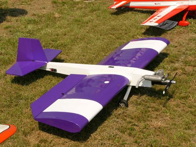

I built the Uproar and have an ASP 61 two stroke on it. It is a nice combination. I've seen them with various .75s and even a 1.20AX and it seems like a great plane no matter what you bolt up front. I recently broke the landing gear mount on mine, and twisted the gear up like a pretzel. My replacement gear is the Dubro plastic/glass unit. It's taller than the stock gear. If you go with a big engine it will add prop clearance.

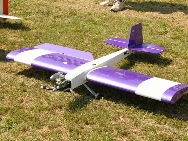

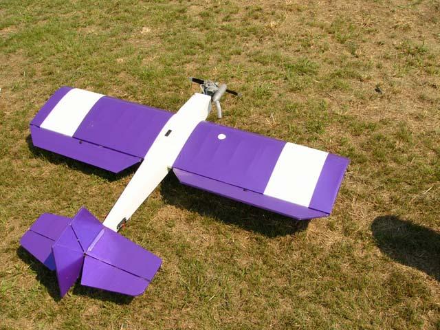

I'd leave the first one as is and make the second one as close to identical as possible. In my opinion the diagonals are small enough there is not a significant weight penalty compared to the balsa parts.
My uproar was my second kit as well. My first was a trainer. I managed to build a little twist into my fuselage. Fortunately, or possibly unfortunately, I'm not a good enough pilot to notice it once the plane was trimmed. I really do like flying this plane, and I hope you like yours just as much.

One thing I would do differently, and may still do, is put a brightly contrasting color on the end of each wing.
The plane has a very small profile when you look at it from the side.
I think it would help visibility to have a neon or flourescent color on the end of the wings.

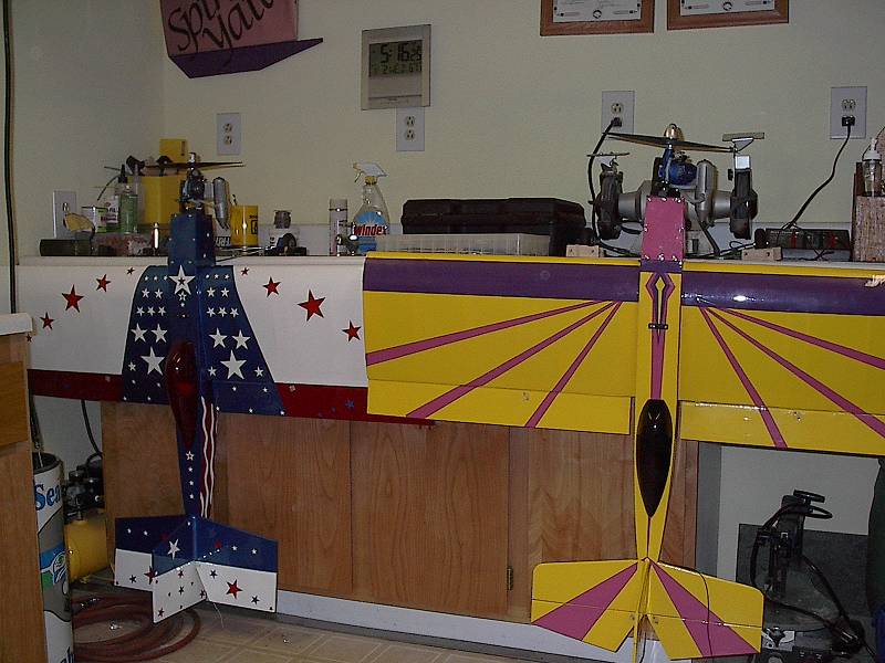

I have built so many Up-Roars that after the second kit I just started scratch building them, I like them so much. At the time the 60 wasn't put out yet but I have got to fly A couple of them, haven't built or assembled one though. Just A really fun plane to both build and fly. I was building them and giving them to friends. I found one photo of A couple of them from 01 or 02, two all ready to compete with and you can see the wing of one that got eaten by A tree. Great fun fly plane. Outstanding learning tool!!

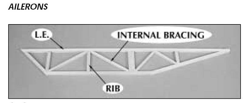

I ran into another problem.
While putting the wing together I noticed the root rib, R2, is slightly bent. I'm not sure how I did it but all the other ones are straight. It's right after the wing tube. I've already put on the TE stick and lower sheet.
Do you think I can use debonder to take the ribs off the TE and reglue them all? I guess if I'm careful I can cut them off and buy new balsa. I set it up on the root end and it is about a 1/4 raised at the TE. I'd take a pic and post but my camera cable is missing so I can't download.
Thanks for the help.

Old 10-02-2008 | 02:33 PM
carrellh's Avatar
Joined: Mar 2003
Posts: 6,544
From: Garland, TX
Default RE: Uproar 60
I would try the debonder and reglue.
