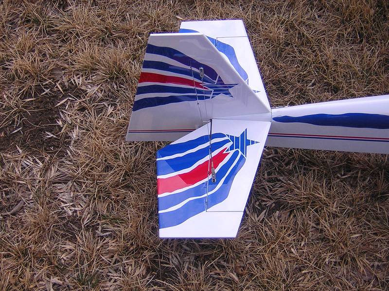

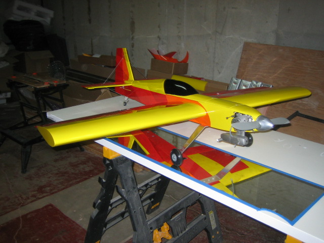

I inherited a partially built SSE. As I have a NIB SSE kit I am making mods to this plane and see how they work out before building my own.
Well, the elevator and rudder had been completed (so to speak). To add counters to both I simply cut the balsa off the tips of the horizontal stab and fin and added the pieces to the tips of the elevators and rudder. Simple enough. But wait ...
The laser cut balsa provided by SIG is incredibly light weight. With this wood added as unsupported counters I thought that they just might break off. Well, in the course of cutting hinge slots, filling imperfections and sanding the new "counters" have broken off several times. I can't imagine how they will survive typical minor hanger rash and the forces of flight.
So, the question to you hotshot builders that have successfully added counters (I've read your threads), how did you reinforce these things?
TIA for your unguarded comments

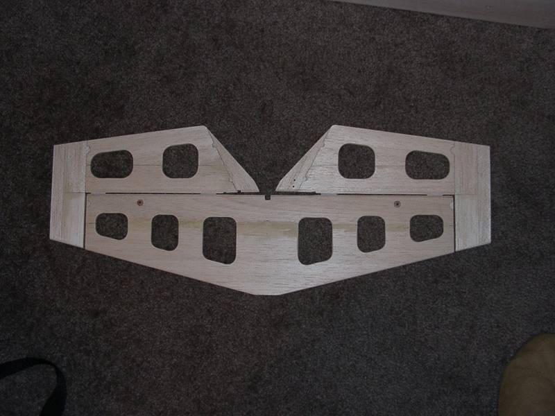

I built my counters, and cut my own lightening holes. The covering gives the strength you are looking for. I did not reinforce or pin my counters. This one pictured only has about 20 or 30 flights on it, but my other one has over 200, and they are holding up fine. I also added chord to both rudder and elevator.

DE - just to be clear, by adding chord you mean increasing the distance between the leading & trailing edge of the rudder & elevator?

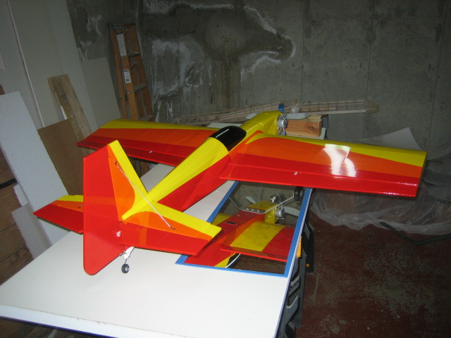

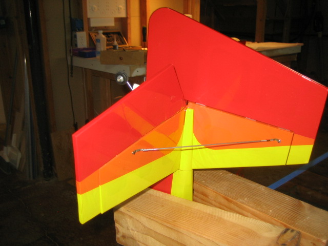

btw - this is what mine looks like - just wanted to make it really visible

That is what I mean. I think it was around 1/2 inch to an inch. Have you got a power plant picked out yet?
EDIT: Nevermind, I didn't see that you posted two in a row. Looks good, and should be easy to see!

DE - just noticed that it "appears" that the hinge line between the fin & rudder is not vertical. What is the advantage?

I'm not sure what you mean. My rudder hinge line is at 90 degrees to the thrust line. However, I did scoot the entire elevator/stab forward a bit for CG (too much trouble, wouldn't do it again), as you can see the hinge line for the rudder is forward of the elevator.
