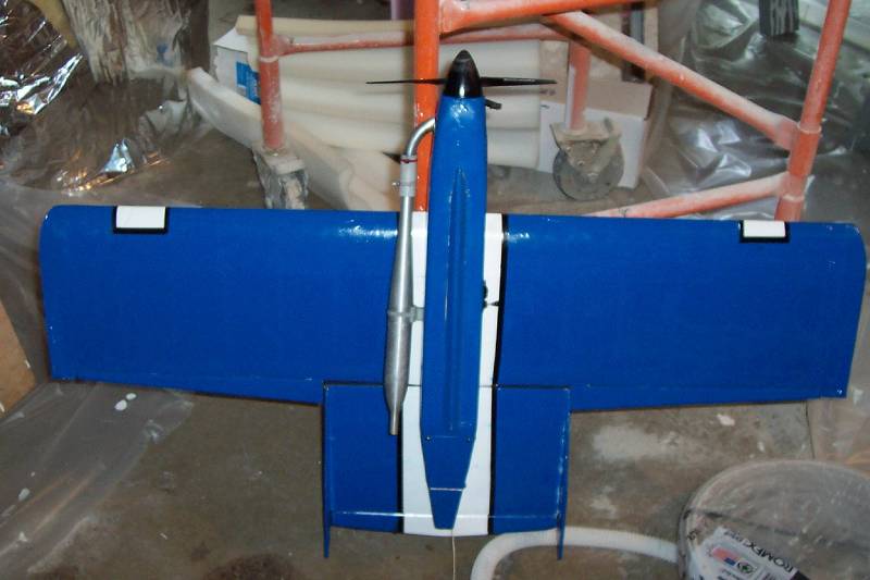

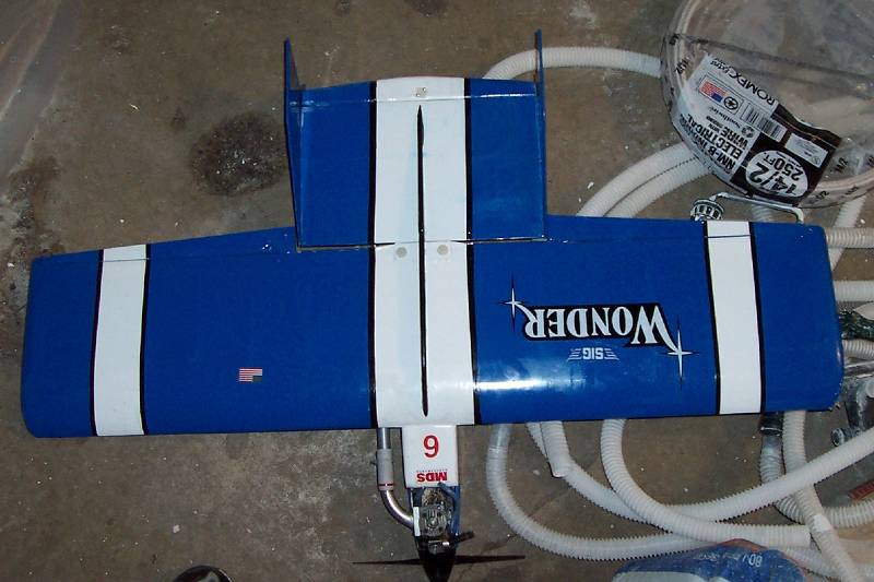

My Feedback: (197)
Joined: Oct 2003
Posts: 1,249
From: Minnetonka, MN
Default RE: SIG Wonder
Here is a picture of a Wonder that I built. I should have never sold it, and have another in the box and plan to build it when I get a chance. It was quite fast with the MDS 18 and tuned pipe. It flew with an 8x4 prop. I am not sure what to use for a motor on this one. I am considering an electric brushless setup and the Magnum 30 four stroke. I noticed Magnum is also coming out with a redesigned 15 and may go with that. I have flown another wonder with the norvel 15 and that motor was a nice runner. I may also put a piece of music wire on the bottom skid to help with landing on the ice in the winter.

Old 06-29-2006 | 10:11 PM
Tom Nied's Avatar
Posts: 2,233
Received 22 Likes on 21 Posts
From: Queen Creek, Arizona
That's cool mnrcaerobat, thanks for sharing that with me. It seems there is many ways to build, modify, power a Wonder. I'm going to power mine with a TT GP.15, should be plenty for me. Some like to really overpower and just see how much motor they can put on. What ever turns you on, and whatever you have on hand. Took me an hour to do the primary wing construction up to the sheeting of the leading edge and trailing edge. Going together just fine and I'm enjoying the build, more that I thought I would. Really getting into this little plane. Should be a blast. Thanks Brian.

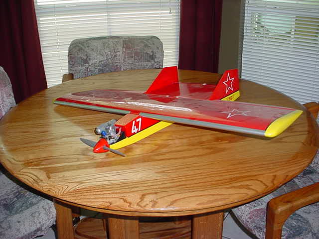

Old 12-27-2015 | 11:28 AM
Tom Nied's Avatar
Posts: 2,233
Darn it, here's another project I didn't finish. It's built right up to final completion. Forlornly sitting on a shelf. I know one thing that bothered me when I last worked on it were the wing tips. I decided to just glue blocks on and carve to form a fairly regular wingtip, instead of the awesomely cool Hoerner style. My thought was that they would be prone to breakage. So now I've got these solid balsa wingtips that I wish I had hollowed out. Maybe I shouldn't worry about them and just plunge forward. I should at least bring all the pieces together.
Old 12-27-2015 | 12:40 PM
Joined: Jun 2005
Posts: 1,145
From: Houston, TX
Don't worry about it Tom. I've got solid blocks on mine and it's an absolute riot to fly.
