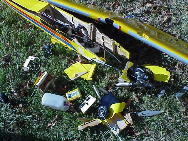

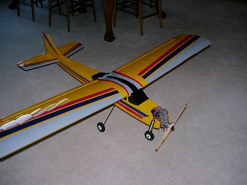

The photos are from the start, my Explorer 40, the inspration to build, and the result. I liked the result so well that when I lost it (in the creek bed for over 4 months), I built a clone using a backup explorer wing I had. I put that one into a deer fench beihind our field and killed the wing. I had built and was flying a 4*60 by this time and I scalled down the 4*60 wing and put it on the fuselage. That was a great change, It flew even better.
Don
Don
