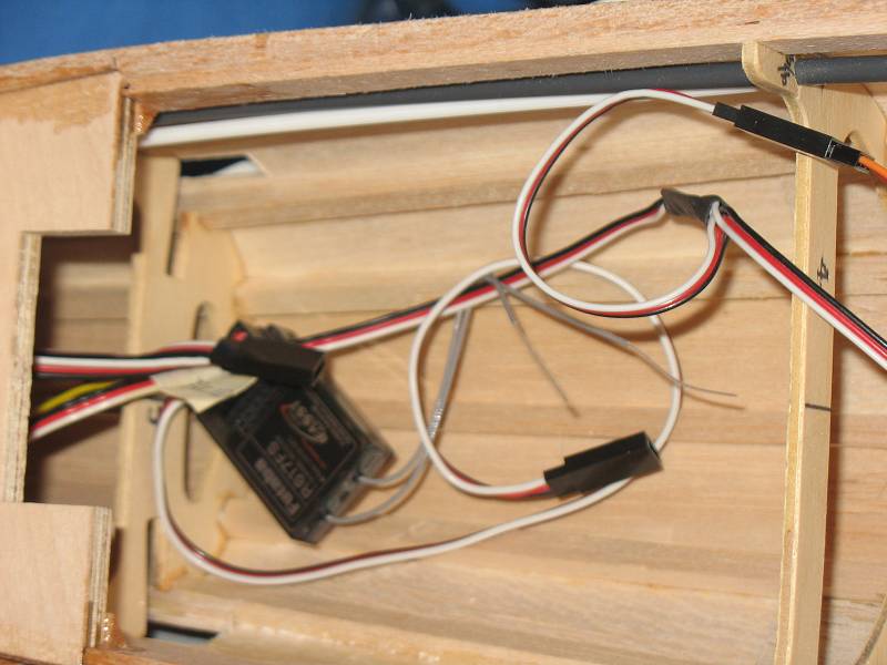

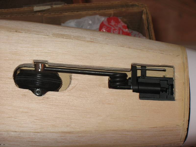

Default RE: Learjet .40 Build
Here are a few pics of the progress. I have installed the retracts, some of the radio gear for testing, and have the wing mounted. I will get to work on it more today, my plans for today are to install the fin and stab, finish sanding the fuse, link up the main gear to the servo, and hopefully start covering the fuse if I work hard.

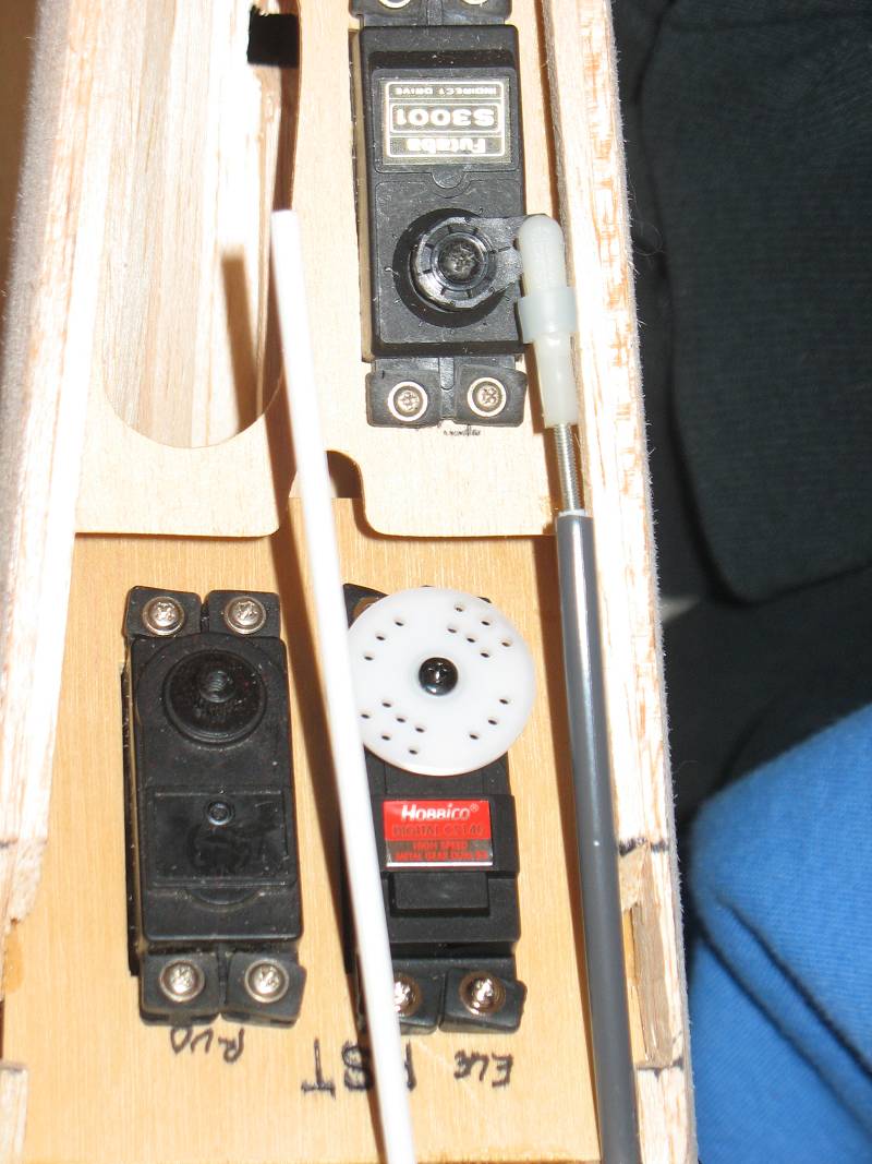

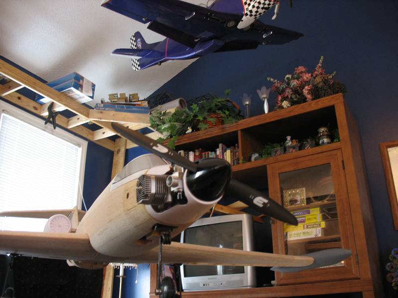

OK, I am back on track after the mishap. I have the cowl blocks mounted, firewall and fuel tank compartment fuelproofed, tail installed and hinged ( I went with Robart #307 hinges for all control surfaces). I still need to build wheel wells in the wing, install the belly pan, and some wing sanding. After these things are completed I will start covering.

Great work as always.
I just hope i get mine ready to cover by the time the weather is warm again.
I've been side-tracked by the uproar. I got rid of a lot of extra covering I have laying around the last two weeks working on it. I've also been doing a lot more full scale flying so that has resulted in a lot less build time.
Tomorrow, I have nothing planned, I'll get back to work on the Learjet then.

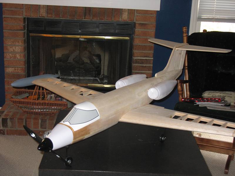

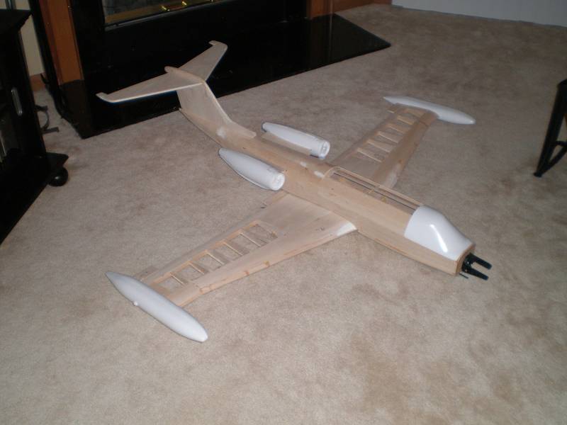

I fiberglassed the wing joint last night. It didnt come out as nicely as I would like but oh well, its not going to be seen when the wing fairing is put on anyway, its strong and thats what matters.
I started cutting out the plastic engine nacelles and tip tanks and couldnt help but tape them in place and take a picture to see what how it looks with them in place.
Im suprised that the only thing that holds the flimsy plastic engine nacelles on is a little epoxy on the inner half of the engine nacelle and one tiny screw on the outside half. Seems like the weakest parts on an otherwise very stout design.
Don't worry about the epoxy joint on the plastic engine nacelles, if you epoxy them from both inner sides, at the entrance of the slot and other end, it will be very strong hold. Plus you can add bit more epoxy on the outside of the pylon slot and fill it with filler to make proper fairing as i did to mine. No need to add screw for outer side!, it will look ugly...

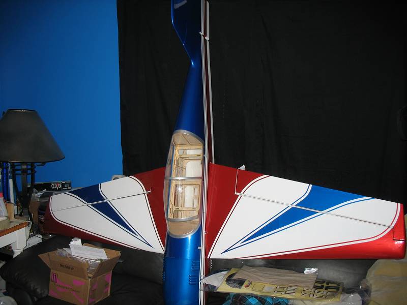

A few update pics, I also have little time to build. We need to win the lotto so we can build our planes.
