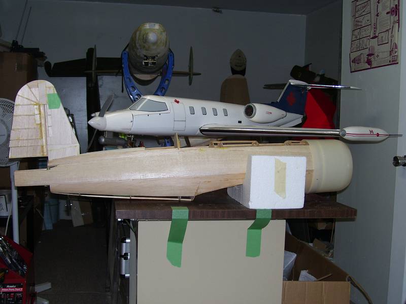

I'm about five hours into the build and the vertical stab is built. I am starting the wing and horizontal stab tomorrow. I am working on the wing in the garage and the tail in the house. When I get frustrated with one part, or am putting off a part of the build I dislike I can go work on the other for a while.

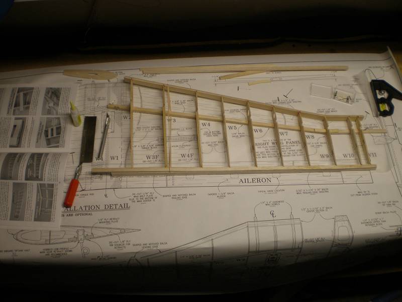

Began framing the right wing panel today. Took about 4 hours to get the plans laid out and get this much of the wing framed. Im going out of town for the next 3 days so I wont get any more work started until this weekend. That will give me time to get some new epoxy. This kit shows what a jump in technology laser cut kits were. This is my first die cut kit build and it sure is more work.

Looking good so far, i had a pleasure of making one of these Learjets when they first came out about 13 years ago!, form what i remember it was pretty good and straight forward build. I ended up scaling it more then i should have as model become heavier then should have but then back then it was one of my first kits put together and i liked it so much that i used to go to airport to take pictures of real Learjet 35A and come home to replicate on my model!. It was fun doing it. Once i finished my model i took it to Beauty contests held at our annual hobby show here in Toronto, i did good once and came out with bunch of prizes with it. That particular learjet hasn't flown as yet, i was chickened out back then, though it suffered some hanger rash over all these years but i still have it on me. Then i recently got another Learjet from a friend and wanted to fly it but things happened with it also and before i could fly her it crashed in someone else hands!, so waiting for rebuild through this winter season.
Keep it up, you will enjoy it very much, they are nice planes to have and to fly also but tend to stick longer on ground before rotating for take offs...

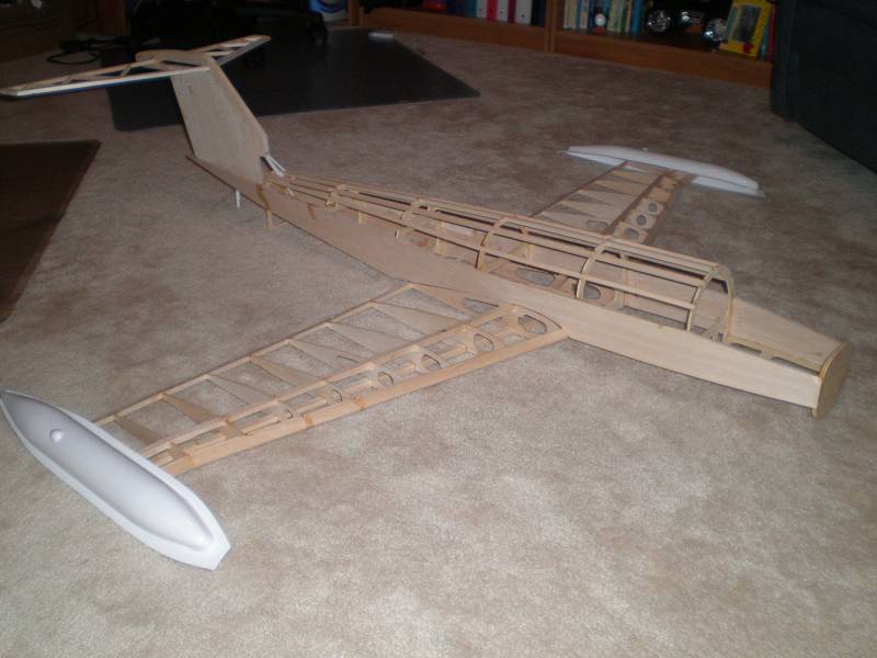

Here it is so far. 25 man hours into it. All the basic structure is there but barely. Lots of work to go but I feel a milestone has been passed. I'm going for a .46 TT pro but I think a .55 is the way to go if you are doing retracts and other scale features. It is a pretty good size airplane so I'm wondering if I will have enough power but I'm going to stick with the .46 and see how it flies.
Go with any 50sz 2 stoke engine on this Learjet, one of the key reasons why my second one crashed was it has OS46SF on it!, not a good engine choice for this model or even 46FX in my opinion specially flying off the grass. I will take pictures of my first the original one tomorrow and post them in here..
Pat,
I wouldn't go more then flaps on it!, spoilers with weight of additional extra servos will make it heavy model, it is already heavy on wing loading!....I over killed my model just to make it into more scale type then it is...if you want to fly it then keep it light if you can..
