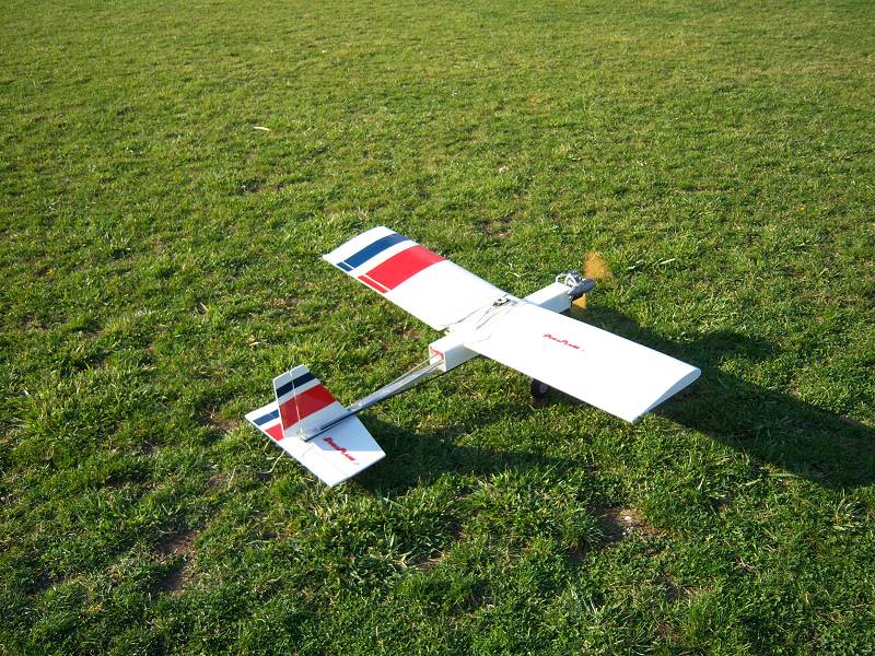

Old 11-09-2008 | 08:29 PM
flybug's Avatar
Joined: Dec 2005
Posts: 580
From: Columbia, MD
Default RE: CG Question
ORIGINAL: Huntster
3. The purpose of checking for CG is not to control the way it stands on the ground... It's for how it will FLY.
Remember it's a PLANE not a CAR.... balance it to the WING and it will fly great... If you balance it to the wheels then in this case it will be REAL nose heavy and you'll have your hands full!!!
Good luck and let us know how you do! Keep sharing your info....
Well took this bad boy to the field today anyways, once there the guys looked at it and did the fingers balancing, the machine balancing and we all agreed with Huntster, if it balances on the spot it will fly well regardless of how it looks on the ground. So I hooked it up to the fuel pump and it just up righted it self; so I decided to maiden this bird today. I tell yah it flew like a champ, it is not a first timer trainer in my opinion but it sure is a blast of fun to fly and handles the winds very well. Mission accomplished [sm=thumbs_up.gif][sm=lol.gif]
Thank you all for your priceless input and advise/transfer of knowledge.
