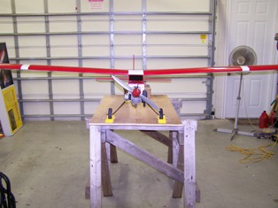

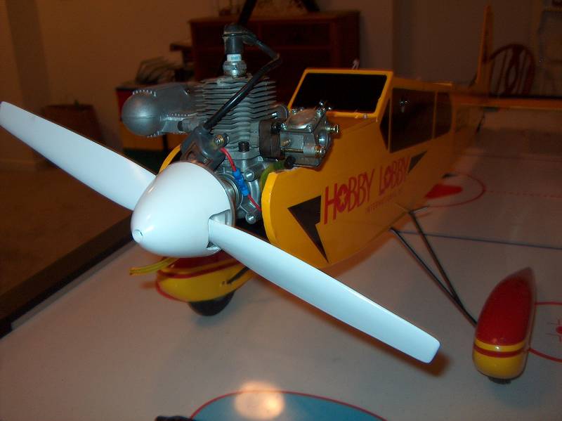

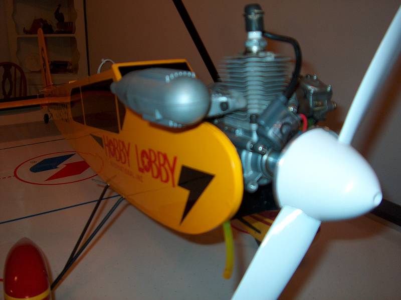

I cut the mounting rails off, doubled the firewall on the front side and notched one cheek. I modified an ASP muffler to fit the G-23 as well. Here's some pics.

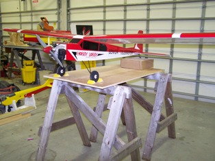

Here are pics of a Senior Telemaster ARF I built for a friend. Cut the cheeks and motor mount off of the firewall and mounted a Zenoah 20 directly to the firewall. I did reinforced the firewall to handle the extra weight. Ended up with 6 oz of lead in the tail to balance out the extra weight up front. Also, changed the wing to a bolt on affair.
It flies fantastic at 1/4 throttle and occasionally use 1/2 for loops. The plane is being used as a trainer for the 13 yr old son. He loves the plane.
I'm getting ready to build another with the exact same set up for another friend.
