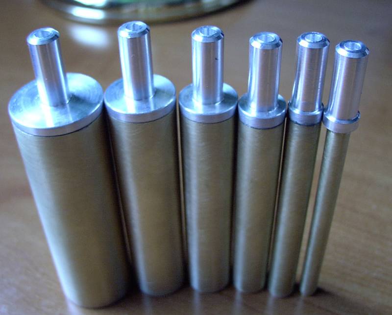

it is quite simple to make a set youself, I did using thin wall stainless tubing, in both square and round. I used 6" lengths of the various sizes and used a cinical grinding bit on adrill to sharpen them, I found metal caps to go over the ends where I use a small wooden mallet if needed, they work well in balsa and liteply. I make a new one if I need a different size, and have most sizes in round up to 1 1/4", and square up to 3/4". very useful, and easy to sharpen if needed. One point to remember is to sharpen from the inside, That way youget clean straight sided holes that should fit snugly. I even made the mallet myself using a small piece of 2" wooden cutain rod and 3/4" dowel

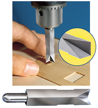

I think qldViking has it. I do remember a wierd woodworking tool with a round bit that runs through the center of a square cutter with sharpened end like Viking suggested but I can't remember where I saw them. They would certainly be more expensive than viking's idea. I have a set of "cork borers" used in scientific labs for, what else, boreing holes in cork stoppers. Very handy too for punching holes in balsa, thin plywood etc. You can make your own out of brass or stainless tubing.

I've seen responses about a drill in a square tube, these are mortise tools for wood working and they basicly broach a square hole and the drill removes most of the material in the process. They would not be very sucessful working with balsa as the wood is so soft the it will crush before the square part can cut it. Even it it is able to cut it, the distortion would be great.

The cutters I make are from thin wall tubing, with the edge on the outside. these give a good clean cut usually best with a gentle tap from my little mallet.

for cutting of balsa and some lite ply I havent needed to reinforce any of my cutters. I had a solid block of pine I use to punch on, always use my little mallet, and also keep my punches sharp. I use them a lot on wing ribs, for wing tube holes, servo lead holes and lightening holes. I also make small blocks with a suitable hole to carry any leads down to the tail if needed, usually out of 3/32" balsa, I used to have a stock of very light rectangular plastic tubing which was great for running leads through, I am scratching my head as to where I got it from originally. It is 3/4" x 1/2 " and very thin walled and kept the leads nicely in place and made it very easy to replace or add wiring if needed.

I have a set of these Gaskin Softbore Cutter and they work great on balsa no ripping at all.
http://www.rjrcooltools.com/shop_ite...m?subcat_ID=29
F0r 90 degree cuts I want to try these corner cutters from Micro-Mark have not purchased them yet but they look interesting.

Could you post a few pictures of the tools you've made - that's an interesting idea and I messed around making a punch last night while watching Mad Max - a cult film from downunder.

Don, go to A gun show and you will usually find some very good engravers still doing it the old way. I make my cutters from copper or brass and I can get the smaller sizes at most hobby shops. For the bigger stuff I find it at hardware stores. My son owns A scrap metal company so when I visit him I can go to his yard and look around for stuff. With the softer metals you can also shape your cutters. I used to have hole cutters for making gaskets and another set for leather tooling. You may be able to still find punch kits at Tandy Leather??
