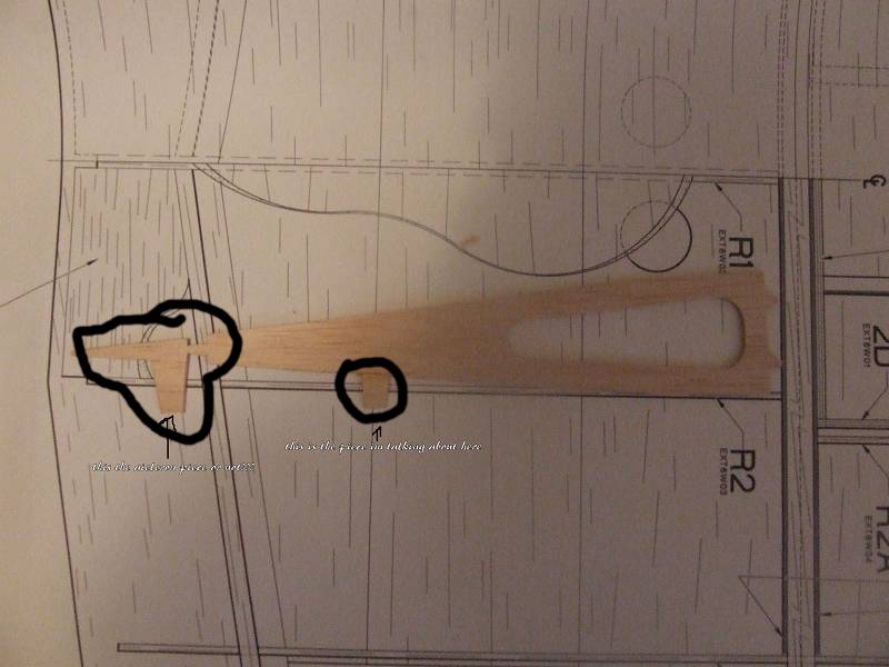

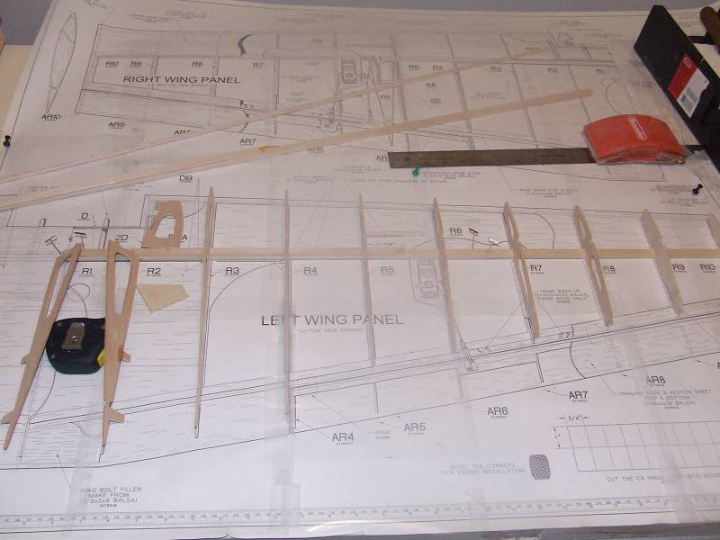

My first actuall scratch build(from rib assembly to completion) i've decided to go with the Extra 300S 60 series. There are a couple modifications I have decided to do which I seen on other build threads. The first mod I have done was extend the elevators by 1/2" and the rudder an 1" on the bottom up to 1/2" on the top. I have added some counterbalances but need some input on a few correct methods of some procedures of the build itself.
1. When gluing (CA thin I plan to use) do I tack everything down first then put drops into the connecting joints or add a drop to the butt ends of the pieces, then tack it all together with the t-pins? Right now I have the stab and elevators all cut to size and T-pinned in place on the plan to make sure all my joints fit properly and all cuts are correct.
2. I have noticed on the ribs of the wings there is a little piece near the trailing edge which doesn't seem to be a part of the wing itself. I see from other threads these ribs are sitting on this wood piece which seems to keep it aligned at the TE. I will post some pics later on tonight. Is this piece of wood just for spacing and is cut off later in the build or how does it fit in with the construciton of the wing? I'll try to explain this a little better. When looking at it from the side, about 3/4 of the way down from the LE(leading edge) there is a protrusion extending from a little cut box into the rib near the TE. It's this piece which is confusing me. Also, at the end of the rib it seems to extend into a point and is like a Z cut from the rib. Is this piece for the aeileron or is the cut a guide for a stringer?

Yes, put the wood together over the plans first, then add the thin CA. After the whole thing is together, say the fin or rudder, and you take it off the plans I like to add a small fillet of thick glue to most joints if the part is not going to be sheeted.
The tabs on the ribs are built in jigs that keep the ribs in their proper position when building. I think on that kit they're not used to build washout (on-purpose twist) into the wing, there's another jig for that later on in the build. The ones on the back are the ailerons.

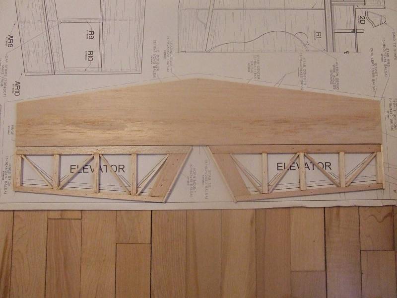

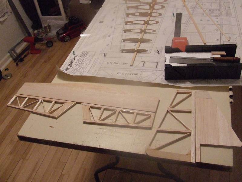

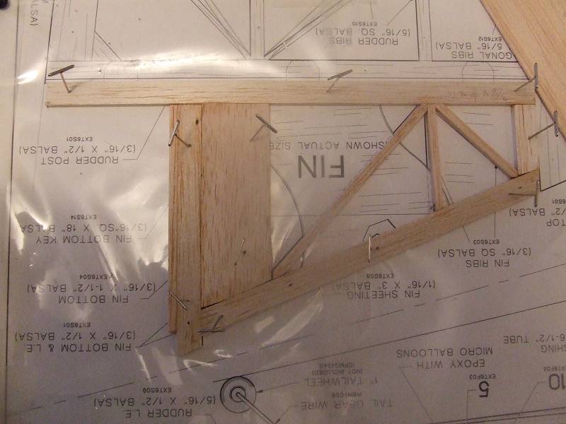

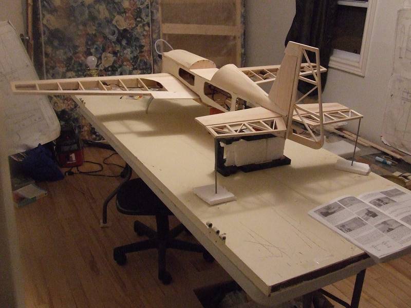

Here is my finished rudder, stab, fin, and elevators
Started the build on my wings, no mods here that I can think of may extend the ailerons once I get to that part of the build. Thinking I might just go to prefabed aileron pieces instead of making them like the kit informs.

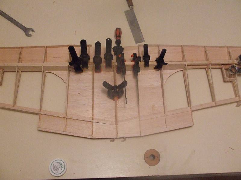

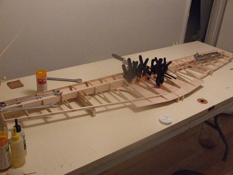

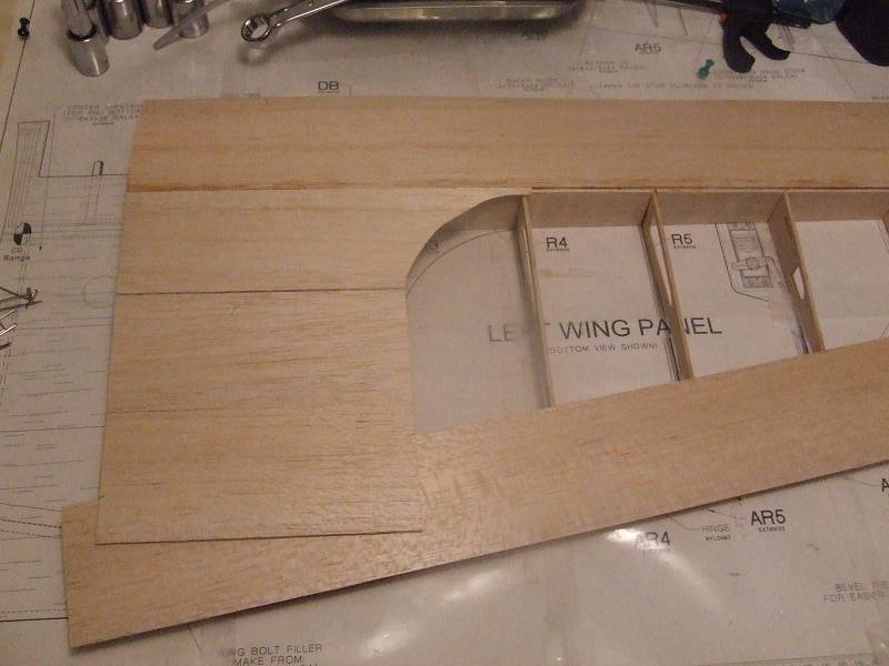

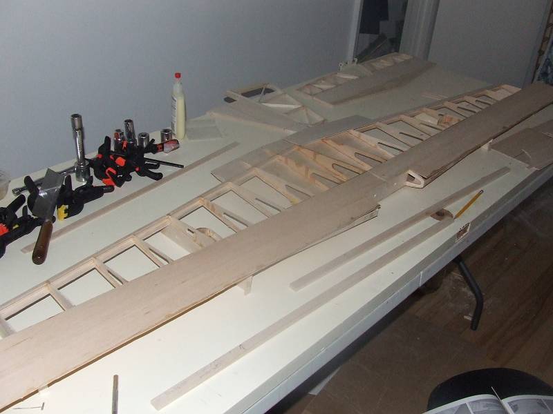

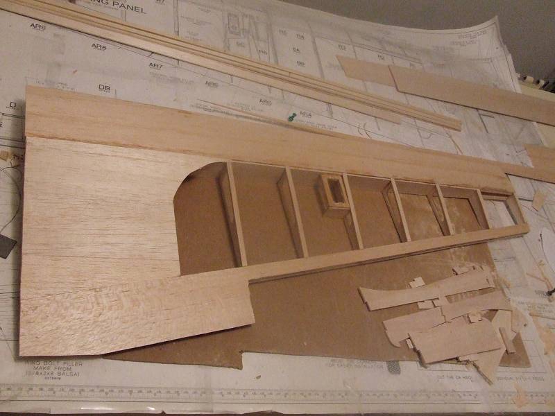

Did the Wing sheeting and started my right wing today, hopefully I will get it done by end day.

Old 12-22-2008 | 10:18 PM
Joined: Jan 2008
Posts: 62
From: ALBERTA, AB, CANADA
Default RE: GP Extra 300S 60size Build
Got to my objective today and put the wings together, now just gluing the dehithral brace to joint both wing halves
Tommorrow will start the remainder of the wing build, can't wait to get to the fuselage.

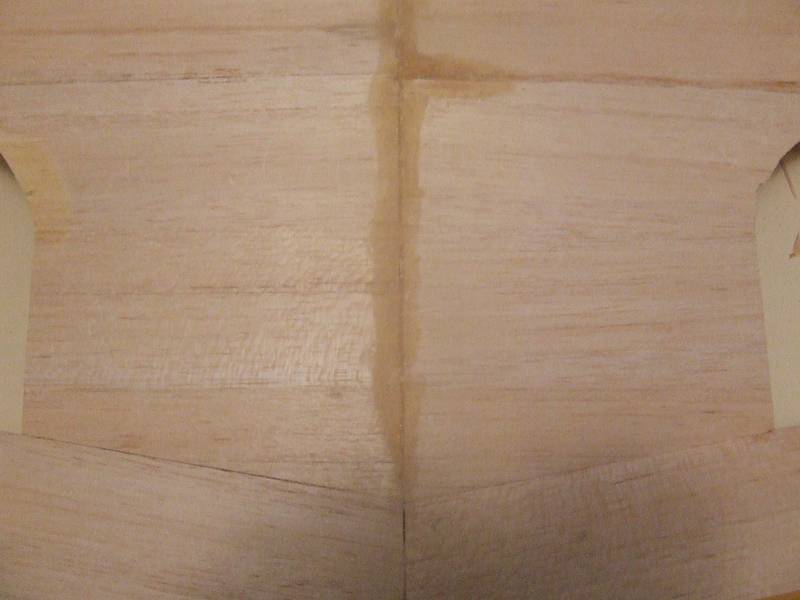

Update: wing is complete now all sanded and ready to monokote. Instead of using balsafill I used a little epoxy glue instead to cover all the minor imperfections and it turned out great. Started on my fuselage - I reinforced the joints on formers 6 and 7 especially where they bend for a better hold and a stronger side.

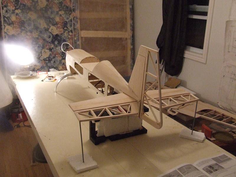

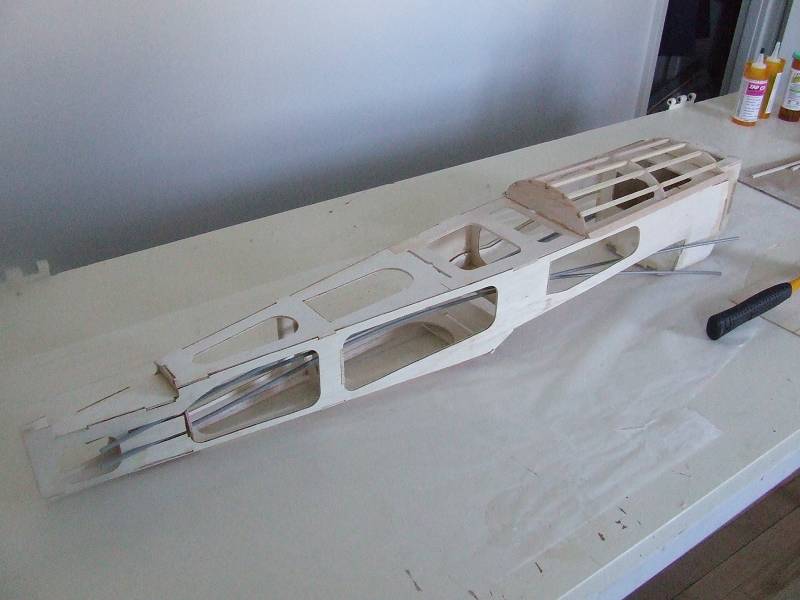

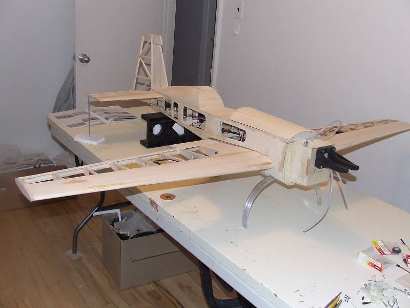

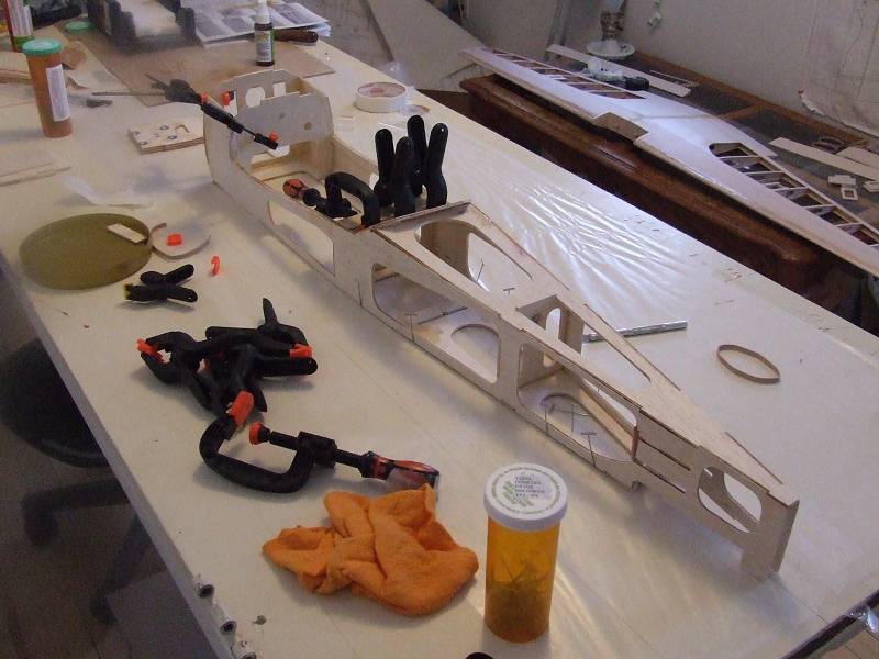

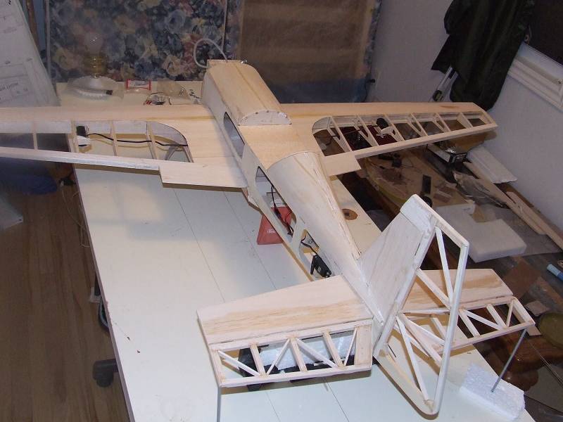

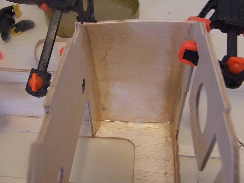

Here's an update what I accomplished so far. Modified the fuselage to accommodate two servo's in the tail end to operate the elevators. Patched the cockpit so I can put my pilot in there. Finished the construction primarily now just some touch ups, minor dent repairs and a few more mods to hold the battery in place and receiver.
Still have the tail wheel assembly to put together and all the hardware marking and drilling. Using one long pushrod for the rudder operation, thus minimizing my weight. Might not be to much of a weight reduction but it should help.
Here are some pics of the project so far

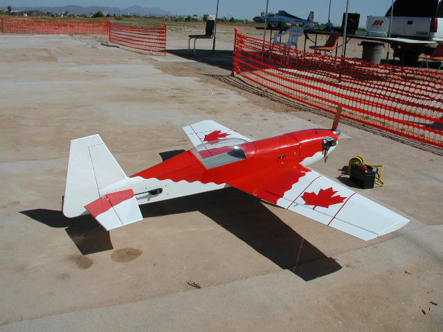

I built, and still have, the GP .60 size extra. A fun build...
Great to see you took the plunge and built an airplane from a box of wood. I am one of the few at my field that fly nothing but kit airplanes. You will find people will be attracted to your plane because they have never seen anything like it. Quite a feeling of accomplishment when all is done and she takes to the sky for the first time.
You may want to upgrade your cowl to a fiberglass one from Stans Fibertech. I did and it was well worth it. A flying buddy of mine has the ABS one and it is cracking, as ABS does.
http://www.stansfibertech.com/
Another alternative is Fiberglass Specialties Inc. I have a cowl and wheel pants from them and they are good quality.
http://www.fiberglassspecialtiesinc.com
Here is mine, OS 1.20 Surpass III Powered.

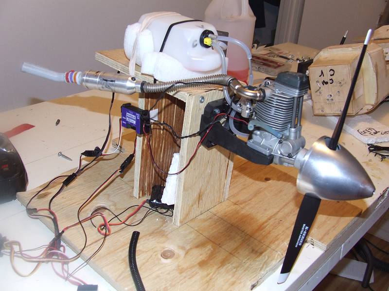

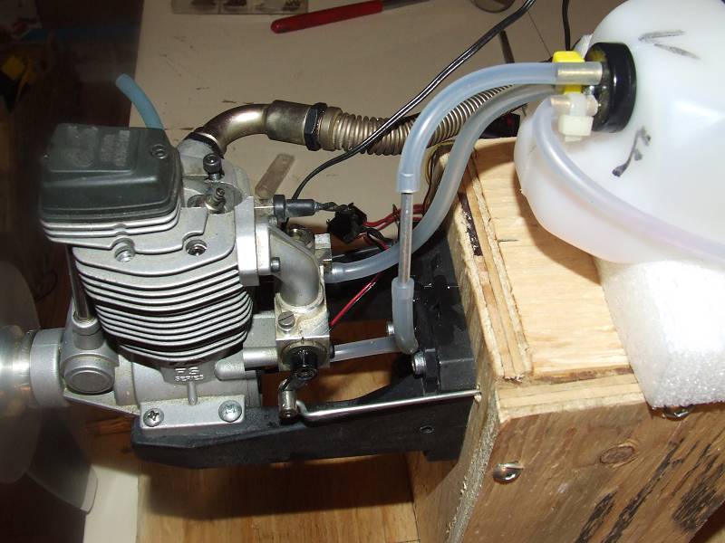

I finally got my engine. Picked up the FS 91S II - FI (fuel injection) model, needs a few items before I can get it running properly but tested and it at least starts then stalls out on me(never put my check valve on or my fuel filter so I guess that's a given that the engine won't run without the tank properly pressurized from the check valve.)
Here are some pics of my test buildup and my engine. Tomorrow will pickup the checkvalve and fuel filter so I can test this baby out. Nice engine, to bad they discontinued it and can't find much info on this engine online either. Did find the manual which is a bonus, glad I found that.
Sanding of plane is all complete, all sanded down to 2000grit wet/dry sandpaper (i used).
QUESTION REGARDING COVERING
Any tips I should know regarding multiple covering. Read that I should start at the trailing edge and work my way up to the leading edge, don't heat shrink until both sides are tacked and mainly done or warping may occur. ultracote over ultracote and monokote over ultracote, or ultracote over monokote???
What method would work the best?
LHS informed me I don't need any adhesive to apply any covering just heat gun and iron will do the job.

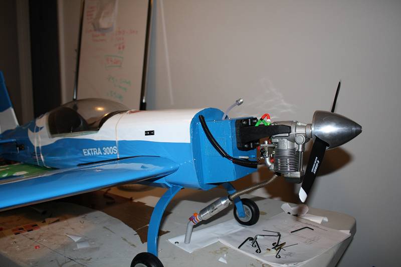

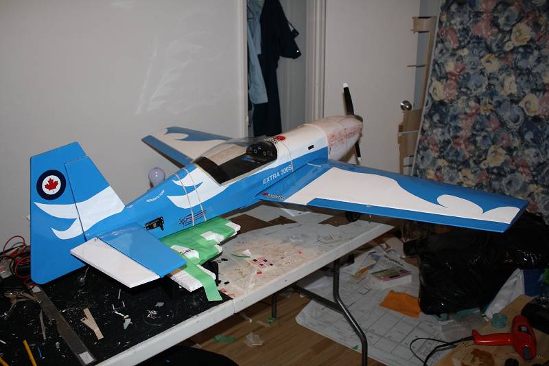

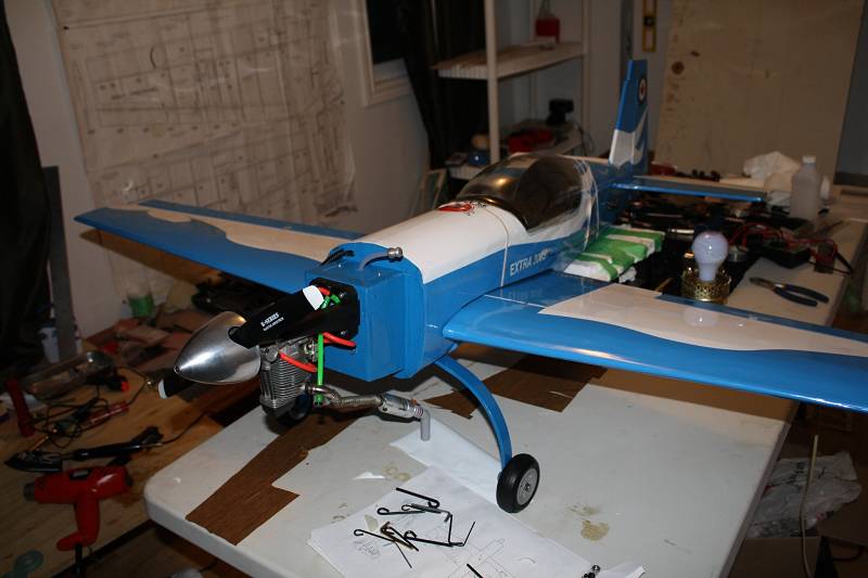

Here are a few pics of my plane covered so far. Haven't glued on the canopy yet though its coming along pretty good for my first build.
I'll be buying the fiberglass cowl instead of the plastic one which came with the kit, just wanted to get a feel of how it looked with the cowl on
pics seem to be a little big, one's on my profile (top view type)
