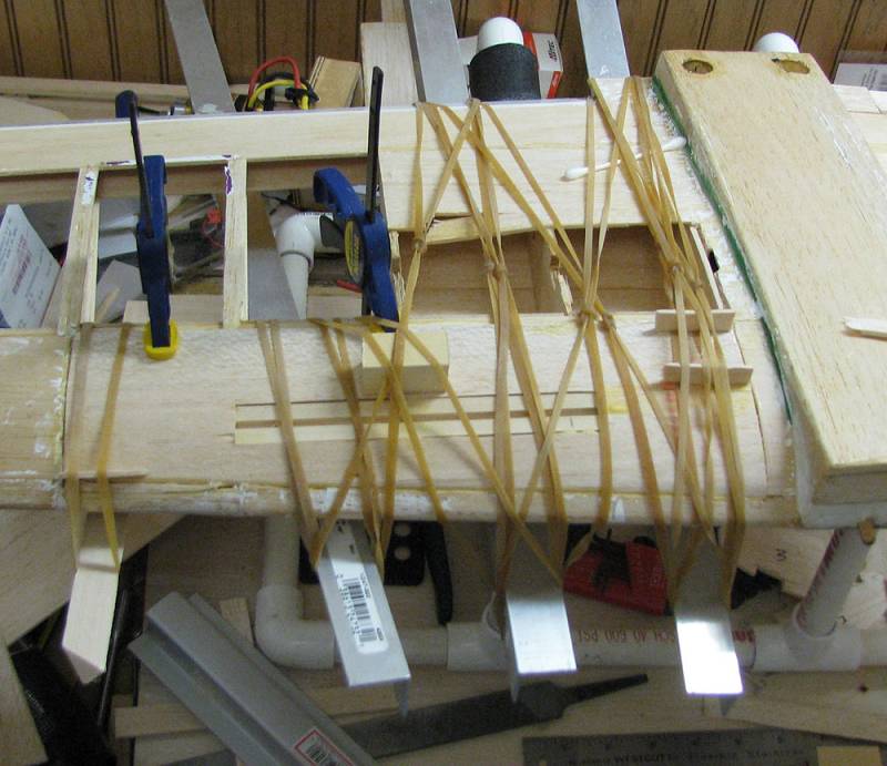

I'm thinking a person could also use a rubber band and flat stock scrap to hold the aileron in place.
Place flat stock scrap under wing, stretch rubber band around flat stock at front of wing, go over wing, and back under flat stock aft of wing. It'll hold the aileron in place.
I used this technique quite a bit on my Ultra Sport rebuild.</p>

Hey vmsdude (just kidding) - I don't have that many rubber bands. [:@]  I have a bunch of composite building shims that I use to clamp the top and bottom surfaces. They are long enough to span the combined chord of the stab and the elevator.

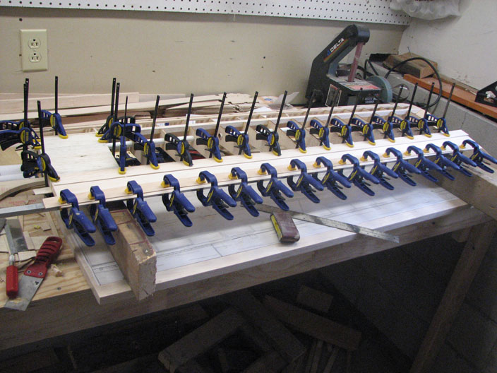

One can never have too many rubber bands....
Or too many clamps....
