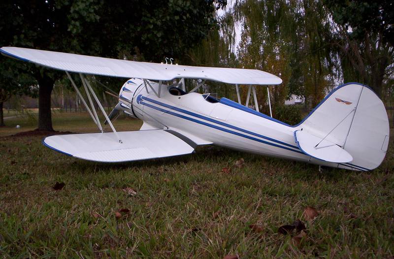

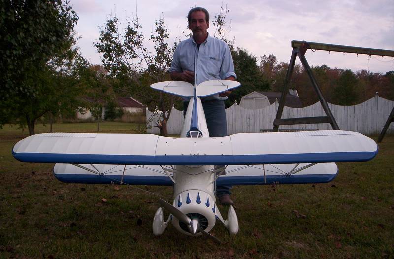

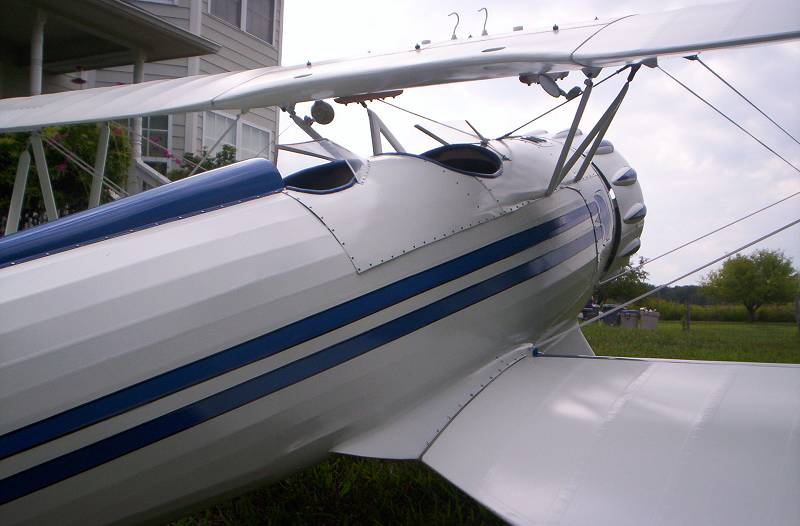

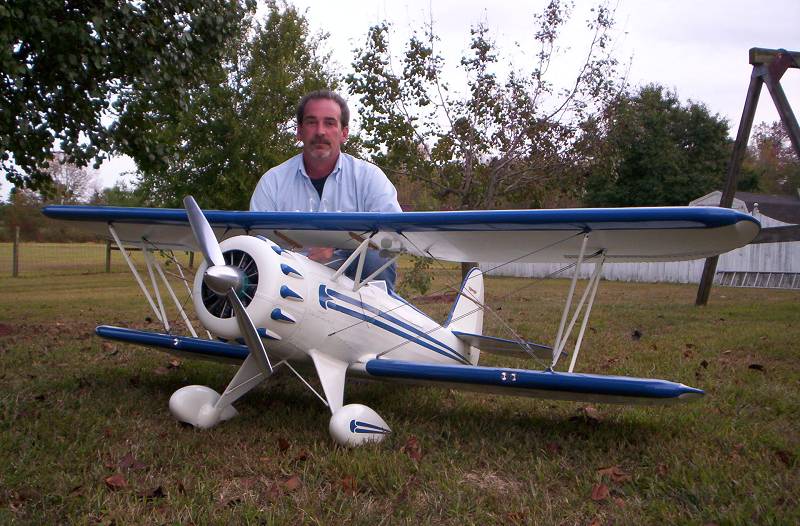

Here is a couple pics of my 25% scratch built from Pepino plans.

Beautiful.... I'm scared to ask.... how long did that one take build? And don't tell me 3 months. I can't decide what base color to put on mine. White or yellow. I've got the factory decals in red to go on it. I'm older and find myself wanting to use yellow and orange so I can see them better. You are a master builder!

IT took in the nieghborhood of 8 months and over 800 hrs of hair pulling work. The 33% is going together much faster and easier.
Thanks for the compliment, if you are looking for a tough build the Pepino Waco will fit the bill.
