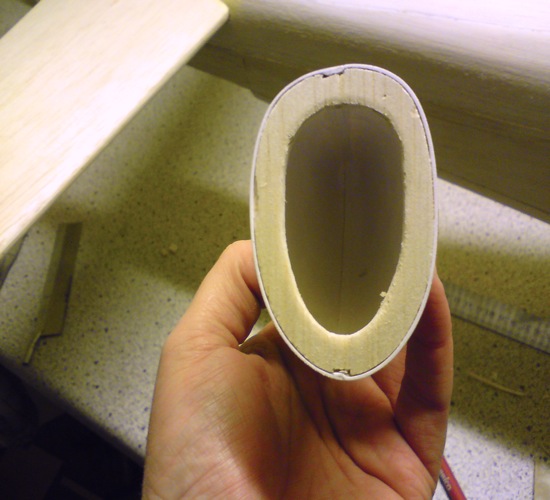

Heres some og the status of the plane right now.
Made ready for lights in the wingtip. There are 4 thin wires in the white tube going through the wing.

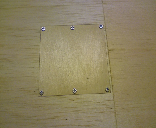

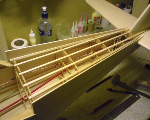

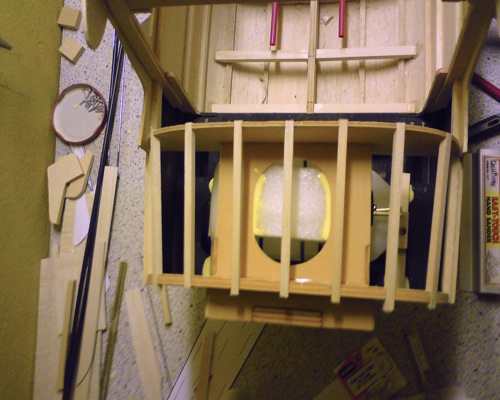

The servoes just about fit under the floor plate of the interiorkit.
Ill change the pushrod suplied by Top Flite with some bowden cables or sulivan cables. Cause the pianowire in the kit is heavy and very stiff.
And i plan on running the new pushrods from the tail along the button to the new servo location. What do u guys think about that idea. ???
The new pushrods would be glued to every former along the button to keep them from flexing.
PS: i just hate injectionmolded ABS plastic.... it never fits the way its made...

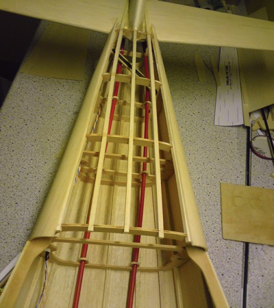

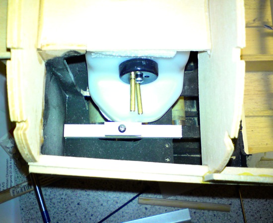

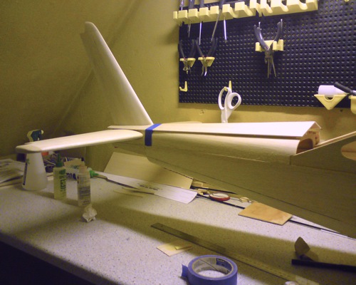

Well.. Servoes has changed position now. Made a new place for them, under the floor in the cockpit, and skipped the pushrods from the kit. Used Dubro instead.
They are fixed to the button on every former in the tail and then dont move now, very firm.
Here are the result of the danish jury of tonights work...

Very nice work. Make sure those new servo rails are well secured. Can't tell if they conform to the the bottom of the fuse, or are just glued to the sheeting on each end. Might want to build a lighter ply structure with two full-depth formers and a top plate with servo cutouts...you could lighten further by drilling lightening holes in the structure.
I'm anxious to see the interior possibilities without the boxy intrusion. Pedals, etc. Should be cool.

The rail er formed to match the curve of the fuse sides, and glued with epoxy. Ure right, ill make a small former and glue around the stick where the rail meets the fusesides... just to be sure.
Also thought about putting fiberglass cloth on the fusesides. To put more strenght to the sides.

No the reason was that the servoes was hidden, and impossible to get at when dashboard is made, but the idea of a fully floor cockpit sounds liek a challenge
Well, besides gluing two fingers together with cyano today, i made some progress on the tail.
Made wires for light in the tailcone and fin... and glued the red outhertubes to the formers.

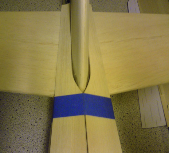

But i need Your help now Guys,,,,, Top Flite wants me to sheet the top of the tail with two full pieces of balsa sheeting. I was wondering if i could cut the sheeting along the aft edge of the blue tape and then sheet first the front upper tail and then make the sheeting around the tailfin. Would that influence on the strenght that the sheeting gives the tail. ????
Heres some visual proof of the progress for tonight..... now i want a cold one and watch MONK.... he´s cool.... [8D]

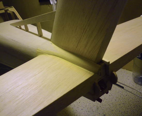

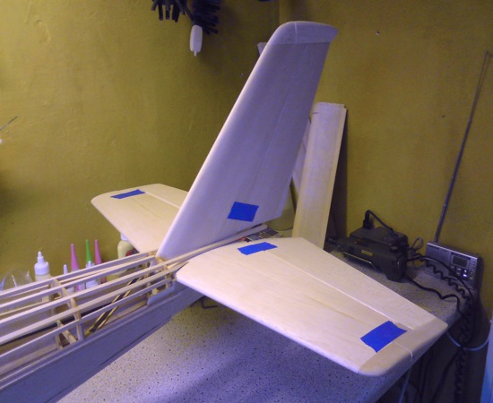

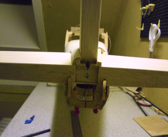

Well.. i did it.. i cut the sheeting and made some reinforcement on the last former.
Sheeted the tail and made the dorsalfin.. Here is the results...
And now i can see its starting to look like a Cessna,,, otherwise i´m building on the wrong kit...

That looks like what I remember of mine. White wood glue (Gorilla wood glue that is) will not harden up on your fingers before you can get it off. That is what I have been using on my latest build Sig 1/5 Cub. All of the joints look a lot better also. Only thing is if it will not hold itself together you have to sit there and hold it or find a way to clamp it together.

Okay.. ill search for a bigger engine... But i want to keep it inside the cowl...
made some work on the fueltank yesterday.... getting ready for sheeting the nose and making the former/blocks for guiding and holding the cowl

Is that balast I see in picture number 3? Mine had that big Evolution 100 2 stroke in it. There was plenty of room to keep it in the cowl, and it was turned on its side. My boss has one with a YS 120 inverted and we had to cut a little off the bottom to get it to fit. That is probably the best engine sizes I think do to the size and weight of this airplane.
Good luck making your decesion.
