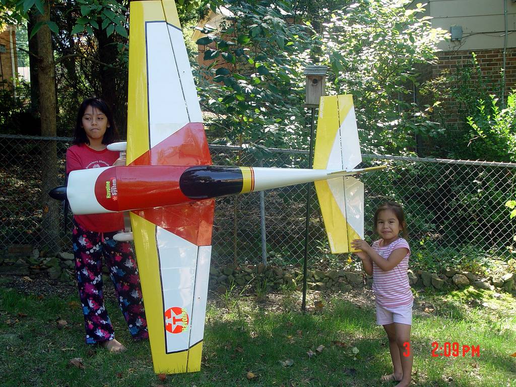

Here's me and my brother in law who gave me the kit with the completed plane before the first flight.
Me:
My brother-in-law Mike:
Me:

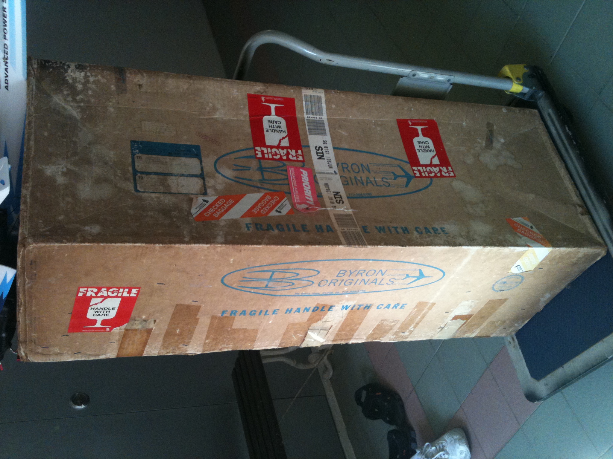

Hey guys,
Tried posting a while back but the PC hanged on me..There's been some minor progress so far and will post later..
Just to show how old this kit is..
