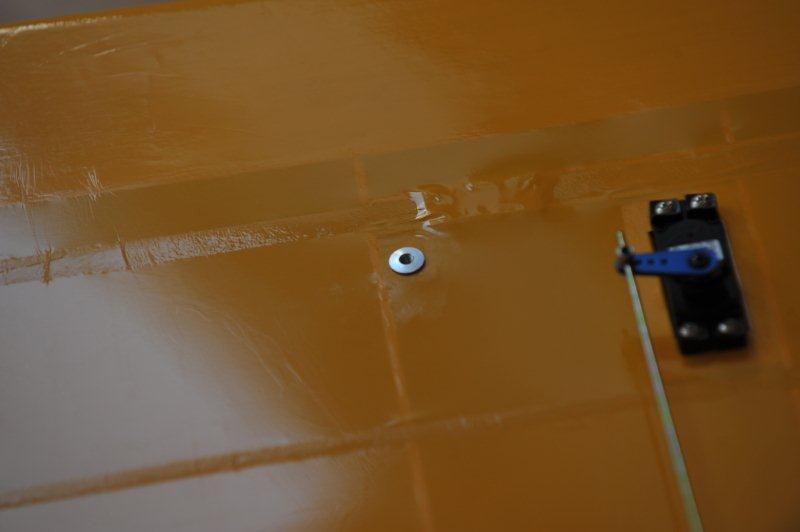

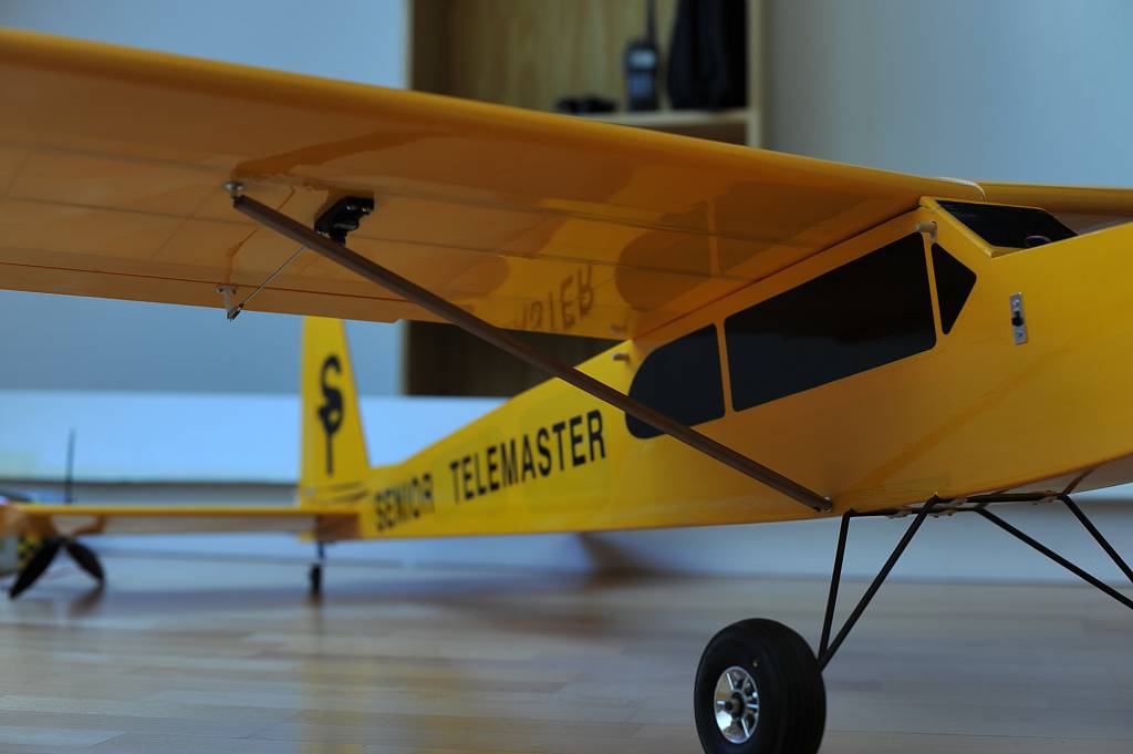

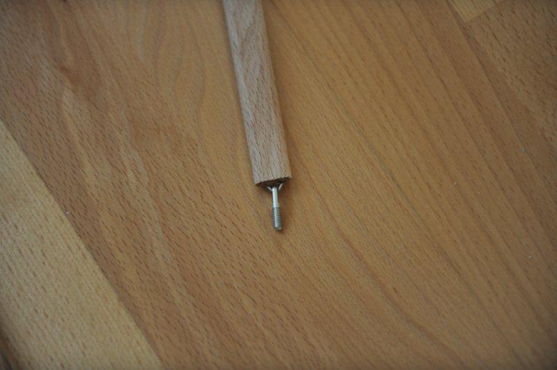

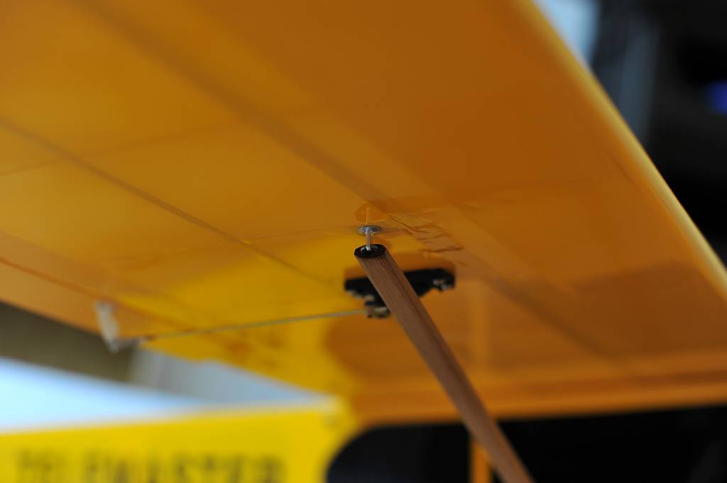

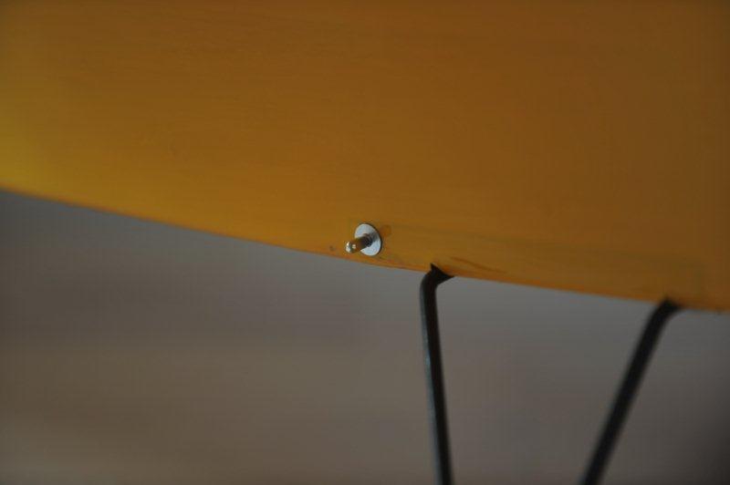

Thanks for your replies on wing struts.I tried to upload images of what I did to make the struts but was not able to up load images. Basically I used Great Planes wing strut fittings mounted at the wing to a block I epoxied to the wing spar & drilled and taped the block to accept a nylon screw.On the fuse I used a metal plate and attatched the Great Planes fitting to the plate with a clevis pin made from a machine screw. The strut fitting # is gpmq 4258.The strut is maple app. quarter inch square.Again thanks for everyones input.

Here are pictures of my struts.

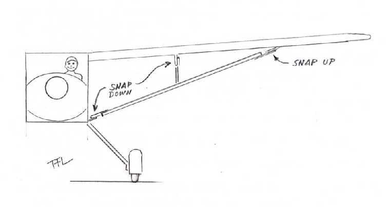

The big snaps cannot possibly snap out on their own when the strut forces are acting.
A bit of imagination to fasten the snaps depending on the wing and fuselage structure is not the end of the world . . . LOL.
The lower end should snap into a piece that goes across the fuselage bottom all in one piece (like a strip of aluminum screwed into the fuselage) so that the pull of the struts does not force the fuse to open.
