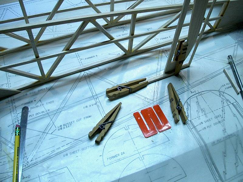

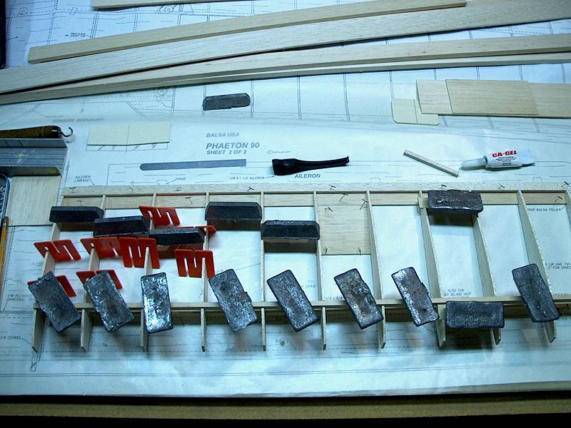

Way more important, to me, is a wide assortment of clamps. Get two dozen spring clothes pins and invert them. I also really like the House of Balsa rib jigs. Six of these and you can rip off a wing half with CA in 20 minutes (not including the pre& post sanding). A bunch of lead weights have proved invaluable in keeping the work in place (I use Titebond II as much as CA).
