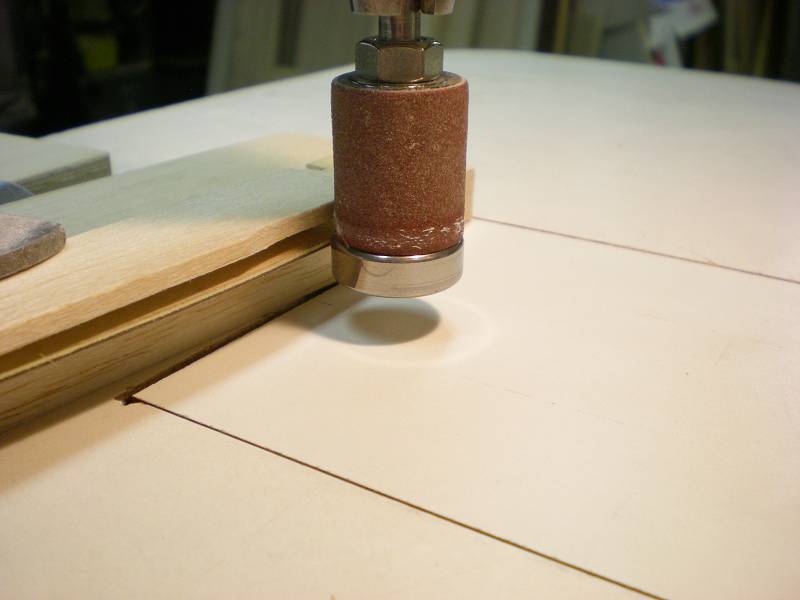

Has anyone tried using a router table to cut out parts via a template? Seems like a reasonable method. There are up spiral and down spiral bits on the market that should help with tear out.

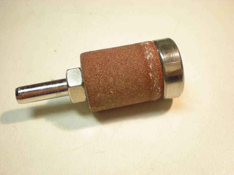

I've tried the router table method but had mixed results. The balsa didn't trim as clean as I thought it would. I did have great results though using a sanding drum with a bearing mounted on top, mounted in my router table set at low rpm.

ORIGINAL: yel914
Nice idea, yel914.
Did you make the sanding drum/top bearing or is it available on the market? Don't believe I seen one.
This combination would give you lots of flexability and make quick work of duplicating parts.

Flyby8, I made mine from parts in the shop. The drum is 3/4" diameter as is the bearing, but I'd prefer a larger one. A drum with 60 or 80 grit works well, finer grits tend to cut too slowly and burn. I think something like this is commercially available, maybe Woodcraft or Rockler woodworking tools. The picture shows mine chucked in the drill press, which I sometimes use in place of the router table. You need to space the template away from the balsa to be trimmed by about 1/4"
