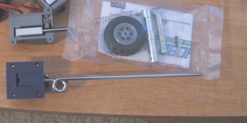

They finally arrived.
I've included pictures.
Picture 1 is the complete setup along with my Tx and Rx for testing. I also put a pair of GP .40 sized mechanical retracts in the picture for comparison.
This "main gear" setup compes with a controller box, about the size of my Rx. It has one lead coming out which plugs into the Rx. And like a Rx has 3 "gozintas" (Goes intos) Then the retracts themselves plug into it. And finally two bags of struts/tires.
The connections were pretty straight forward. And they worked right out of the box. It takes about 15 seconds for them to fully retract or extend.

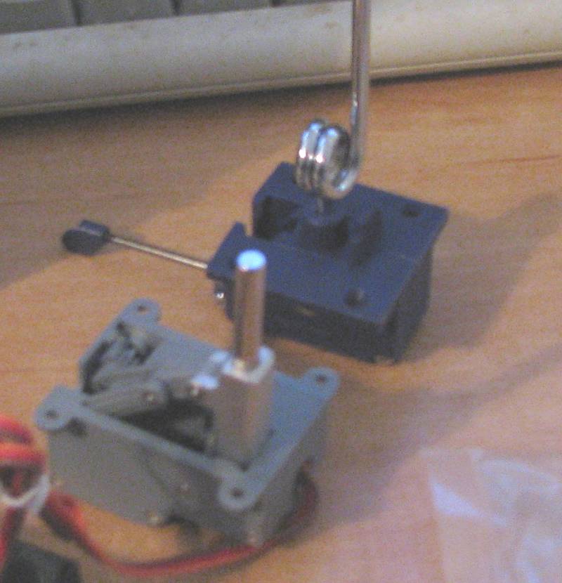

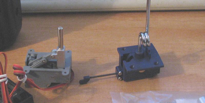

Other pictures has just the retract and the mechanical retract beside it for comparison. Both in extended and retracted positions.
Initial impressions.
I would NEVER put them in anything bigger than a .40 sized airplane.. And that's pushing it. I would NEVER use them in a scenario where they retract forward. They don't look to have any "locking" capability. So I'd only use them in a scenario where they retract side-ways.
I had the thought of bashing them into a Slow Poke 40. They might work there. The plane is a slow flyer, can land at a slow speed. Etc. Rough grass fields might be a little iffy, especially on a fast landing plane..
Just my thoughts...
