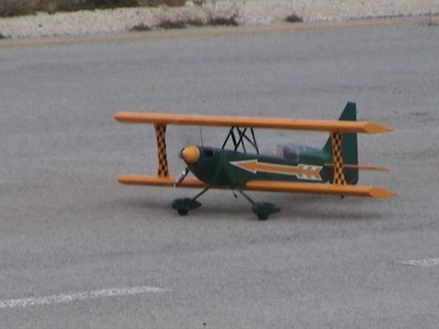

Old 01-10-2004 | 04:44 AM
Hisham's Avatar
Posts: 905
From: Beirut, LEBANON
Default RE: Engine for GP Ultimate? OS61FX too much??
I have an OS 70 FS on mine
flies great need to change the location of the battery
for better balance (middle of fuse.)
With two aileron servos in the bottom wing!
Cheers
Hisham
