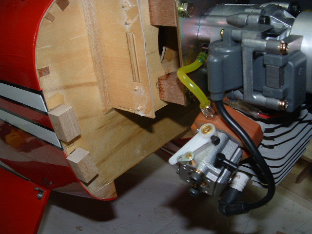

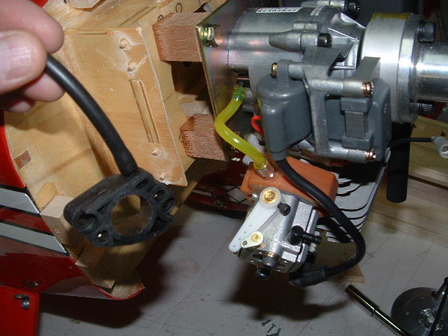

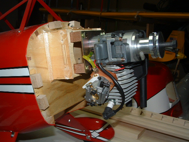

Can anyone post some pics on how they did the throttle linkage on a Zenoah g-45 installation. The throttle arm on the pic below is at full open position, but at closed position it is at 90 degrees pointing straight at the firewall. The other problem is if I turn the throotle arm, it interferes with the fuel inlet and the choke arm???
The engine also came with the stock insulator which is black in the other picture. It changes the angle of the carb so the linkage is virticle.
Any help would be greatly appreciated.

I think that you may have to hook your throttle via a seperate bellcrank and ball links. Don't know why you haven't gotten any other suggestions yet. You could maybe move this to the engine forum or the tips and technigues forum for more hits and hints. [&:]

I would cut the throttle arm shorter so it clears the choke arm. Then, drill a new hole and bolt a ball link to the arm. Once you do that, you can loosen the arm and rotate it so that it just clears the fuel inlet. Once you do this, the arm will full open the throttle, yet clean the choke arm when you pull the throttle back without it resulting in the arm point straight at the firewall.

Thanks guys,
You were right JWN, I cut the throttle arm, drilled a new hole and put a ball link on. This made a huge difference. I also put the stock insulator back on so I will be able to mount the servo on the firewall without the use of a bell crank. Also, this moves the fuel nipple so I wont have to loop the fuel line around to the front of the carb.
