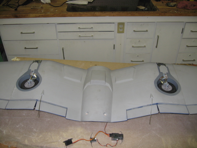

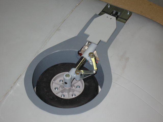

I made mine from a two liter soda bottle and some plastic sheet that I had.

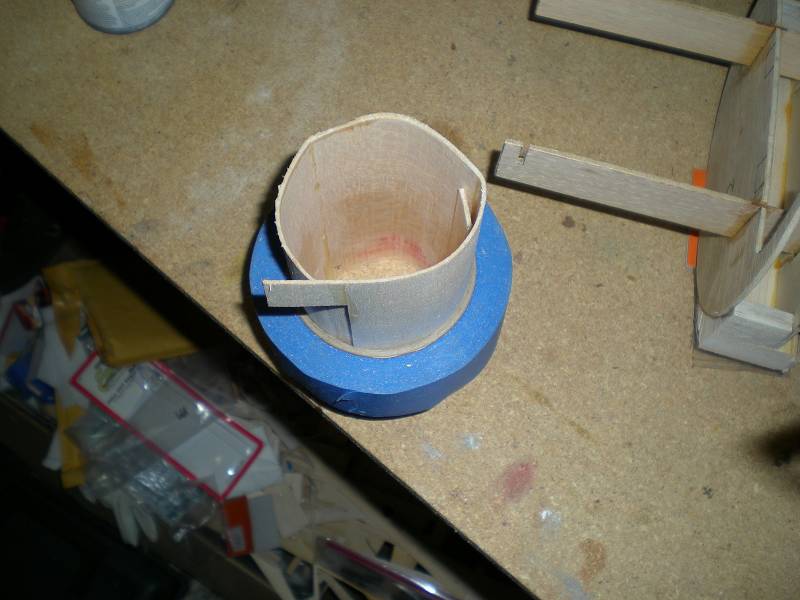

I made mine from wetting balsa sheeting and putting it in a tape roll to dry, then just cut to fit the size you need.
