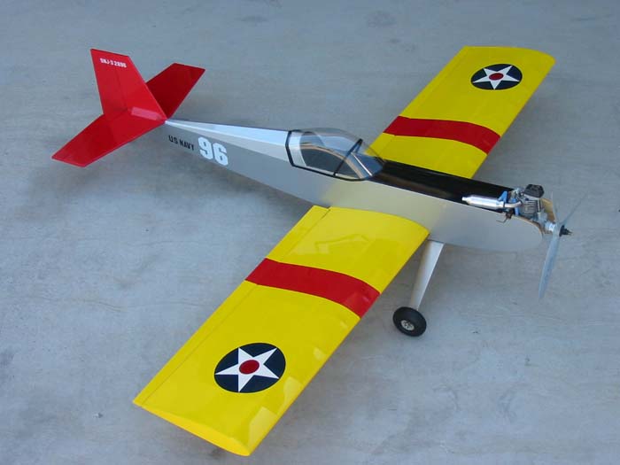

Four Star 40
Built it in 17 days. Thats fast for me.
Really easy build.
Powered by an OS 52. Shortened wings by 1 rib each side. Extended rudder by 3/4". Rest is stock.

Looks great! how does it fly?

Nice color scheme!

Compared to most Four Stars I've seen, that's a different look. It's beautiful. How does if fly with that 3 bladed prop?

I just got back from the flying field and the Four Star 40 flys great. Its a real easy airplane to fly. Bout as easy as a trainer.
1 click left aileron and 1 click down elevator trim was all the was needed for straight level flight.
The OS .52 didnt like the 3-bladed 12x7 prop. It was a little too much for it. So I put on a 11x8 APC. the little OS .52 turns it at 10,200 and throttle responce is great. I may try a 12x7.

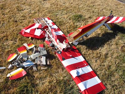

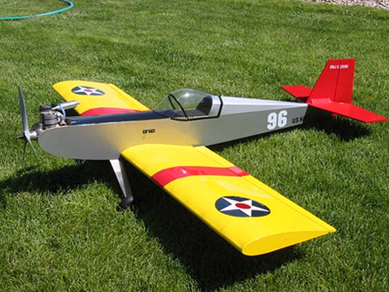

heres a pic of my old Four Star 60 that lasted 11 flights until the crystal whent out in the RX.
I also installed retracts. If you look close you can see the retracts still in the wing.
see thread for more info on the Four Star 60 i built
http://www.rcuniverse.com/showthread...hreadid=323144]

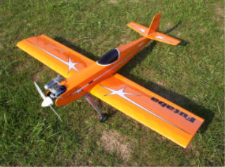

Did mine in 7 days , Started on a Saturday got it done the next Saturday. Second one I've built so it was a breeze. I also shorten the wing by one rib bay. Great mod in my book. Enlarged the rudder about 3/4 of a inch, used a Somethin Extra canopy. I have a TT 42 in this one, light and fast. It always comes to me to the field. JT

JT...Good call on using the SE canopy, that looks much better than whats provided.[8D]
WOW that's an amazing covering job how did you do the faded orange
