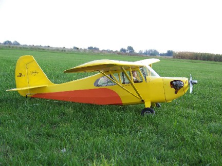

You don't have to fuel proof Solartex, but it will be difficult to clean fuel residue off if you don't clear coat it. I used latex for the orange on this Aeronca covered with Worldtex (same stuff), then clear coated with Nelson Hobby's water-based paint with cross-linker to make it fuel proof. Good luck, Dzl

Default RE: painting solartex
The Nelson Hobby clear coat goes on with a foam brush. It works "as advertised." I used three coats on the Aeronca in my previous post. You can recoat almost as soon as you've finished with the previous coat. Dries fast. Good luck, Dzl
