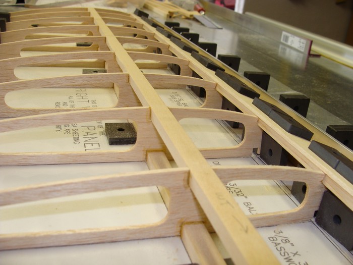

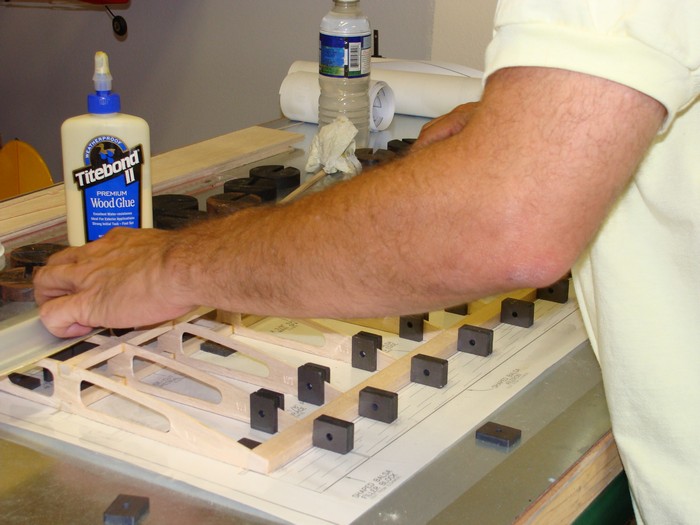

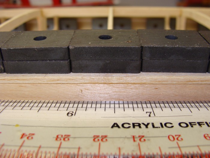

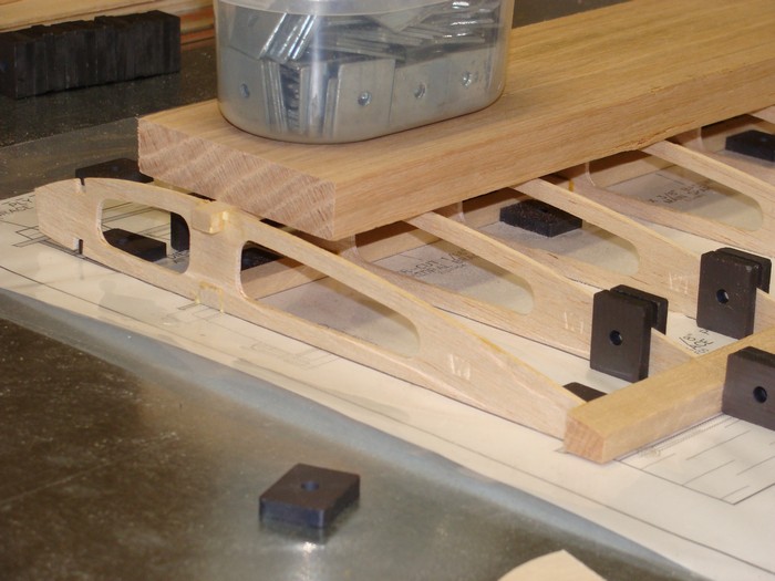

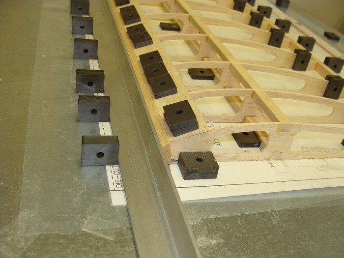

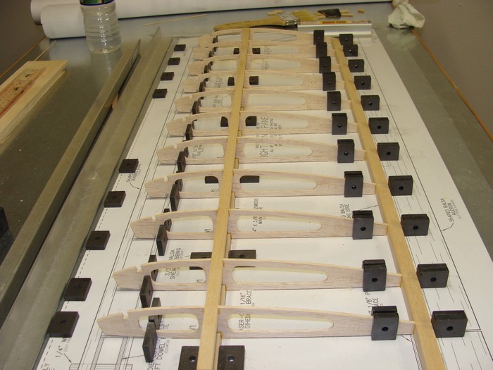

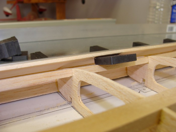

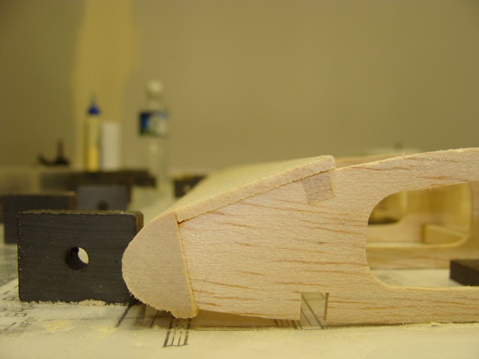

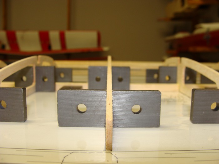

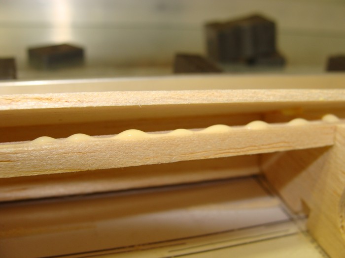

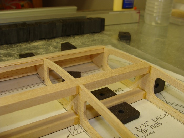

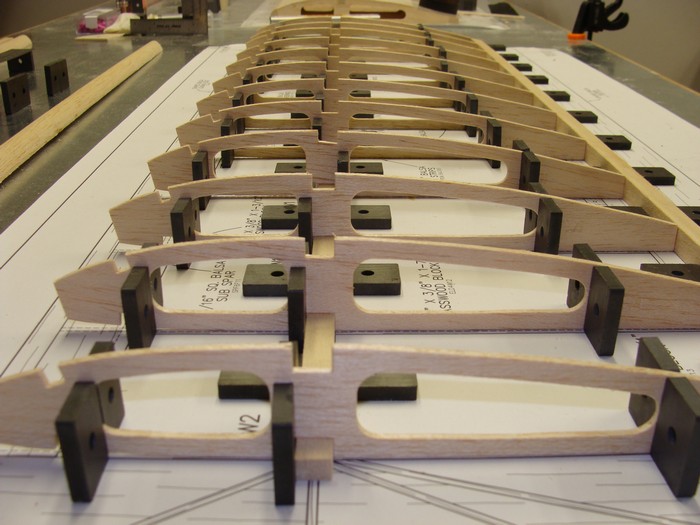

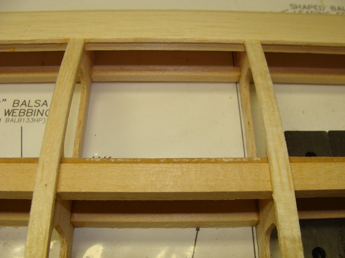

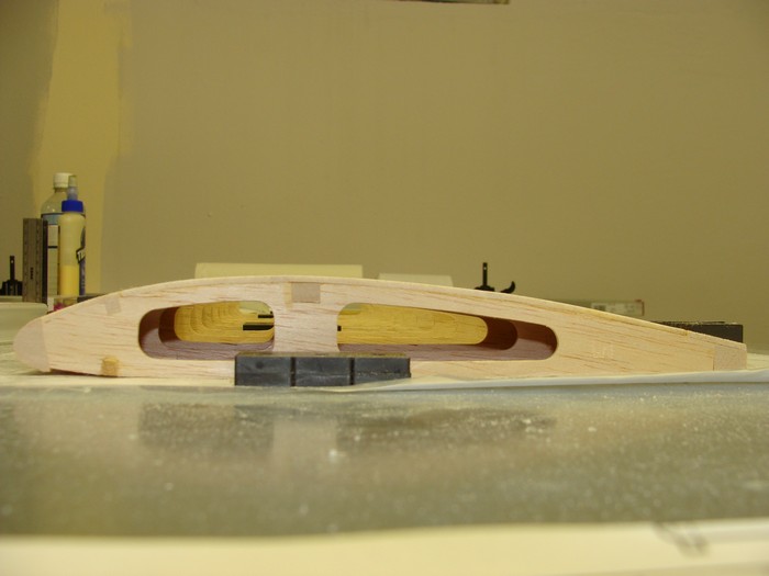

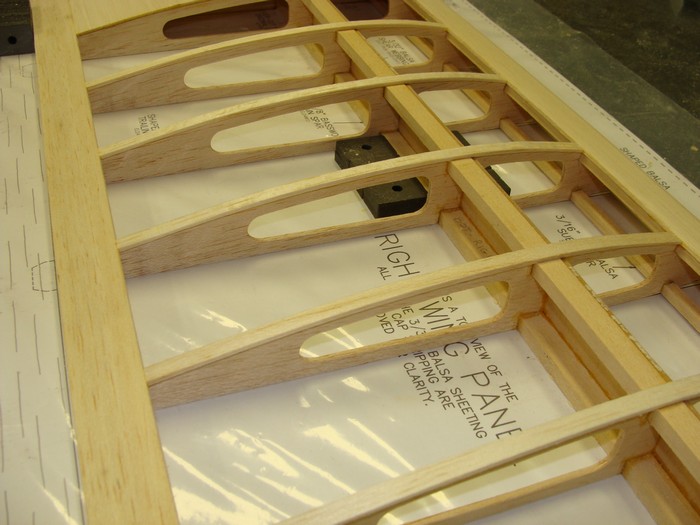

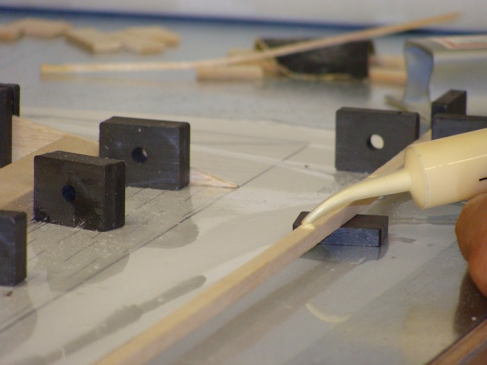

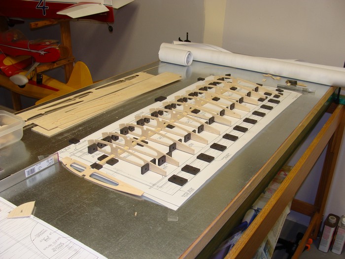

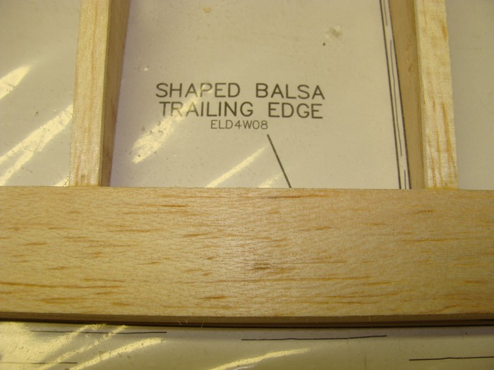

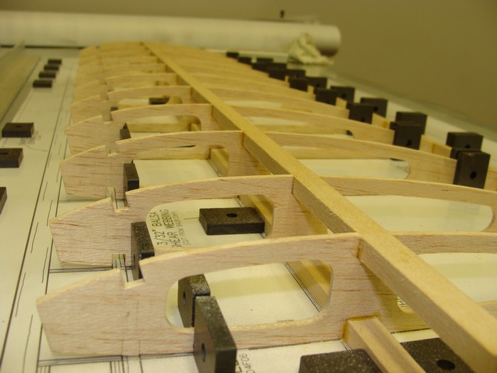

Good Evening All,
Well last night I finally got to apply some glue to the right wing panel and now the basic structure is just about completed. I still need to add the LE and top sheeting but that will have to wait until tomorrow.
To start the night I went over all my previous work to make sure everything looked right. After a few small adjustments I took all the parts off the board and covered the plans with plastic and then proceeded to put the parts back together, this time with glue and then left everything weighed down for the night.
Here are some of the photos from last nights work. Enjoy.
Miguel
ID:	1167477   Click image for larger version
ID:	1167478   Click image for larger version
ID:	1167479   Click image for larger version
ID:	1167480   Click image for larger version
ID:	1167481   Click image for larger version
ID:	1167482   Click image for larger version

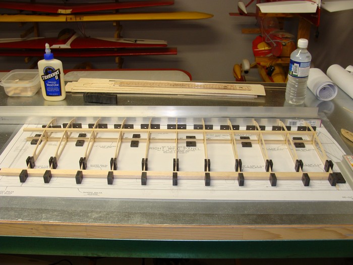

Hello All,
So far today I have managed to contineue work on the right wing panel. The steps that I have completed include the addition of the root rid, the leading edge spar and the leading edge, the leading edge sheeting and the trailing edge sheeting.
Here are a bunch of photos to show todays work. Let me know if you have any questions about the photos or the methods used.
Miguel

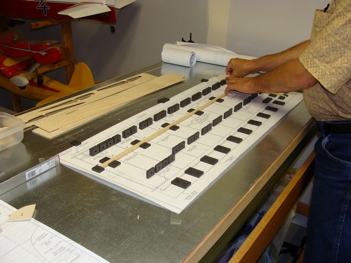

I am working on the shear webs and I was making a little photo tutorial for all to see, and wouldn’t you know, Murphy stepped in and killed the batteries in my camera. Now this wouldn’t be such a big deal because my other camera uses AA batteries which are readily available but I had just lent that camera it to my niece this afternoon. So, no shear web tutorial for this wing panel. The battery for the one camera that I have in my possession is now being charged.
Next, on to the center sheeting and cap strips. Hopefully my camera battery will soon be charged enough to use.
Miguel

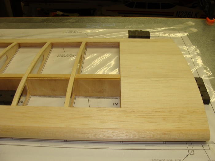

Good Afternoon All,
Now that my camera battery is all charged up I guess it's time to show what I have been doing since the time that they died out.
Since my last post I have added all the shear webs, sheeting and cap strips and also the lower leading edge sub spare, gave everything a once over sanding and dusted off the panel.
The instruction say to stop here and repeat the same proceedures for the left wing panel, so that is what I will do. While doing this panel I will try to show how I use the magnets to my advantage and how they can help out with certain troublesome spots, so please stay tuned in to this channel.
Now for the photos.
Miguel

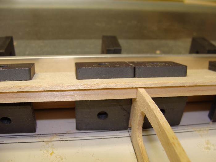

I have decided to take a break from the wing panels and do a little prep work on the wing tips.
As can be seen, I used a glue called Super Phatic to hold the wing tip parts together. This glue is great for glueing sheets together, it really sinks into the wood and it is an easy sand. I use it for all my sheeting and am very happy with the results that it is capable of producing. I would recommend it to anyone.
Miguel
