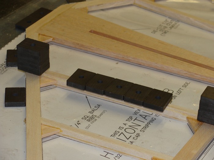

The subject of this build thread will be the Top Flite Elder 40. I will be doing a few modifications to this plane by way of dual aileron servos and a larger rudder and maybe something else if I can come up with something interesting to show. Any ideas will be graciously welcomed. The finishing will be done in a non-iron-on fabric which will then be painted with fuel proof paint.
While doing this build I will try (as best I can) to keep track of the time (or should I say life) spent on this kit both in hours, weeks, months and (hopefully not) years and posting the data as I go along. I'm not sure why I want to keep track of the time spent other than that I think it would be interesting and informative.
I will be building this kit with magnets instead of the usual pinning method, so if you're interested in building with magnets plase stay tuned. I will also utilize, almost exclusively, wood glue and epoxy and maybe even one or two other "x-zotick" adhesives. The use of CA will be strictly limited as I don't like the fumes and it sands like, well, you know.
Now that I have got the introduction out of the way it's time to start sticking some wood together and posting photos. Please join me on this build and feel free to chime in at any time as all constructive comments will be greatly appreciated.

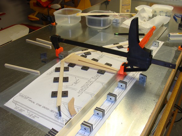

Finally got started on the kit today. I started a little later than I had planned because I'm re-painting my shop and it took a little longer than I thought it would take.

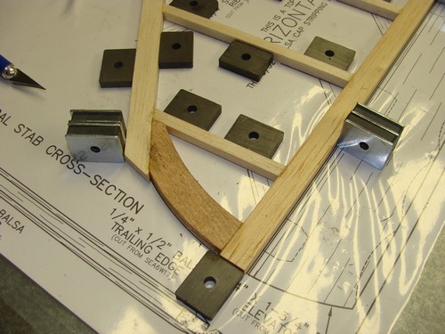

Today I started on the Horizontal Stabilizer as it calls for in the instructions. I laminated the stab center piece and the stab tips, using the magnets really helps in keeping everything lined up correctly. Since I used wood glue I was able to put the peices together and align them with the magnets, after a few minutes when the glue has had a chance to penetrate the wood I placed a heavy object on top of them to really push them together. Eventhough I'm using wood glue this method makes for a really strong lamination, it works even better with epoxy.
While the laminations were setting I put the stab plans on the table and started cutting the LE and TE parts and placing them on the plans. I then put the laminations on the plans and dry fit the outer parts until I got an acceptable fit and then cut the ribs to fit. Next was to glue everything together so I covered the plans with plastic and started glueing!
This is the first day of Week 1 of this build. So far I have worked for 4hrs, 35 minutes. Still more to do before I call it quits for the night.

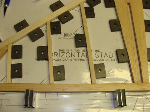

I got some more done this evening, I put all the ribs and gussets in, gave the stab a quick once over sanding and took it off the table. I'm sure that I will finish it during my next session. This work added another two hours which makes the total for today 6 hours, 35 minutes.
Here are some of the photos I took today just to show my progress, hope you all enjoy. [8D]

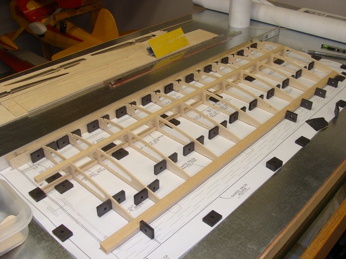

I have been working on dry-fitting the parts for the wing panels, no glueing yet but I am expecting a big push on the progress chart very soon.
Here are just a few photos of what I have been working on. Hopefully I should have the wing panels completed before Sunday night. Wish me luck.
Miguel
Boy, you sure use a lot of DOMINOs. Do they work well?

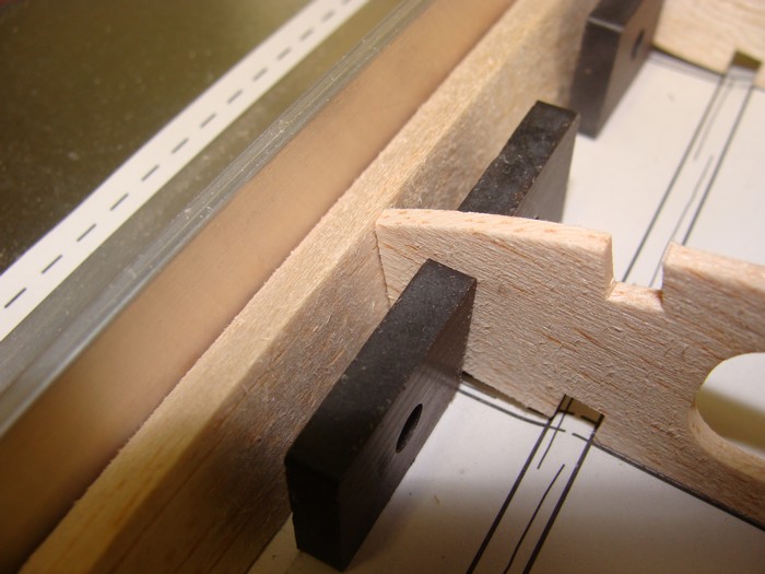

Those aren't dominos, they're magnets. Dominos have little white dots on them and they don't stick to metal.
Magnets don't and do, ah, mmm, respectively.
Seriously, the magnets work GREAT! I don't think I would be building if I didn't find out about building with them, the pinning method was just to frustrating for me. The magnets make it much more accurate to put the parts in place and easier and quicker to move them around and adjust them. Another added bonus of using magnets is that your plane does not end up all full of holes!
I still have to finish making the fixtures I plan on using with the magnets but I really won't need them until I get to the fuse.
If you (or anyone else) would like to try using magnets, all I can say is to buy a few and put one wing panel together, I'm sure that you will never go back to pins. Try it, you'll like it!
