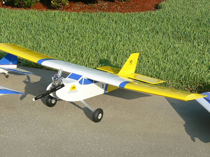

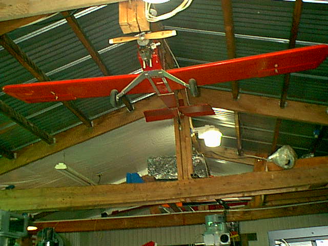

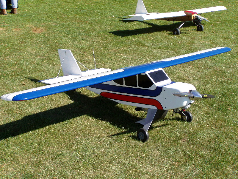

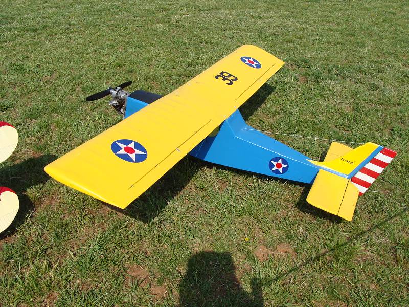

I have found a few pictures online, I don't think any of the owners would mind having them reposted here.

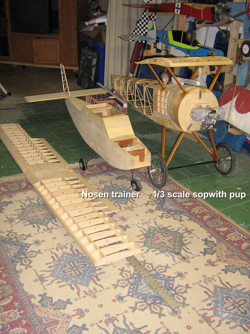

Here are a couple pictures for size reference. The trainer is sitting next to a 1/3 sopwith pup fuselage which is an enormous plane.

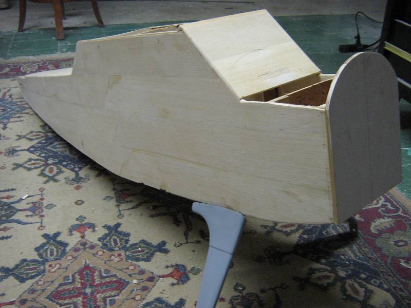

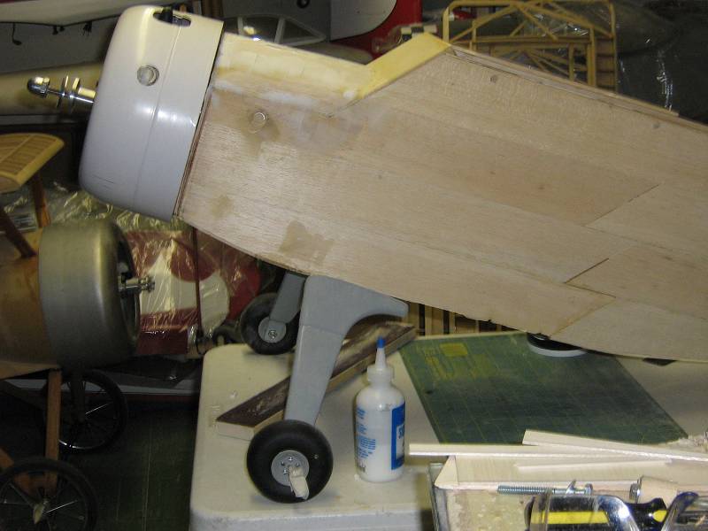

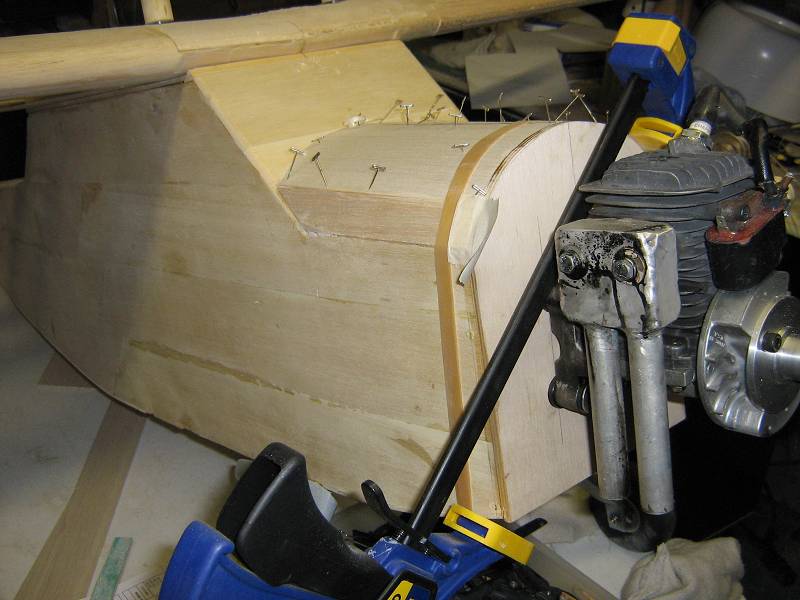

I decided to cut down the nose so that my poulan motor would fit on there. Mounting the firewall back about 6.25 inches from the front of the original cowl line.
I have to strike when the irons hot as I tend to skip around a lot on projects.

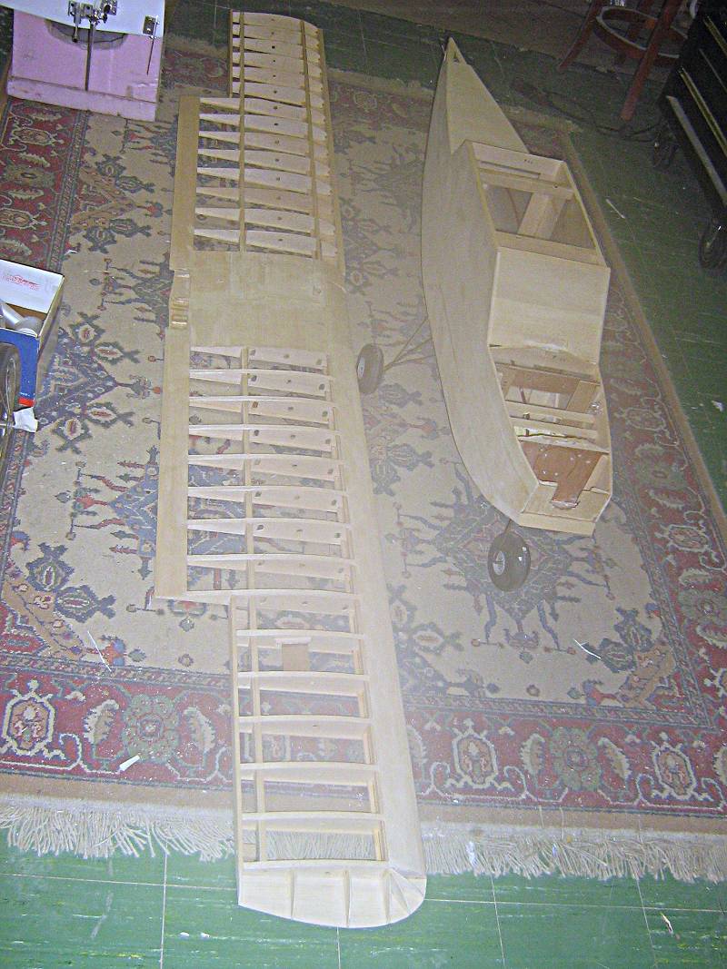

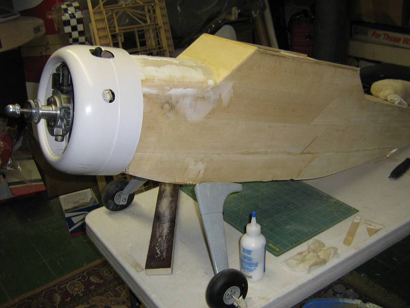

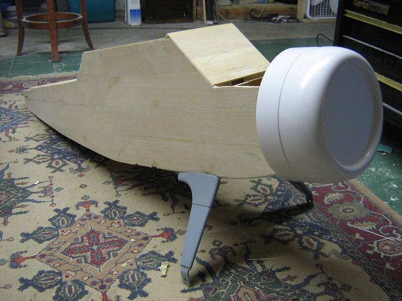

Well as you see there are some developments on project nosen trainer
I grabbed some damaged landing gear from a GP pt-17. A friend cracked the coating and didn't want them. So I glued them together. Then I cut the cross brace in half and mounted them with a gap between them so that they would be the right width for the fuse. I think they will look great ! plus if i do trash them I can buy a new set , cut them in half and mount them up ! Secondly note the large arch on top of the previous flat nose. When I moved the firewall back I decided to round the hood. And last the cowl ! I had a plastic cowl for a corsair laying around. the story how I got it defies logic !! ha ha
So I kind of float back and forth between wanting it to look stock up front, or something more monocoupe /beaver like.
My friend insists the rounded cowl route is the way to go. I am not sure how I am going to work the sides yet.
At this point I think I am going with a poulan 46cc conversion. Anyhow I hope the pics stir some interest in some other NOSEN TRAINER owners out there. I don't know if they are all crashed or just shelved...but they have got to be out there.

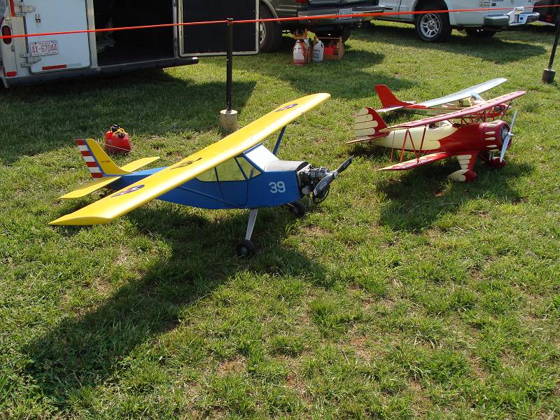

foodstick, thanks for the PM. I'll follow your thread and add anything I've experienced with mine that might help. I told you most of it in the PM. Here are a couple more pics of mine, the most recent I have. You can see how the ailerons end before the wingtip, shows how much I added when I stretched the wing, plus the carved tips. I used a rib as pattern for the tip, cut it at the chord line and used that on the end of the last rib.
The wing looks flat, but has about 1-1/2 degrees dihedral.

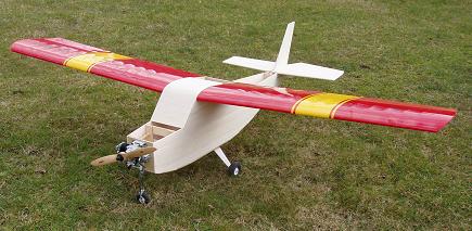

Hello everyone, i did one long time ago, inspire by this old kit, i did a giant gas trainer for 40 to 60 cc gas engine, there is a building thread on it AMR Trainer50.
Your Bud Nosen look great
Nice work

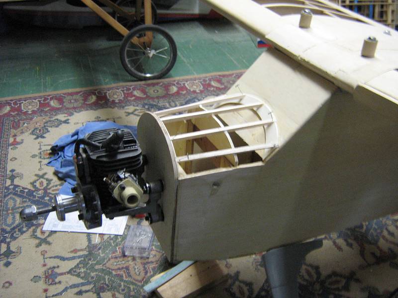

khodges , I notice your firewall is still quite aways out there. I moved mine back some to offset some nose weight. Did you have to add tail weight to balance out the long nose moment with the big gas engine? I wish I had moved the firewal back a bit more. I have actually moved the wing forward about half an inch so that will help as well.
I decide to go with a poulan 46cc I had ready to mount, its been on the test stand so it needed a ride anyhow. I am still walking around mine deciding on how to go with the cowl and cheeks of the plane.
I am also doing functional struts, its a good safety idea, and I have a slight twist in one wing that will come out once the struts are bolted up. I think a fairly new builder framed this plane up. I have found a few things I beefed up or changed, but all in all its a good solid job.
After doing some early balance tests it looks like a beefy tail wheel setup, and rear mounted radio will be help me get it right without adding dead weight. I guarantee I won't be putting lead on the front !
By the way if you should think of it..do you know where yours is balanced out? I have read everything from 3 1/8 to 4 inchs online.( I admit I haven't even noted it on the plans yet) Also how far is your firewall forward from the bottom of the windshield? Don't sweat it if its buried or a hassle to find out. But if you should get around to it I'd appreciate hearing the info.

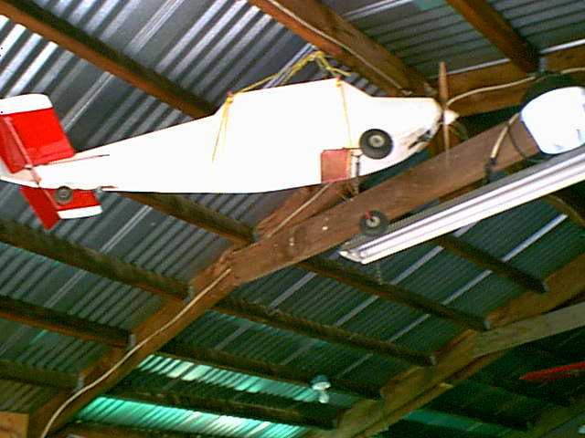

I have one of this planes hanging up in my shop.They were a big box of balsa when you got it with some wing ribs and a few bulkheads and a lot of sheets and strips if I remember right.It has been a long time ago when I built this plane.To fly this plane with a 60 size engine you better have a hell of a long runway.These planes are heavy,but they were well made and tough.They were cheap at the time for all the balsa that came in the kit.I used an old weed-eater engine that was pretty well hammered when I cut everything I could off from it to make it as lite as possible.Mine was flown several times and actuall was a good flying plane once you got it in the air and a little safe altitude.The first time it was flown it had only the elevator and rudder for control.
I must say at the time I was just learning how to fly and I flew it after a friend had it up and all trimmed out for me.He thought I had done a great job building it as it flew very nice and required very little trim to get it flying straight and level.I later bought a plane with a qudra 42 motor and thought this would have been a great motor for this plane,but not shure if there would have been aenough ground clearance for the big prop on the quadra 42.
The third or fourth time we flew this plane I had hooked up the ailerons and they were not very wide but they were big.My friend tried to use them but he said he could not use them to fly the plane as they worked like flaps instead of like typical ailerons,this was mabe also do in part of the plane still being so under powered with the old weed eater motor.This plane has now been hanging in the shop for years and the body shows it,s age,but the wing is still in top condition.Don't remember right off hand if the wing was 8 or 10
feet wide,I know it is at least a 8 footer.It is a real conversation piece for all who come into my shop.I have a lot of pictures of when I was building it but they are in the form of photo's in a album.I do have pictures (digital ones ) of it hanging in the shop.If I can find some of them in my photo file I'll post them here.
They were a neat plane to build because they were so big-
BIGMIG
The fuselage in the first picture and the wing attached to the fuselage of another plane-Its been hanging there for several years.

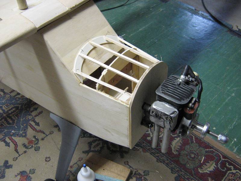

well I have actually done a few things to mine the last couple days.
I have the motor mounted, and started building the slightly changed hood. I wanted a rounded nose ,and I am still thinking about a round cowl. So i was able to mount the motor piston up, which never hurts for starting purposes...lots of cutting templates and sanding pieces for the nose modification, has gotten me to this stage of the game...

Default RE: Bud nosen giant trainer fans..anyone out there?
well I am dragging the beast back up the thread to show a little progress. I took some pics of the cowl mounted, its left over from a corsair. It looks out of place to me in the pics? For some reason it looks pretty good when I walk around the plane, but in the pictures the whiteness of the cowl makes it look much larger OBTUSE even!
filler on the hood, loose ends everywhere! this ain't your follow the instructions by the number type of build ! I am not always sure where I am going until I get there, or I might sand the last part glued back off ! Anyhow I figure some hesitant Nosen trainer fans might get their pride back out on the shirt sleeve if I keep adding info !
