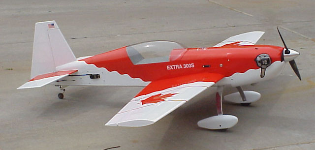

Old 06-15-2003 | 07:00 PM
SunDevilPilot's Avatar
Joined: May 2002
Posts: 2,025
From: Gilbert, AZ
Default My GP Extra
I have this plane and I opted for an OS 1.20 Surpass III. I currently am swinging a 16/8 Mejzlik prop on it. I have unlimited vertical and good overall speed. The plane flys great and is easy to handle. I went with Futaba 9202's on all surfaces and I find them a good match. Good Luck with yours!
Phil (Mesa, AZ)
