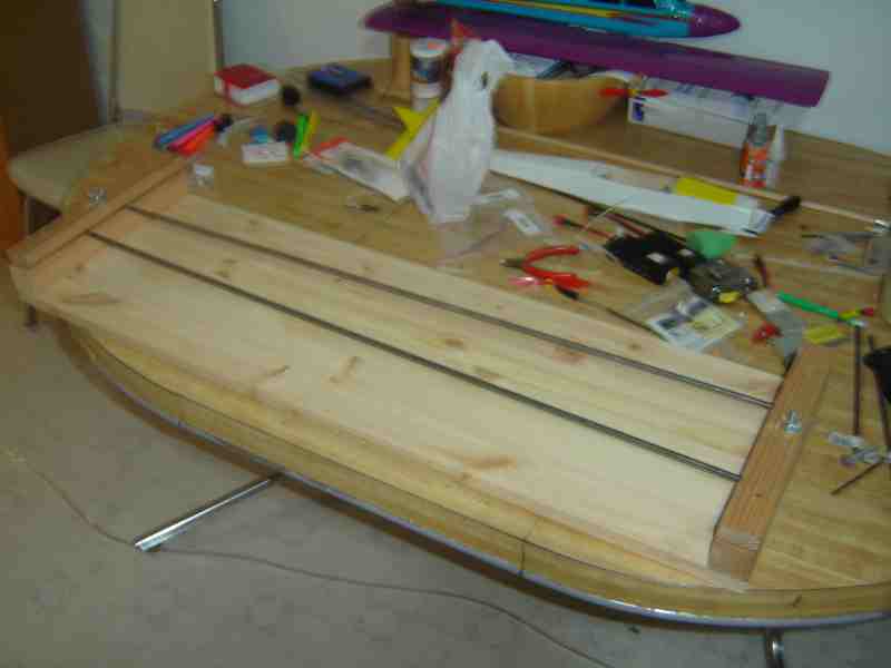

Here is my finished wing jig. It is a copy of one of my club friend made. It be interesting to see if it makes assembling the wing easier.

Old 04-14-2009 | 05:30 AM
  #34
kdc
Posts: 685
From: Shenfield, UNITED KINGDOM
Default RE: Cutting ribs
I made a similar jig but I also made intermediate supports to ensure the rods did not sag. There are photos on another RCU thread www.rcuniverse.com/forum/m_8660432/tm.htm
