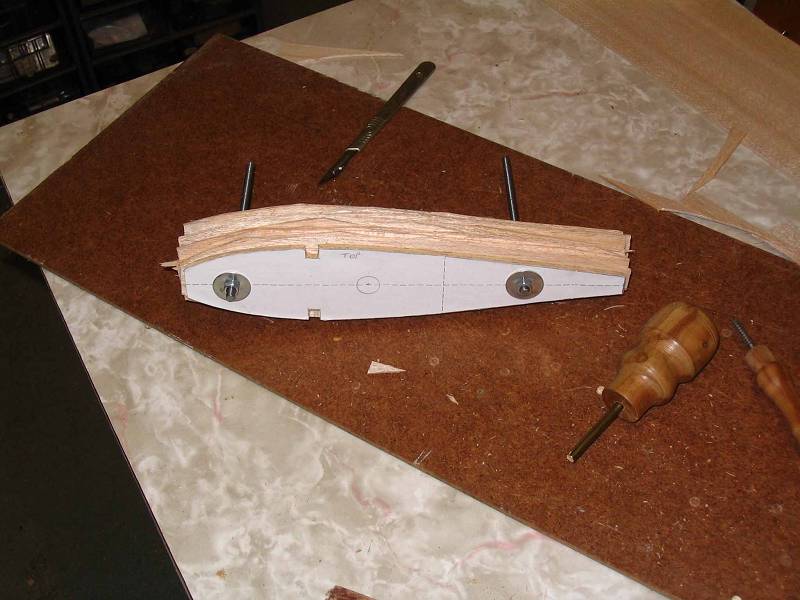

The easiest and most economical way of cutting paralell chord ribs is to cut a slightly oversize ply template without the slots and complex bits and use this to produce all the blanks. They could be about 1/16 oversize and cut roughly with a knife. They can be interleaved to get most out of a sheet and make a couple of spares too. Each should have two 1/8th inch holes to allow them to be bolted together as a pack for final sanding. Two pieces of threaded rod and nuts are used to bolt them together between 2 accurate templates with spar slots marked. Then place the pack can be gripped in a vice just below the threaded rods so no need to recess the nuts and sanded to shape with a sandpaper block, razor plane or preferably a Permagrit tool. Cut all the slot sides with a razor saw whilst still held in the pack and file to exact depth. The file will snap out the waste at the bottom of the razor saw cuts.
The photo shows what I mean....

here is an extra photo which also shows the sharpened tube tool which is used to punch the holes through the balsa blanks as they are cut. The oversize template has the holes in too so they are punched the same in every blank and align nicely.

Permagrit tools seem expensive but you only really need one the wedge block as shown. This removes balsa and even birch ply with just a few strokes so you can do it slowly and accurately. Also the dust is ccoarser than usual so its a bit cleaner too I think. They are sold in England by Ian Richardson who is often at Top Gun with his magnificent jet models. I was told that his wife actually suggested the design of the wedge block! Very useful to get in tight corners and it is double sided coarse and fine.

This photo shows how the slots are cut all at once. Any that ribs that have extra slots or larger slots are cut afterwards. A coarse engineers file is used for the slots too and the 'safe' edge is utilised to avoid cutting the sides when filing the bottom.
