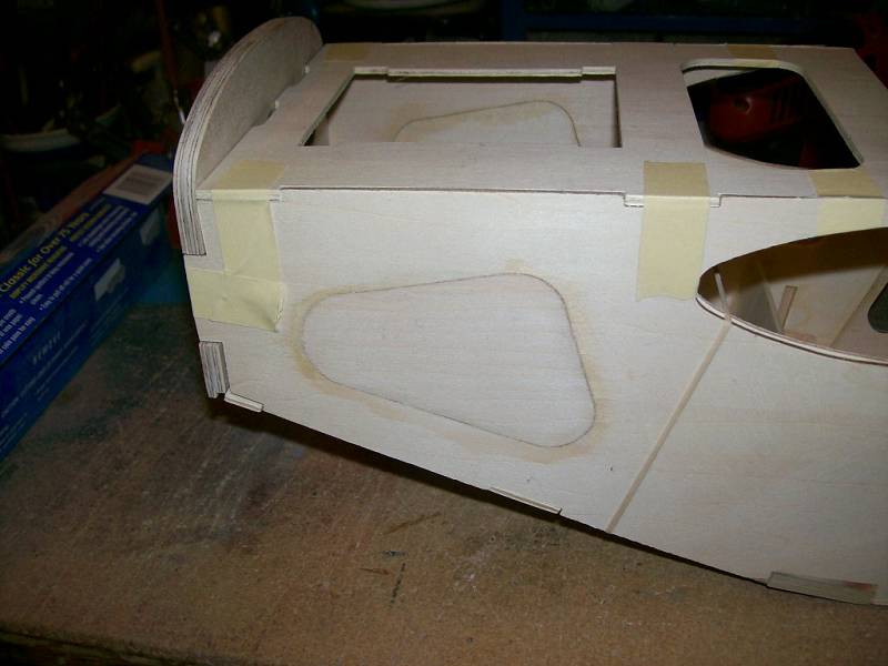

I started with the firewall typical 2 piece thats joined together with epoxy.
Nows the time a person needs to decide on what engine there going to use , since I don't know I will omit the part about the engine mount and go on .

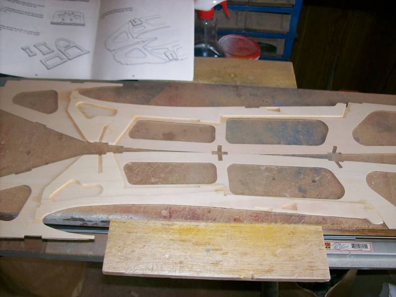

I then found the formers D,E,F and the slant former and added the 1/8x1/2 inch balsa doublers as shown in the manual.
I then found the fuse sides and punched out all but the front lightning holes. I glued these in place to add the extra strength needed if a larger engine is used.
I then glued the fuse doublers to the sides making sure I made a left and right fuse sides. Now comes the part thats a little tricky and hard to see in the pics but I omited the original landing gear plate and added one of my own on a slight angle towards the front of the fuse , this will help nose over if the plane has the larger engine or flying from grass.
I omited the landing gear triplers.
Next I Tapped the fuse together at thr rudder post with a piece of 3/16 scrap in between
Useing no glue just rubber bands and tape I added the formers starting with D then E and F.
I then added the fuse top ,You may need to loosen the tape to get the fuse top in place, then I added the slant former.
I then turned the fuse over and slid the fuse bottom in place.
Tapeing and rubber bands is all thats holding things together at the moment.but it allows me to see if I have a good straight fuse by laying it over the plans to check. If everything I good I will then glue all the seams with med CA, but only after I tack glue it in several places to make sure it stays straight while glueing the entire fuse.

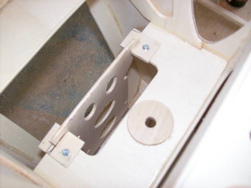

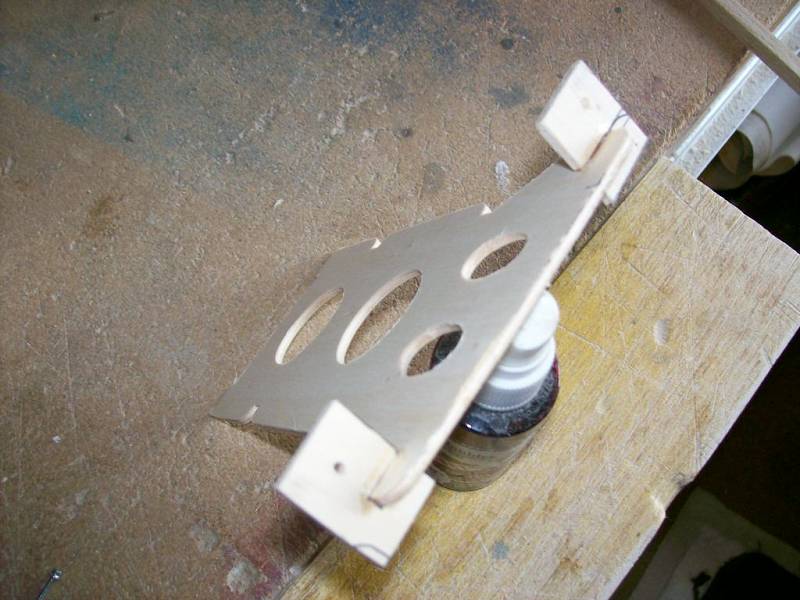

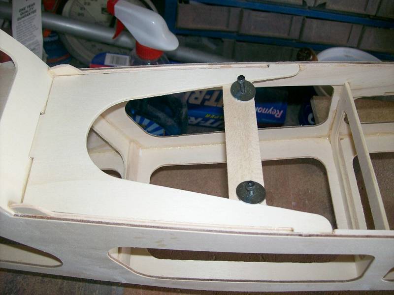

Ok nows a good time to add that landing gear plate I made I made it 1-1/2" wide buy about 7" long the extra length will be cut off later.
The original plate is not this wide and the bottom nose cover will need to be cut down and sanded on a angle in order to fit good, Also the fuse sides will need to be modified for the gear plate to fit.
I used epoxy to install the gear plate then added 3/8 tri stock to the insides of the fuse ,I also added the former C to the gear block,making sure it leaves room for the bottom nose cover to rest up agaisnt the gear plate and former C to tie it all together.
I then added the former B and firewall but have not glued then in place yet.
I hope you can see the gear plate and angle in the pics.

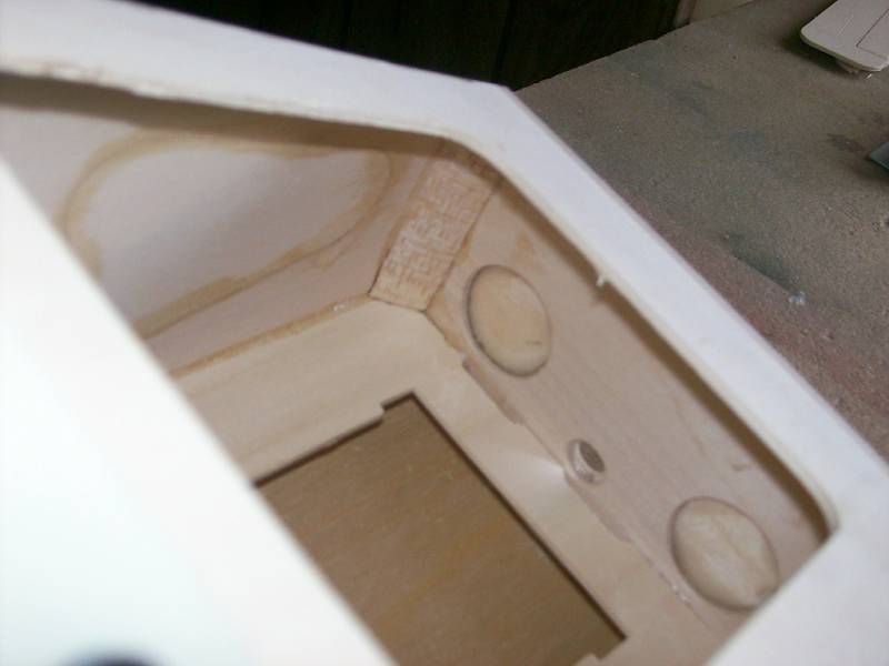

Theres 2 donuts you punch out from the FW ,one holds rear of the dowel in the wing and the other glues to former B for the dowel to fit in to hold the wing to the fuse. Again I used a 5/16 brass tube to cut the hole in the donuts for the dowel so not to over size it for a sloppy fit.
I then added the wing bolt plate useing epoxy to glue it in place ,but being carefull not to get much on the top so it would hold the rear fuse gusset up and hit against the bottom of the wing and prevent alot of sanding . I then glued in the gusset after some sanding to make for a perfect fit, Believe me its not that great.
Opps hold the phone, before I added the wing hold down plate I put the 6-32 blind nuts in place , much easier if you do it before.
After the wing doubler disk is glued in place and dried, test fit the wing and measure it from the tips to the tail, make sure the measurements are the same on both sides then make a mark with a ball point pen or pencil.
With the wing in place and correctly lined up use a drill bit that will go thru the blind nuts from the bottom side and drill a hole thru each one. I removed the wing and redrilled them out to fit the wing bolts with a little clearance and bolted the wing in place and rechecked my measurements.

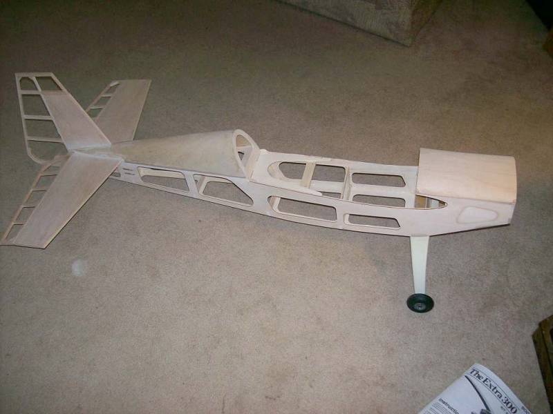

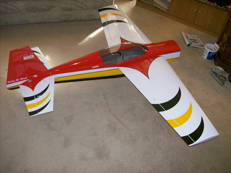

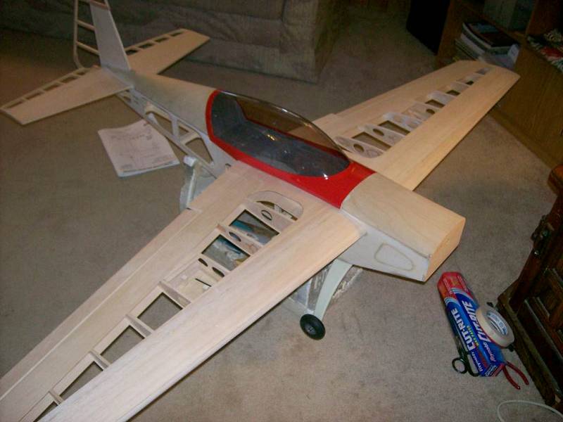

Well back at it again, I now have a finished fuse and wing.
I added the front cover piece and turtle deck cover last night and filled everything with spackel and let dry over night .Sand sand sand all day long.
As you can see by the pics I finally finished the rudder bet cha thought I had forgot to huh , Grins well I did *LOL*
I did a mod on the fuel tank plate so it can be removed if needed I took a couple of pics to show what I did. I will next do the canopy frame and canopy itself. I'll prolly go black with the tint on it ,we'll see as time goes by. Outside of maybe a few places that needs some sanding I have missed I think the wing and fuse is ready for covering. I still need to decide on the servo setup before I cover it, I may just go stock on this one with 4-40 rods.

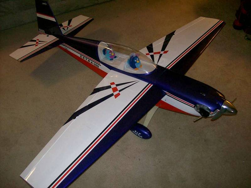

Hi again I played hooky and went flying over the weekend, So not alot got done, however I did manage to get the fuse covered.
I took my CB extra out and flew it ,well I tried to fly it, the engine mount had broken and things was moving around more than I liked.
Do yourself a favor if your building this plane and going to the larger sized engines, don't use the supplied motormount, I knew better but didn't have another that would fit at that time. The stock mount may work ok with a 60-90 size 2 stroke but the YS-120 was to much for it.
Heres a couple pics of my plane and one of the fuse i'm building. More to come later

I finished covering this airframe today. I'm running out of ideas for covering schemes, so this will have to do.
I glued in all the hinges and added the control horns , built up the pullpull system on one end only. They shorted me the elevator hardwood 3/8 stick used for the pushrod i'll see about getting one when I can.
I added a second servo set up behind the wing bolt plate like I did my plane, that way who ever gets this plane can add whatever size engine they want and not have to worry about adding unwanted lead to the tail if they go with the larger engine. I'll cut out the cowling and fit it up tomorrow I hope to have this all done and finished by the weeks end.
When the planes all done I'll do a recheck to the wings and see if I need to remove any twist that may have occured while adding the covering to it, I know I had about 1/2 a degree on the building board.
Here is a couple of pics ,when am I gonna learn straight lines not round *LOL*
