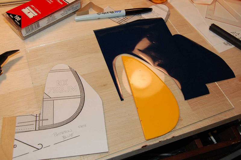

I am in the (long) process of covering my build. I am using a two color scheme and I'm having problems withthe material puckering at the point where the two colors meet.
The covering is SIG Aerokote lite (Corsair Blue) and AirBorne Models Lightex (Cub Yellow). Iam told that both materials are identical.The reason I have one of each is because SIG stopped offering the Cub yellow after I already had the Blue.
I am new at covering but I have managed to getthehorizontal stabilizer covered (and recovered) with no puckering. Today I was working onthe rudder and encountered this problem.

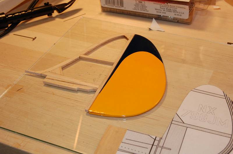

Myprocess is to cut the two pieces, overlap them by about 3/8" and thenbond them together using heat (obviously) onapiece of glass beforeattaching them to the framework.
However, after attaching them to the framework, I tried low heat, hight heat and even put a hole in the covering to let the expanding air escape but it just will notsmooth out. Both sides are puckered. However, theyare not stuck together due to excessive pressure.
My thought is that I may not have used enough heat to initialllybond the two pieces together and now they arepulling apart as I heat them.
Has anyone else experienced this? If so, is there a solution or technique to use?

Are trying to join two pieces of covering there, or is it layer of yellow with the blue over the top of it?? It looks like two pieces joined where they meet. If this is true then you need to assemble your pieces prior to putting them on the plane. Get a piece of glass or a mirror. Align your pieces together and overlap the edges by approximately 1/4" and use a trim iron (or the tip of your covering iron) to heat the area where the two pieces meet to attach them to each other. Now peel the assembled piece off of the glass and place it on your part to be covered and apply the covering as you normally would. This should stop the pieces from puckering like they are in the picture. Also, it will allow you to get the covering tighter as the assembled pieces will not act as one piece.</p>

Thanks for your time. I did overlap the two colors on a piece of glass just asyou described. Ithen applied what I thought would be enough heat to join them but not so much as to shrink them. Once Ithought the two were then one, Ilifted them off as one piece and applied them to the framework.
I may just have to experiment with a bit moreheat to join them. Like Isaid, it worked before on the horizontalstabilizerbut I just didn't write anything down about the exact iron setting Iused. I'mhoping to avoidwasting any more material by soliciting the experience of others.
It will be a couple of weeks before I can work on the project again. However,when/if I find a solution, I'll post it.
Thanks again for your time. I'm open to any otherthoughts or advise. (other than buying ARF)

To add to the excellent advice to date I have found that if you join the two pieces as described it only works for me if the join is in a straight line over open frame work, Im probably doing it incorrectly. If the line is curved I have only had success if there is sheeting under the join
. My two cents worth, and that is probably more than it is worth is to add some thin sheeting under the line of the join.

Are you going basically blue, with the yellow secondary? If you are going Yellow, with a Blue secondary (and not much of the secondary) I would cover the whole thing with the Yellow, and paint the blue. I have acheived my best striping and curves with paint, never reall good with over-lapping films. If the over-lapping is what you have your heart set on, use your glass pallette, and an actual adhesive to bond the two colors. Since you are fighting "shear" when shrinking the films, the two colors will always act independantly of each other. BOND them with an adhesive thatis heat resistant, let cure, and then apply as a single film. Good luck.</p>

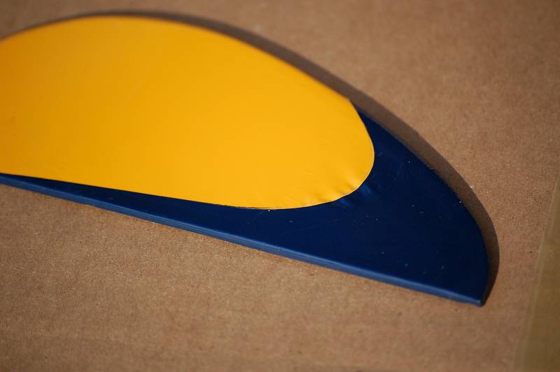

Thanks to everyone that posted a comment in an effort to help. I finally removed the covering and started again. This time I just covered the entire rudder with yellow and then cut and applied the blue over it. It turned out great with only a few bubbles to work out.
I still have the wings to work on so I'll work more on the overlap method that I used on the horizontal stabilizer rather than a complete covering of the underlying color (yellow) and fighting the bubbles.
Thanks again for all the suggestions. Here are a few pictures of the latest results.
