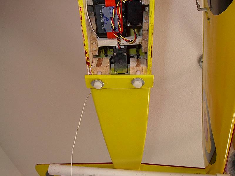

I'm building my first RC plane (BUSA Smoothie) and am nearly finished. Before I cover it I decided to check out a few things, the first being how the wing mounts to the fuselage. The kit has two nylon bolts going through the TE into a 1/4" hardwood peice. I used thin CA to strengthen the threads, but I'm wondering about using some type of blind nut. Additonally, the head of the bolts dig into the TE a little bit when tightening, should I use a metal washer to prevent this?

I have mounted the wings with hardened threads and with flange nuts. I never had a problem either way. I used nylon washers under the heads of the bolts and they helped to reduce the compression but did not eliminate it.

One of the things I have seen done is, glue a piece of 1/64 ply in the area around the wing hold down bolts. Another is using a pin, punch holes (not all the way through) around the bolt hole area, then coat with thin CA. Either one should reduce the compression of the balsa.

To answer your question, no, you don't need blind nuts. The tapped holes in the plywood will be plenty strong enough.

The trick thing to do is either the ply plate flush with the wing surface, or you can get a 1/2" dowel or 5/8" and bore a hole through the center for the 1/4" wing bolt, now bore the wing mounting holes out to accept the hollow dowels, sand flush after gluing in place. The ply plate is soo much less work though. The CA soaked threads will hold up for almost ever.

I just drill and tap the hard wood mounting block and harden with CA, never really had a problem and if I ever did then there is enough wood left to redrill the holes and install the brass thread inserts.

I would just drill and tap the mount block also, But if you do choose to use blind nuts use only a nylon bolt! A metal bolt will vibrate loose, I almost lost my CGM Sukhoi becuase I was'nt thinking and used metal bolts!
