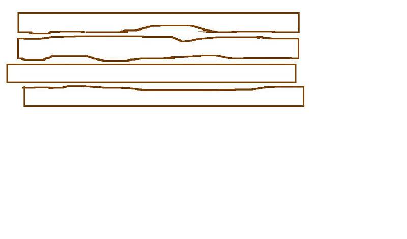

One thing I do is make sure EVERY long edge where the sheets will be glued together is sanded on a LOOOOOOOONG sanding box. If the edged of the sheets aren't true when you tape or glue them together, it makes warps in the finished product.
Pics:
1st sheets will glue together along the seams and lie down flat on your wing.
I exaggerated the curved lines on the edges of the 2nd pic. These sheets might glue/tape together somewhat flat on the bench. But they will warp and bubble up on the foam cores.
Edge true all the sheets, with a long metal straight edge, or a long sanding block (4 or 5 feet long) before assembly. It makes a better finished product.
Pics:

The principle is pretty simple. What most of us don't realize is that the vertical structure (ribs in the case of built up wings, foam in the case of cores) of a wing is almost completely unnecessary.
Think about the forces on a wing...
Is there any 'crushing" force from top or bottom? Hopefully not!
There's a lifting force from one side or the other, but the wing is free to move with that force (lift the airplane)...so there's no resistance.What about bending forces? Well, let's remember...a rib in a built up wing is going to do NOTHING to stop a bending force. Pull up on a wingtip, and the rib is parallel to the bending line, right? It can't do a thing to prevent that bend, and indeed might even encourage a break right at its attachment point, depending on installation/engineering.
There's SOME merit to the idea that a "twisting" force is handled, at least in part, by wing ribs or the foam core...but considerably more is handled by the leading and trailing edges, and the spar. The critical element to this is the fact that they're all tied together, making a "frame". The ribs server this purpose in a built up wing.
In a sheeted wing, however, the SKIN serves exactly the same purpose! So long as the LE, TE, and spar(s) form a "wire frame" if you will, they'll create a box that's very difficult to twist or break. Nothing says the elements tying them together have to be inside the wing.
So...again...it's down to obsessively saving every ounce you can. Honeycombing (or as you said, fenestrating) the cores simply removes un-necessary weight. It's a pretty low "bang for your buck" process, since it takes considerable effort to save just a few grams, but there's certainly no reason not to do it. Give me enough foam to hold everything in place while the epoxy cures, and I'll built a strong wing.
