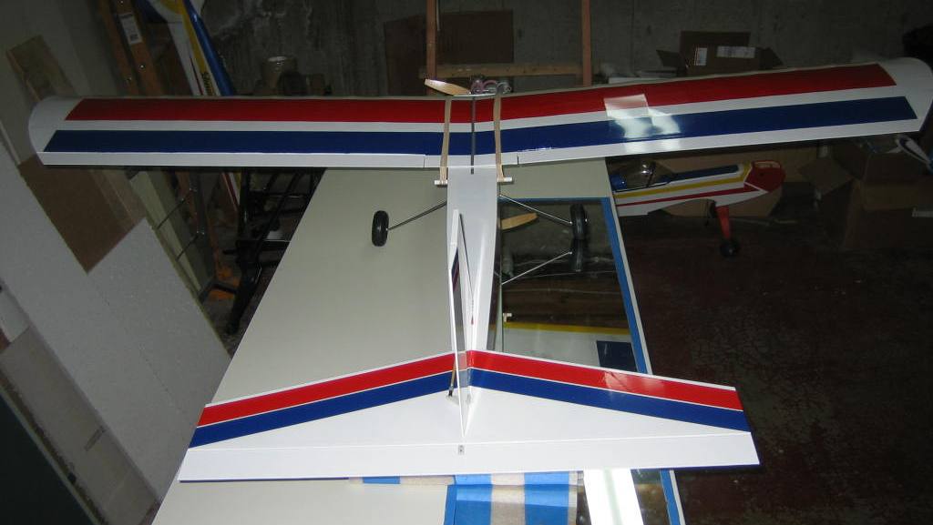

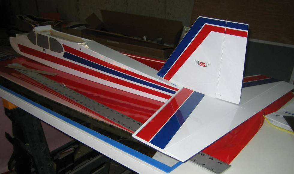

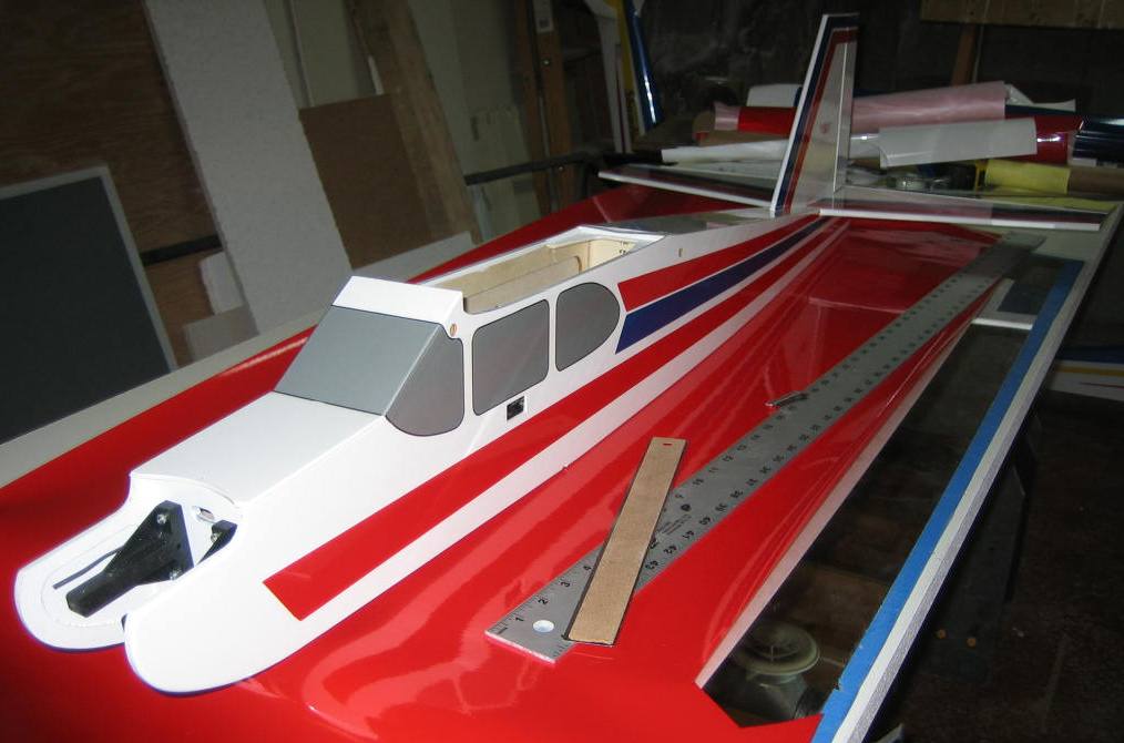

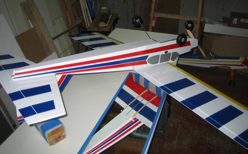

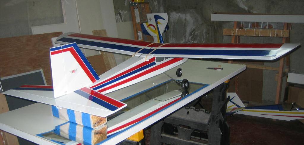

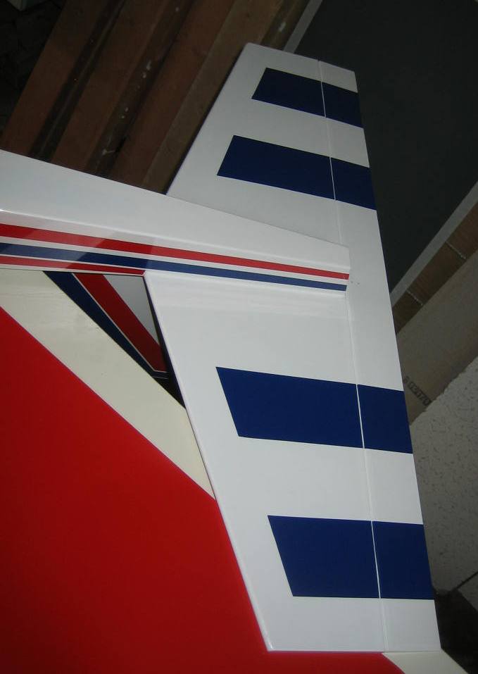

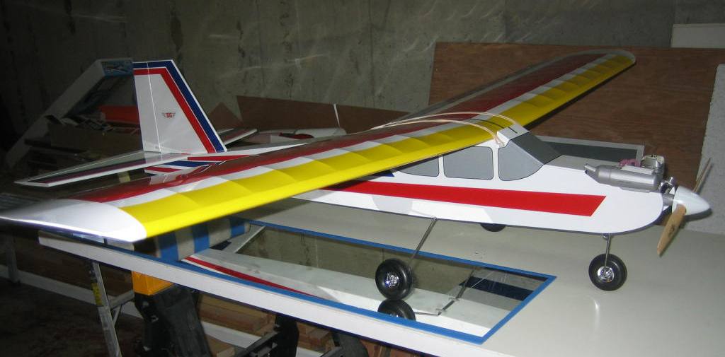

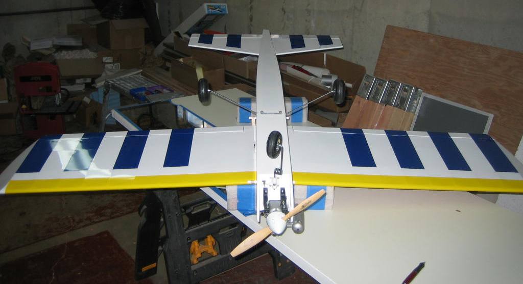

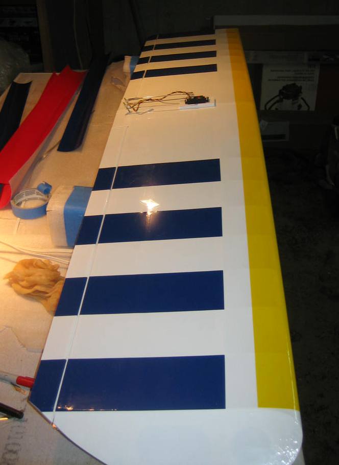

I just finished my LT-40 kit. SIG's website suggests a flying weight of 5.5 to 6 lbs. Mine came in at 6.5 lbs with an OS 46 LA for power w/ MAwood prop. Only other replacements from OEMare Dubro plastic spinner and Sullivan Gold-n-rod (yellow/blue) pushrods for the elevator and rudder. I'm using a Spektrum 1500 mAh NiMH (3.7 oz)battery, AR6100 Rx, Hitec servos. Covering is Ultracote.
And, it's gonna get heavier because as it sits (only things to do are balance fore-n-aft and set the throws) it rests squarly on its butt! Too bad it's not a taildragger - thought about it but it's gonna do club training gigs.
In the upright pics the tail is supported by a foam-covered 4x4. Em, might make a good anchor ...
Comments?

I had the same problem and had to put 5oz of lead in the nose to get the plane to balance. It flew like a dog with the 46LA. I swapped it out for a 46AX, pulled out the lead, and it was a totally different airplane.
The 46AX should be the minimum for the LT 40, in my opinion.
cvause - Makes sense because the LA weighs 12 oz and the AX weighs 17.4 oz.

Where are you checking your CG. it shows 3 1/2 to 4 1/8 from leading edge of wing. Great Job on the plane I just can't see where you put all the weight. The 82 will work and with the battery under the fuel tank next to the fire wall All you should need is 2 oz.s maybe a little more it will still fly great in the 6lbs area.
Larry K
Larry K
LW - the current CG is approx. 5 3/8" from the LE. It is so tail heavy that it rests on the main wheels and the tail. With 14.5 oz at the firewall the CG is at 3 5/8" behind the LE. Which is fairly close to the "beginner" location. Since this is going to be used with novices on a buddy box that is my goal.

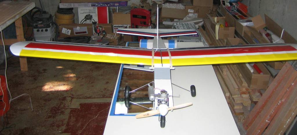

Mine balanced with no weight added, the batteries were located under the fuel tank and the servo's were as far forward as possible. You could put this plane into a slight breeze at 1/4 throttle and it would almost hover there. I can't see flying this plane with anything over a .46
I sold the plane to a buddy and taught him how to fly on it and he finally destroyed the plane after a couple of years and throwing it around like a sport plane.
Anthony
My head is really really really hurting! How can my kit built LT be so exceedingly tail-heavy? Time to get out a hammer and put the piece to rest.
