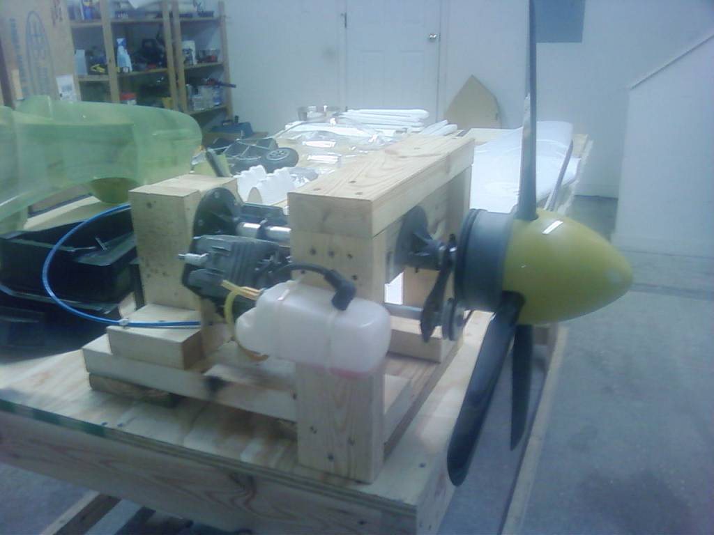

How about some more close up photos of the engine/prop drive setup. It has peaked my curisority a bit.Some details of the drive arangement also, please.

Here are some close ups of the drive unit I have mounted on the test stand and a scanned copy of the Installation and Removal Document. The only difference is that my unit doesn't have the Idler pulley. They eliminated that pulley prior to my kits production.
The reduction drive allows you to swing the the huge 4 bladed prop at 3000 RPM to give you that real 51 prop whoosh sound in flight not to mention that great big 4 blade look.

Very good to talk with you tonight. Looks like you have this thread well on it's way. I like your list of mods and agree with your plans, but I was wondering about the replacement drive shaft. Do you think the flexible nature of the hose coupling in the drive system serves a purpose other than absorbing minor alignment issues? I am just wondering if it might provide some type of necessary shock absorber function. Testing of a custom solid shaft will answer that question, but I wonder if vibration or durability will be improved or degraded by removing the semi-flexible coupling with the engine. I am no engineer so I have no idea, just wondering.
I envy your gear, mine are the original air up, spring down affairs. You are lucky to have the air up/air down arrangement. Those brass air cylinders should be more durable than the 30 year old brittle plastic ones that came with my kit.

<div style="margin: 0in 0in 10pt"><span style="font-size: 9pt">I was thinking the same thing on the drive shaft Forest.There has to be a good reason for the rubber adapter. It could be there for engine protection in case of a crash or to be able to adapt the different engines they used (or planned on using).
IT could also be there to help with any slap knot at low RPM to help reduce that vibration problem or keep that low RPM SK from affecting the engine bearings. In any case we are going to find out. I do have an e-mail out to Don Muddiman and Dave Nalley to see if they can get me an e-mail address to one of the Original Byron guys that built a boat load of these things. That will certainly answer a lot of questions. I know they had some modifications that were not for public knowledge.

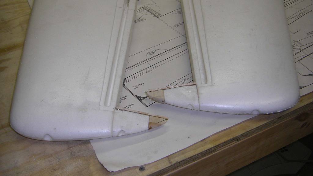

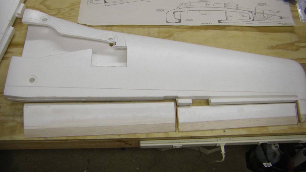

<div style="margin: 0in 0in 10pt"><div style="margin: 0in 0in 10pt">I have looked at the engine that came with this kit. It has two rings on the piston. Anyone know what size it is.</div><div style="text-indent: -0.25in; margin: 0in 0in 0pt 0.5in"><span>A.<span style="font: 7pt 'Times New Roman'"> </span></span>Been out of town for the last week but I am back at the table to complete the 51.
</div><div style="text-indent: -0.25in; margin: 0in 0in 0pt 0.5in"><span>B.<span style="font: 7pt 'Times New Roman'"> </span></span>Retract assembly complete. I found a really good video about using AC compressor oil to maintain and lube the interior seals and help with eliminating air leaks. <font color="#800080">http://www.youtube.com/watch?v=SxUGVuI42MI</font>
</div><div style="text-indent: -0.25in; margin: 0in 0in 0pt 0.5in"><span>C.<span style="font: 7pt 'Times New Roman'"> </span></span>Ailerons and Flaps built. IF you notice I have a blue piece of tape on the foam part of the aileron. I used the 3M product to safeguard the foam while sanding the triangle stock. Its really tough stuff and has the perfect adhesion. I also us it to hold things together while glue is setting. Epoxies don’t stick to this tape very well. Makes life a little easier.
</div><div style="text-indent: -0.25in; margin: 0in 0in 0pt 0.5in"><span>D.<span style="font: 7pt 'Times New Roman'"> </span></span>Cut off Aileron tips, glue to wing and sand and shape wood corners.
</div><div style="text-indent: -0.25in; margin: 0in 0in 0pt 0.5in"><span>E.<span style="font: 7pt 'Times New Roman'"> </span></span>Cut out for Aileron counterweight completed. Foam is easy to cut. I did make a mistake here. The plans ask to start the cut 2 inches from where the nylon hinge bracket will be located. I have included a picture of where it is supposed to start. I had to re-cut and glue back a 1 inch piece of foam. (Stupid) That’s what I get for not paying attention to detail.
</div><div style="text-indent: -0.25in; margin: 0in 0in 0pt 0.5in"><span>F.<span style="font: 7pt 'Times New Roman'"> </span></span>Cut out for retracts complete. Don’t make the mistake I made on this. In the first steps of the plans it tells you to sand a smooth surface on the wing to install the gear mounts. THIS IS FOR FIXED GEAR ONLY. It was too late. I sanded one wing. The dotted line to follow as you cut out the foam for the retracts was eliminated. I was lucky to have the other wing intact so I cut it out first and traced the cutout onto the second wing. Whew> I started to cut it out with a metal cutting small tooth blade but a new exacto blade is the ticket here. Very easy. I traced all the lines with a fine point black marker to help insure the cuts were straight.
</div><div style="text-indent: -0.25in; margin: 0in 0in 10pt 0.5in"><span>G.<span style="font: 7pt 'Times New Roman'"> </span></span>NOW I HAVE A PROBLEM: Plans ask for 4 wing hold down pockets. Two front and two rear. I only have one of each. Other two are missing. Rocky said he never saw them either. (I will be checking hims feces later tonight) I even went back and checked the original pictures I posted and they aren’t their either. Hmmmm. The search is on. Anyone know where I can order some or am I on a mission to make them?</div><div style="margin: 0in 0in 10pt">Plane and plans are very easy to understand so far and I am going to continue building while I ponder the missing wing hold down pockets.</div><div style="margin: 0in 0in 10pt">Tonight I am installing the Nylon Bearing and Torque Tube Support, Hinge Covers, and Counterbalance. (If I can learn how to read and stop making stupid mistakes.)</div><div style="margin: 0in 0in 10pt">Rocky is fast asleep. He was up all night sanding the ailerons and flaps. Good dog.</div></div>

Hi Fred, looking good! I don't have any answers for you, but I do have a question. On those wing bolt pockets you are looking for, do they just glue in snug against the foam at the bottom of the well? I ask, because when I pull mine tight the wing sinks in around one of the rear bolts. I did drill mine out to fit 1/4x20 bolts and pulled an aluminum insert out of one of the holes. I put it back in, but wondered exactly what I was dealing with, since I didn't build the wing.

No they don't They have four sheets of fiberglass installed to secure them. I haven't bothered reading the rest of the instructions since I couldn't find the other two but its quite a little process. As soon as I install them I will give you plenty of pics throughout the process. This is all done prior to fiberglassing the wing. I wouldn't want to have to dig them out. I don't think you could without doing a lot of damage to the foam.
On another note, I was beginning to cut out the hinge covers with the included hardwood. You need a 1/32 x 14 inch x 42 inch piece and that only gives you a half inch to spare to make all four wing covers for two flaps (top and bottom) and two ailerons (top and bottom). I have a 1/32 x 12 inch x 40 inch in the kit. I don't know if this was a mistake or its used for something else but I hope this isn't a preview of things to come. They either put in the wrong size or its missing. Off to the hobby shop.
