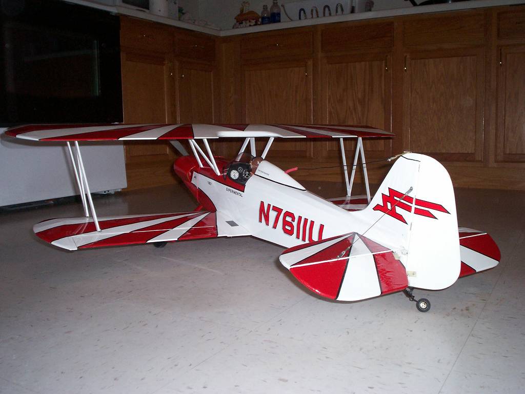

I built two Hog-Bipes which both flew great from the first take-off. The kit goes together much quicker and more easily. The kit includes parts and instructions for dual aileron servos which I recommend. After modifying the first to take a round cowl I liked the stock open front end as well. After building the first one stock in every other respect, the second one had the bottom wing dihedral reduced by about half and the rudder and elevators widened and the vertical fin reshaped. I was very happy with the flight characteristics of the second. It would stall turn beautifully and do an inverted spin so nice. It also taught me to circle the field in knife-edge. Personally I think the airplane is designed for .91 4-strokes, I like the Thunder Tiger and O.S.
There's quite a few Hog-Bipes displayed at fuberhill.com with tips and modifications.
I'll agree with Ilikebipes, also like biplanes and think the Hog-bipe makes building and operating one about as easy as could be. If you take the time saved in building and put it to doing the sunburst color scheme with pinstriping it'll be the envy of your fellow modelers. Here's mine in green Ultracote with my Jungmeister. Best wishes with the Miniplane, and the Hog if you get one!

Ilikebipes, with those beauties in your fleet the Jungmeister would just sit in the hangar.

What a great looking Jungmeister. I need to get one of them going for myself.... I have always heard they fly so good.

I WANT YOUR JUNGMEISTER!
