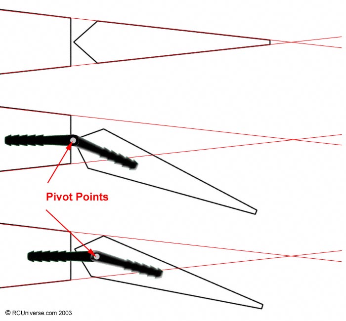

Hello,
After fitting the hinges between the wing and the ailerons, I see a thickness difference of approx 1/8 th inch difference between the trailing edge of the wing and the leading edge of the aileron. The trailing edge of the wing is a little over 1/4 inch and the leading edge of the aileron is 3/8 th inch. Do all these kits come like this ? If so does everybody leave it alone, or do you sand it to match the trailing edge of the wing. Or does everybody leave it alone, and how would it affect flight. Thanks in advance.

Pat, the aileron is supposed to be thicker. Do not sand it. Aerodynamically, it is supposed to expand the "flight envelope" i.e. the minimum controllable airspeed is lowered, and also to reduce flutter. I still seal all my hinge gaps with clear monokote to prevent flutter.

Not having access to a wind tunnel and associated gear I can't give you any pictures.
In level flight having the LE of the aileron thicker than the TE of the wing increases drag just the least bit.
Where the real advantage lies is with surface deflection.
With the surface deflected down the top of the aileron is then lower than theTE of the wing, the airflow has to "Step down" to continue following the surface. If the aileron thickness is sufficiently greater than the TE of the wing the air can flow straight to meet the aileron LE.
Maybe Minnflier can give us a graphic.
Bill.

The difference is in the hinging, and the gaps.
If you use Robart Hinge points, or similar, the surfaces can be hinged in a manner such that the surface LE has no effective drop on deflection, and then the thicker control surface gives only more drag, and not more effective control. To do this the hinge pivot line is behind the LE of the control surface.
Using "Skin" hinges, and a stiff skirt over the gap on the bottom, a la RC racing planes, again there's no advantage.
You mentioned the full scale planes. I don't know of any jets or fast prop planes that don't have the leading edges of the control surfaces in front of the hinge pivot line, this keeps the LE pretty much even with the TE of the wing.
You also have to remember that the gap on the full scale planes, with the inset hinges, is a very small fraction of one percent of the wing chord. On our RC planes, with conventional CA hinges, the groove in the surface is huge in comparison.
Or for an example of a full scale plane using the surface "Bump" trick, look at the vertical fin and rudder on a FW-190. Note the notches for the rudder hinges. When deflected to the right, the LE swings out, just a bit, to the left.

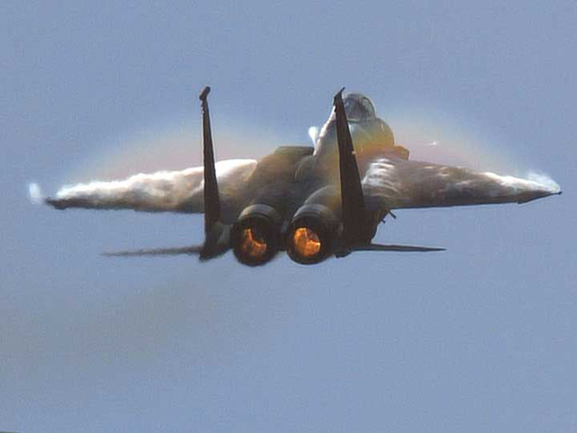

Just one more note, airflow vortices affect big planes too. Loook at this picture.
That's not ice. It is moisture condensed by the pressure induced temperature change fliying at high alpha.
Bill.

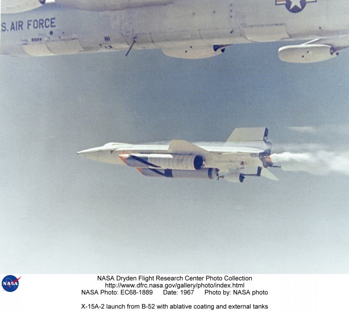

Just one more note on the blunt trailing edges.
Look at the pictures of the X-15. Specifically the vertical fin.
Its thickest point is the trailing edge, and no one can deny it was a fast plane.
Bill.

Just a couple more notes.
When a control surface is hinged to protrude on the side away from the deflection, as on the FW-190 rudder, the protrusion works as a turbulator.
You can do a search on the term for more information, they are commonly used on sail planes for boundary layer control.
Attached picture shows blunt TEs on the X-15
Bill.

Minn: Terrific diagrams as usual!!
My Robart hinges are installed close to what you have on the diagram at the bottom. My hinge points are "not quite" as deep as the ones pictured, but the bevel has to be completly notched out in the aileron for the hinge to flex. I should cover my gaps..... but this method works great, and the gap is very narrow. Thanks again to all....
lownslo... Bob
