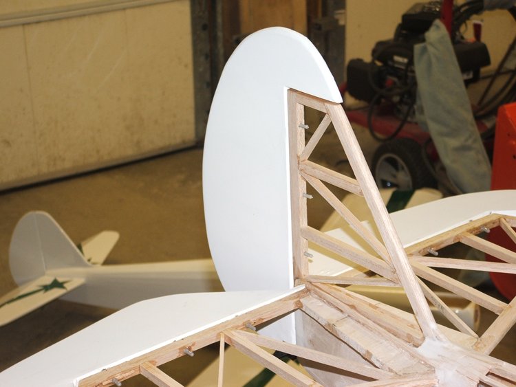

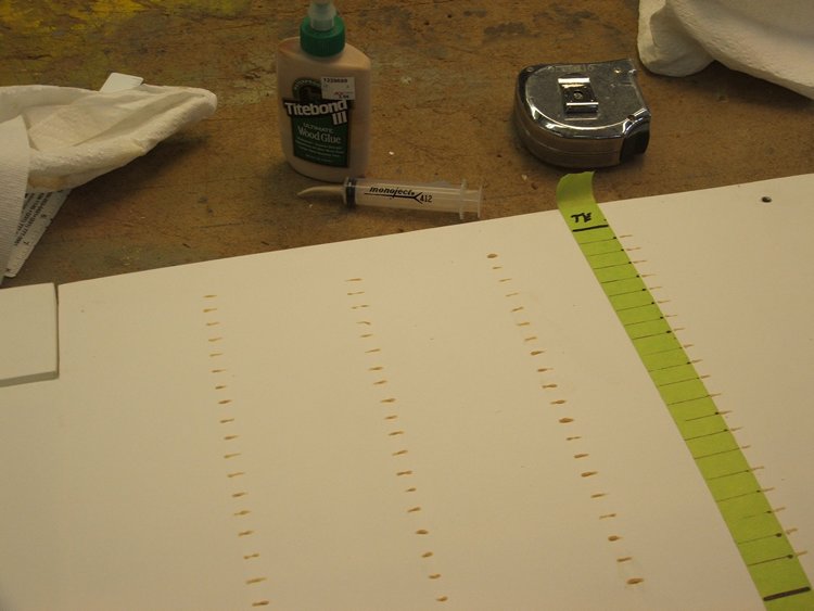

Default RE: painting

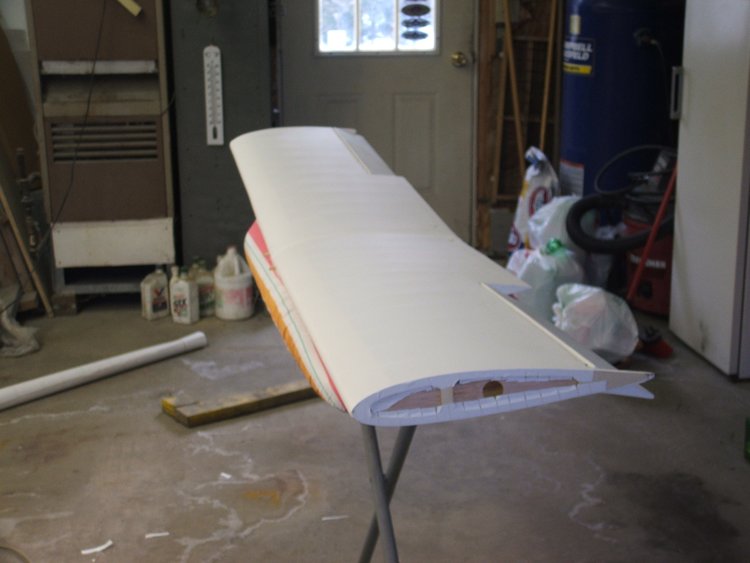

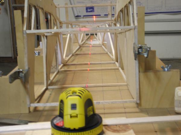

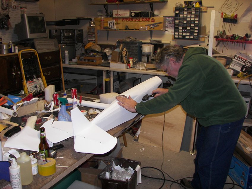

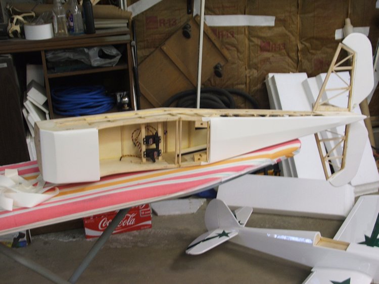

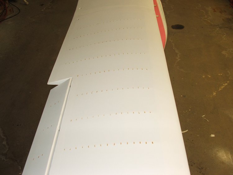

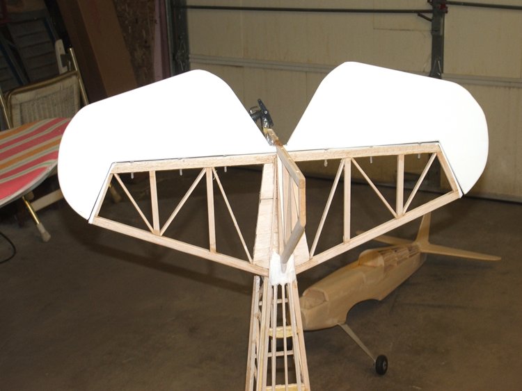

Dennis, to me, using Solartex is the same as applying a plastic film, only easier.
Sorry. Don't have a vid, but here's a few pics.
