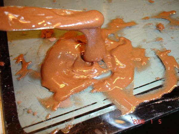

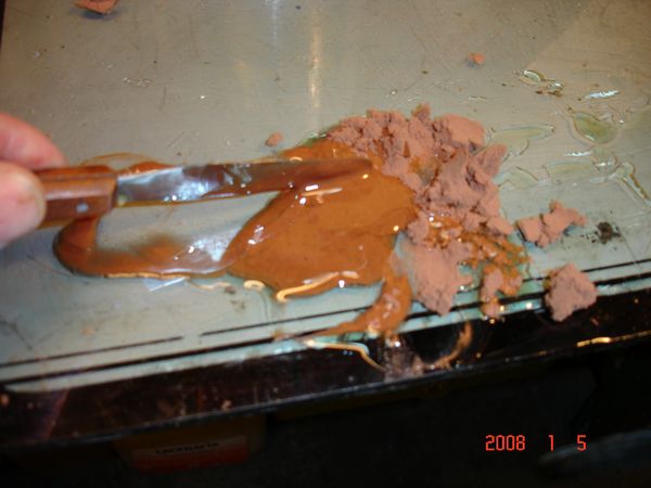

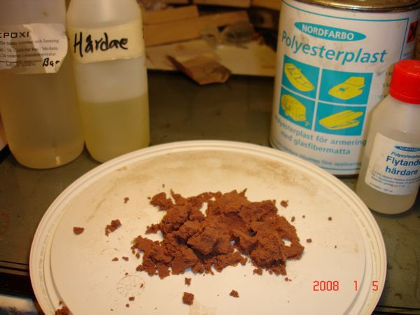

Default RE: micro balloons
Hi!
No! White glue or aliphatic glue doesn't do a good mix with micro balloons!
In a store that sell paint!
But...professional 24hour epoxy is tougher than polyester resin!
Brown colored micro balloons is best, those are made from plastic! Much easier to sand than white (made from glass) micro balloons.
