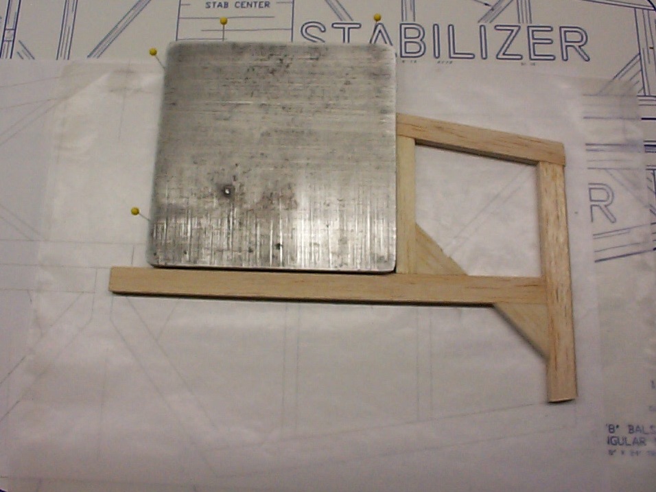

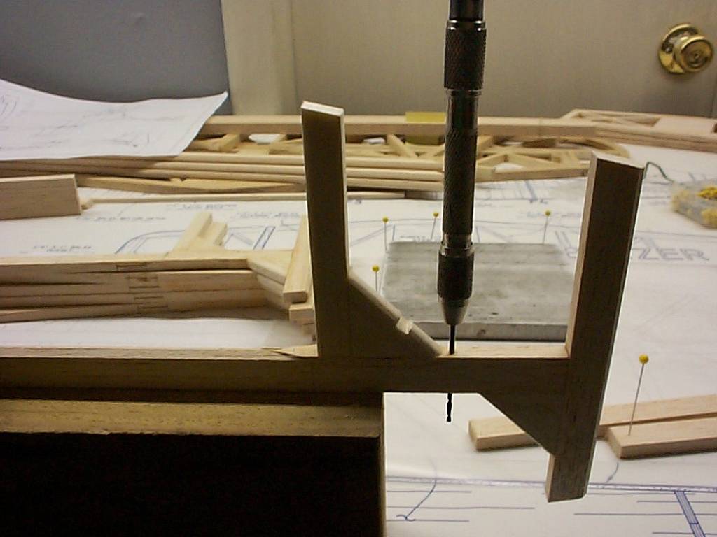

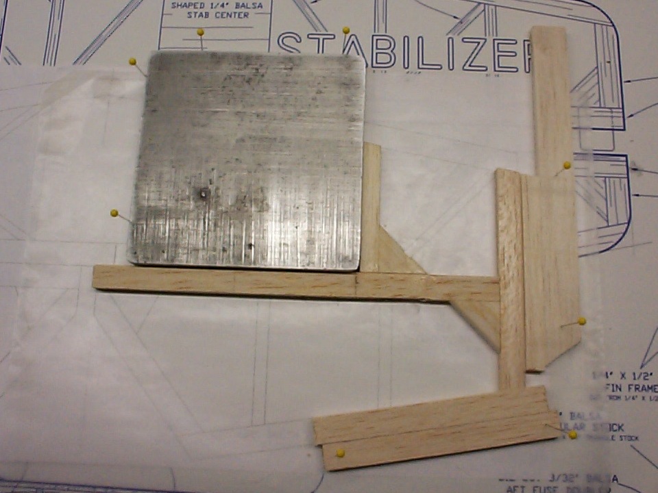

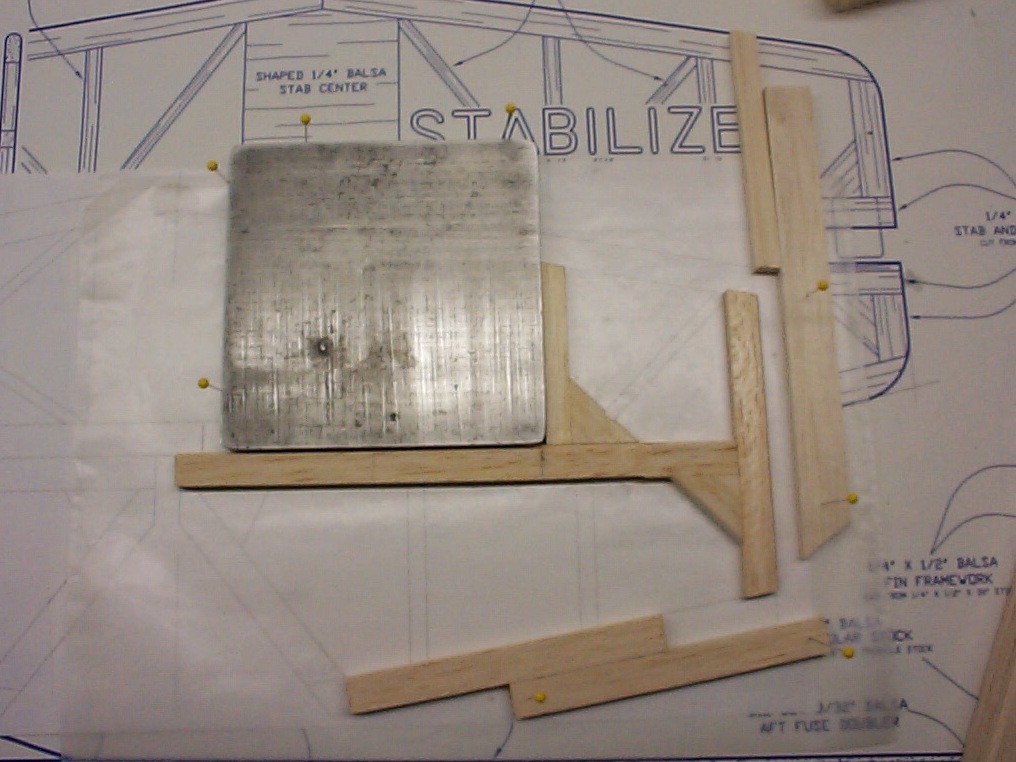

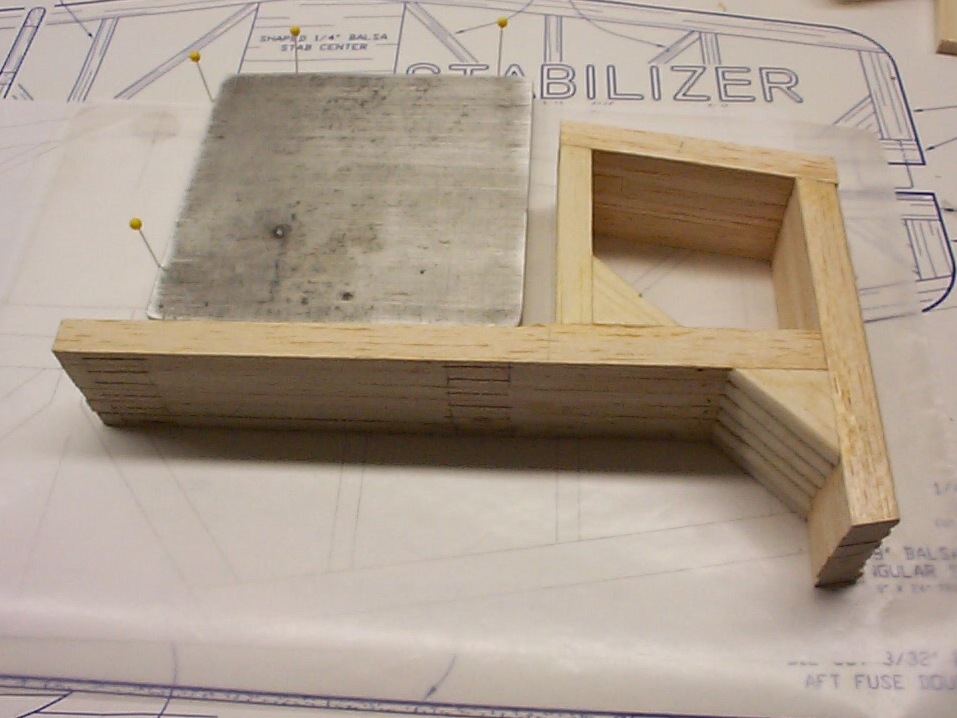

Well, staying consistent with what I have been posting on this build here are some more pictures of the progress.

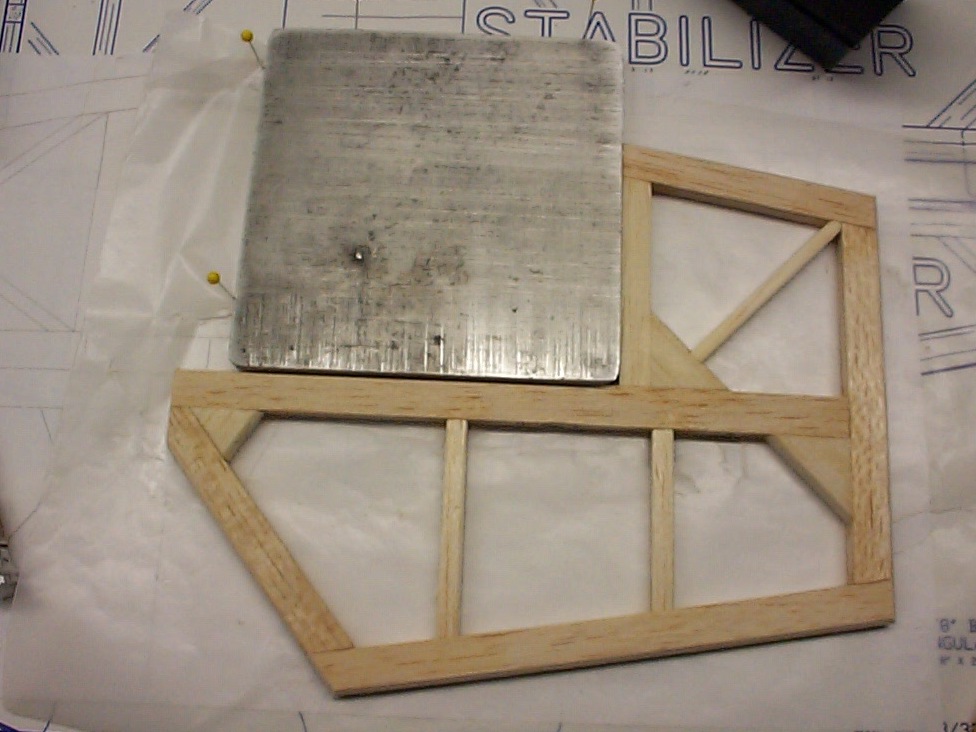

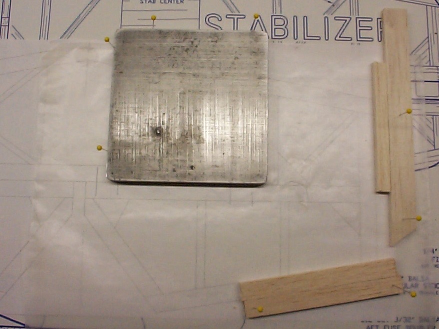

1- My “jig” for building the 6 elevators.
2- I glue up two pieces of the 1/4 X1/2 that already have the triangle gussets glued to them as I did in a earlier post with rudder parts. Also lined up and glued the elevator "tip".
3- Two parts of the jig slide out of the way so I can remove what I have glued.
4- At this point I drill a vent hole in the elevator spar so the counterbalance can vent in covering process.
5- At this point I finish fit the leading edge of the counter balance and glue them on.
6- Got them all done to this point. Confirm everything is the same size.
7- Then I finished off all the parts. Just like in the rudders and such I vented the cross braces in the elevator.
8- These are the hinges I am going to use. Gave all the parts a rough sand and finished fitting the hinges.
9- Three tails ready to go.

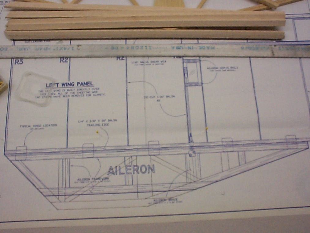

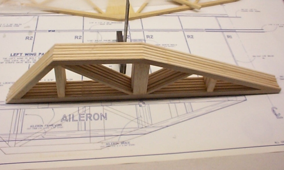

I’ll keep the basic shape of the stock ailerons except I’ll be adding 1” to the chord as you can see in picture 1. In picture 2 I have set things up for production of six ailerons as close to the same as I can get them. I have all the parts for the first one cut and fit with out glue in picture 3. I’ll use those parts to rough cut everything for the other five ailerons. In picture 4 you can see that I will be moving the aileron servo’s out roughly one bay. I have “X”ed out the rib that I will move and drawn in where I will put it.

Those ailerons ar huge! I will be interested on how it flies, im sure it will drastically slow the aircraft down with massive control input. Looks real good!

Nice looking aileron. If I remember correctly, the stock servo location allowed me to reach the RX without an extension. Will you need to use servo extensions to reach your aileron servos?

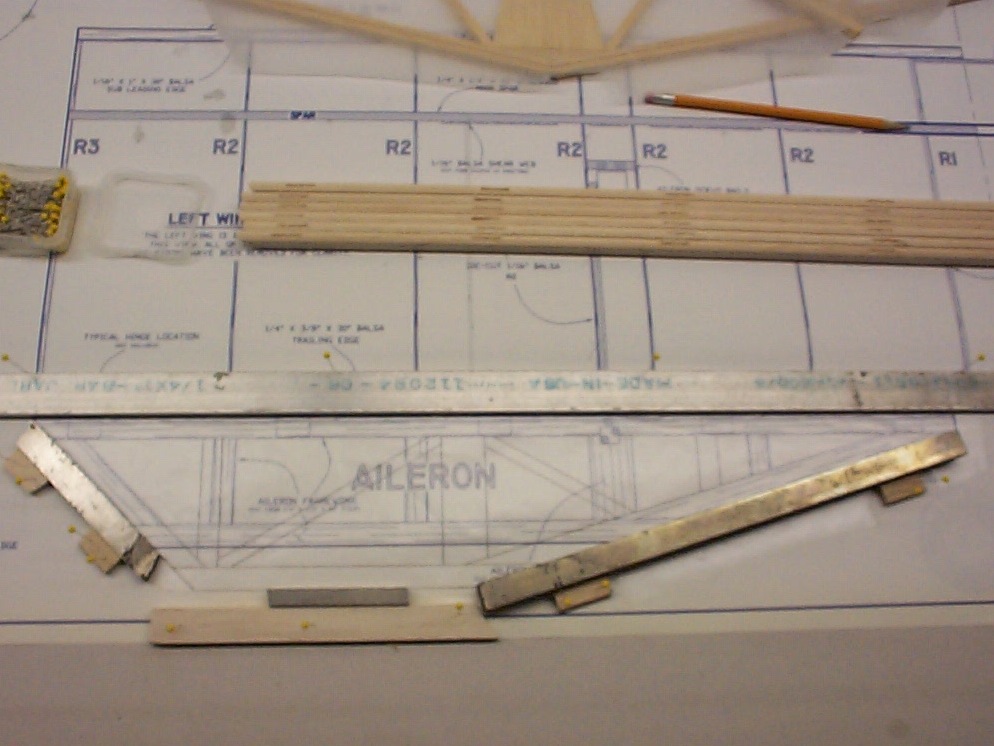

With the servos I plan on using, I was going to have to add wire (an extension) any way. I will actually cut/splice/and solder wire instead of using an extension on these. Particularly since the wing will be non-removable.
As big as this aileron mod may look, it is still proportionately smaller than the airplane I am using as a pattern, to keep my ideas in check with something that works.
Remember I plan to prop these planes for slower flight with a lot of thrust. So, the Idea with the bigger ailerons is more control with less deflection at slower speeds. That is the theory anyway.
At the same time I will admit I have mitered all the control surface hinge lines to handle 50° of deflection just to see where all of this will take us. The three of us that will fly these have completely different flying disciplines and it will be interesting to see what we get out of these planes.
At the very minimum they will be a blast.

I’ll keep the 12.25X3.75 APC props in mind. But what I plan to use after getting the engines broke in is the APC 13X4 wide props. I have tested these on my engine stand (with scale) and they pulled around 7lbs of static thrust with one of my other Super Tigre 51’s.
I’ve posted a few pics of the finished ailerons. Not much to write about that I have not wrote already. I pretty much did all the same stuff as I did when building the tail feathers. It sure feels good to have them done I can guarantee it.

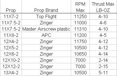

If I have learned nothing else here of late, I have learned that my memory sometimes ain’t so good[
Anyway, while at the flying field today I was going through my notes and this picture is of what I have on the prop test with a Super Tigre 51.
I have no idea where or what I was thinking 7lbs of thrust. But also it was a Zinger 13X4 I tested and not an APC wide.[X(]
]. Anyway, while at the flying field today I was going through my notes and this picture is of what I have on the prop test with a Super Tigre 51.

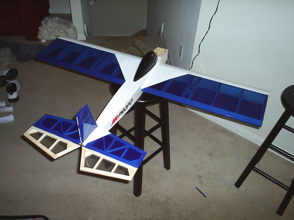

Anyways, got the tail covered, and the elevator hinged, doing clear control surfaces again (did this on the one i built years ago and liked it)
All thats left is bevel the ailerons and hing them along with the rudder, then install my gear

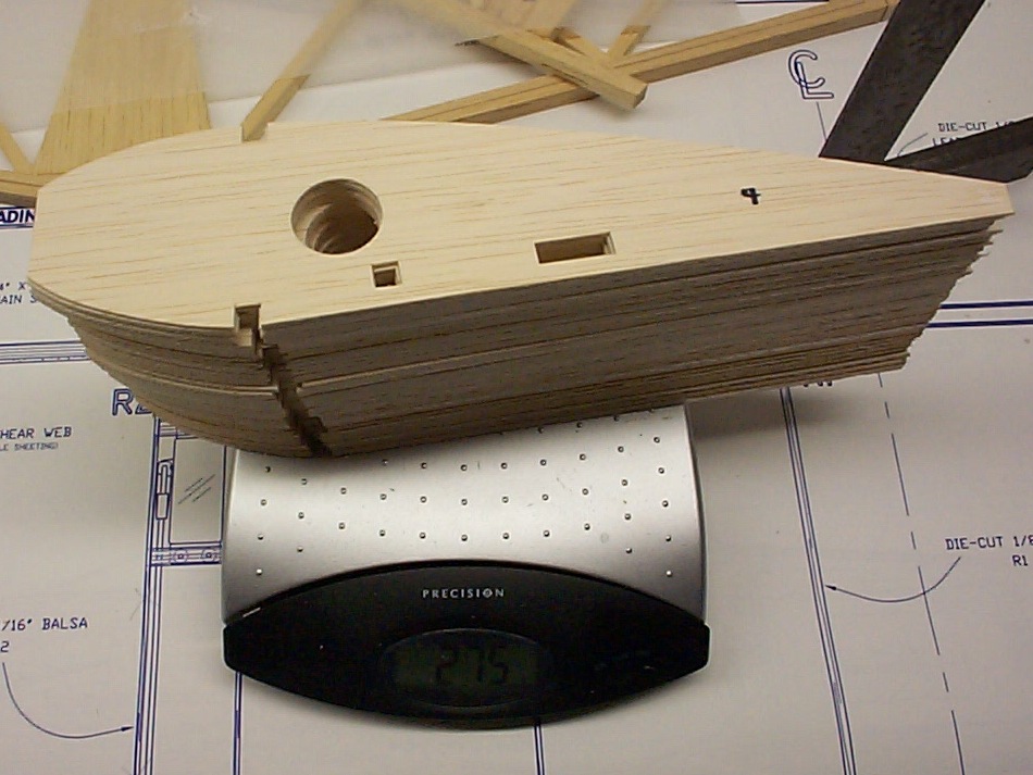

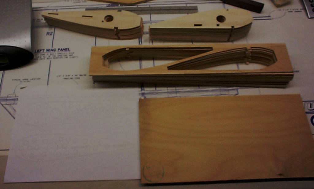

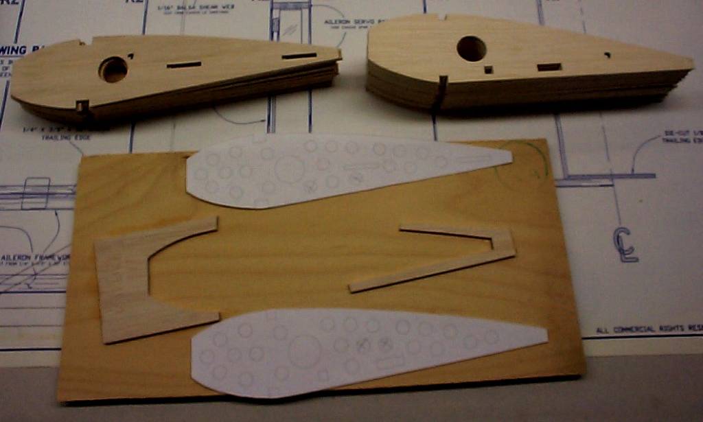

After a week of being out of pocket I was able to get back to working on my Uproar project. I have to say this current mod has me questioning my sanity.
In the pictures it is a little hard to see the patterns on the paper. But, they are there. I made a little fixture using a piece of 3/8 birch plywood I had laying around and one of the drop pieces from the die cut ribs.
Using a forstner bit I set up to drill one hole at a time by clamping the fixture to my drill press table. I drill all the ribs and for that hole and then adjust for the next hole and again cycle through all the ribs until done.
My camera is giving me fits and I still have to clean all the ribs up from punching holes. So, I will get some more pictures soon.
The clear covering on your control surfaces adds a nice touch to the looks. I noticed that in the pictures you posted of the older one as well. Man, I’m not sure what to say on the ribs. They were die cut pretty clean.

I admire your determination, but I think you may be a little bit crazy on this one. Seems like a lot of work to shave a couple of grams. I also think that drilling one large hole, maybe 3/4", in the center of all those little holes would have removed as much weight in one stroke.
I can't wait to see what your ribs weigh after the drilling. My guess is that you are removing about 5% of the rib, so you will lose about 14 grams total. Divide that by three airplanes, and it's about 5 grams per plane. That works out to about 0.17 ounces per plane.
I am enjoying these builds. Keep up the great work.
Edit: My mistake. I was looking at the holes you have already drilled, not your pattern for ALL of the holes you intend to drill. You may be up closer to 25% of the rib material. That would be more like 70 grams total, or 23 grams (0.8 ounces) per plane. Still a bit crazy
but at least you are having fun.
Good luck
