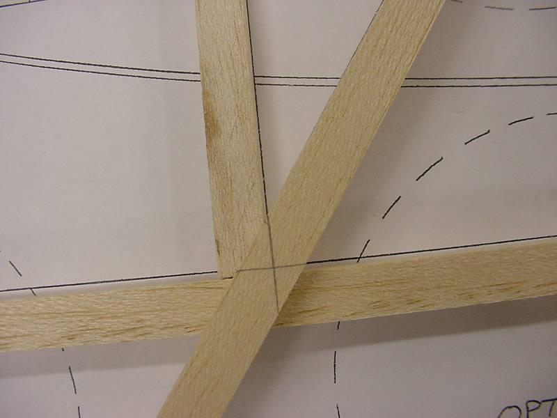

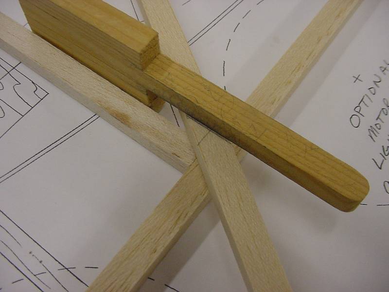

#59
My Feedback: (12)
Joined: Aug 2003
Posts: 207
From: Lawrenceburg,
IN
Hey Dave,
I noticed in an earlier post in this thread you were asking about getting good fitting fuse trusses / miter joints. I've attached some pics here of a method I use that is simple and very effective. Credit for the pics and the very clever tool go to Walt of BuiltbyWalt - a builder extraordinaire! Thanks Walt!
I would also highly recommend the miter saw and miter sanders from Fourmost products - I use them all the time!
Regards,
Bob
Regards,
Bob
