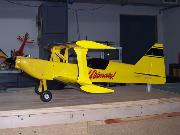

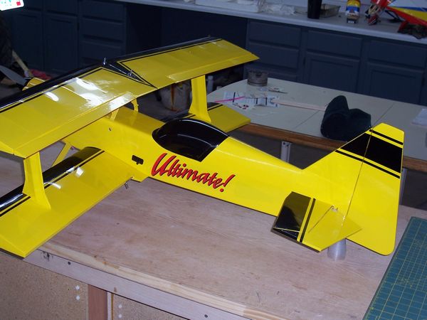

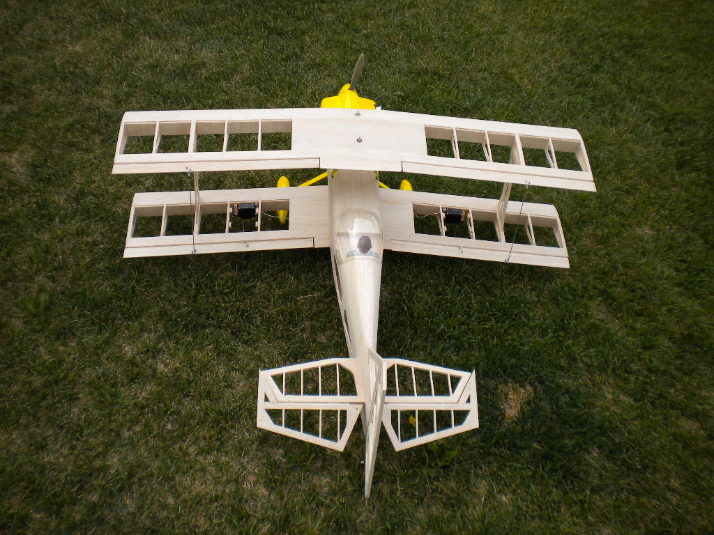

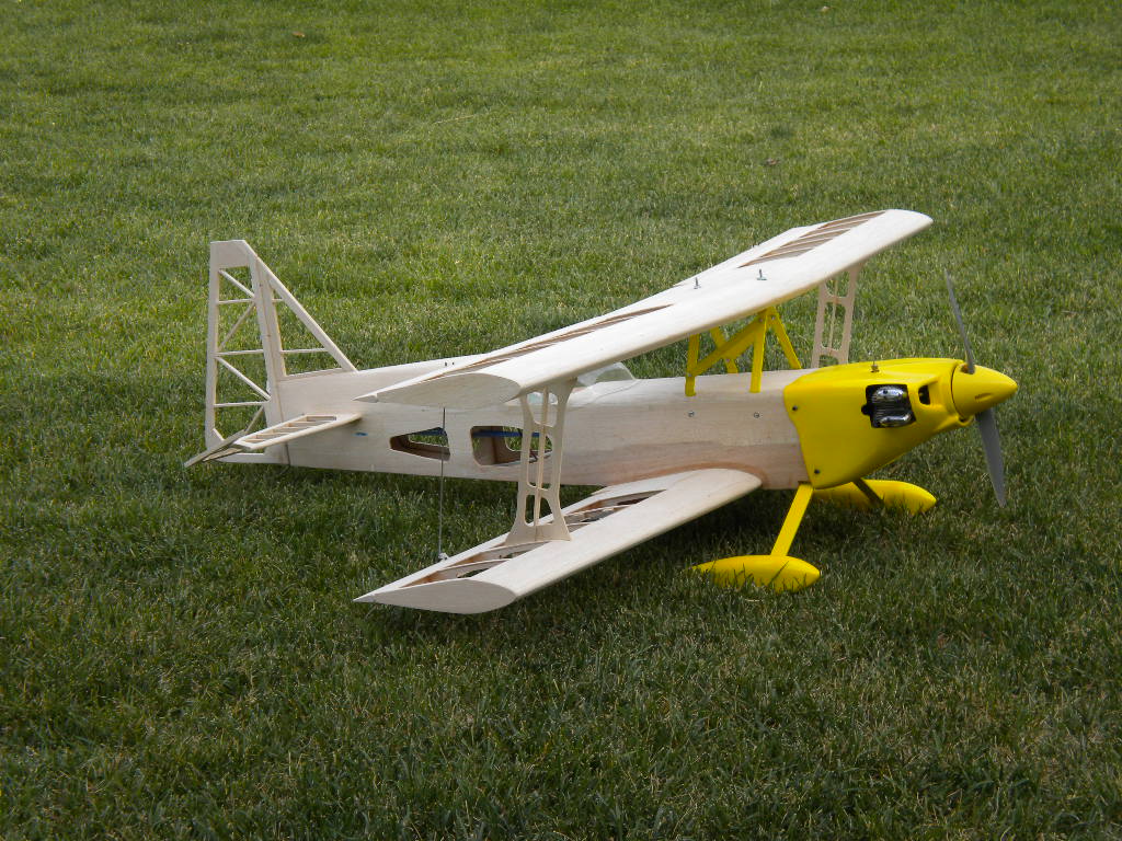

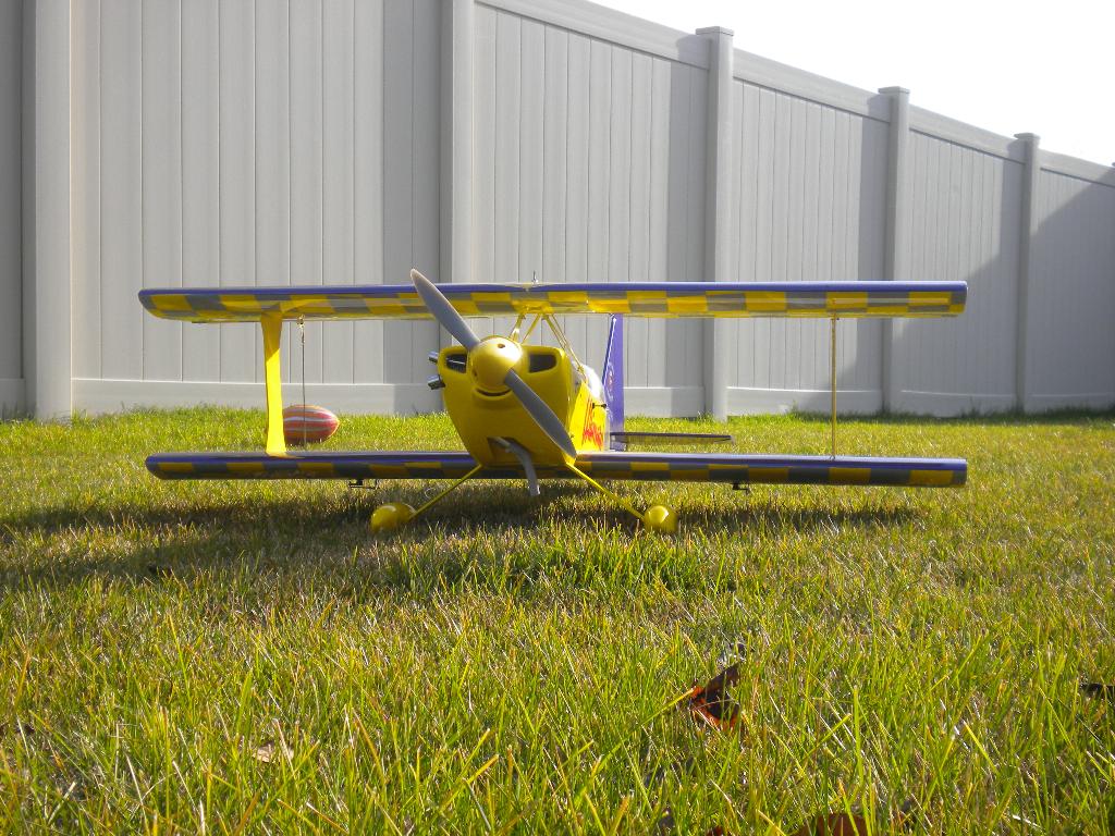

Dang, took me forever to finish this plane, but now its done. Hope to maiden it this week if the weather is good.
Next plane will be a world models midget mustang. Here are some pictures of the final product. This is a Great planes Ultimate Bipe with a saito .65 up front.
I moved a sevo to each wing half instead of the one servo in the middle of the wing. The checkerboard on the bottom of the wings was done by hand using the windex method. Then each square was sealed with trim solvent. Hope ya like.

Put the finished pictures in ! Thems the almost finished pictures !

Looks great !
Is that clear covering ?

Might be kinda hard to fly like that as well....... Dave

Good weight saving technique!

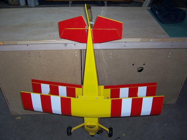

Ooops's Dang pictures didnt download sry

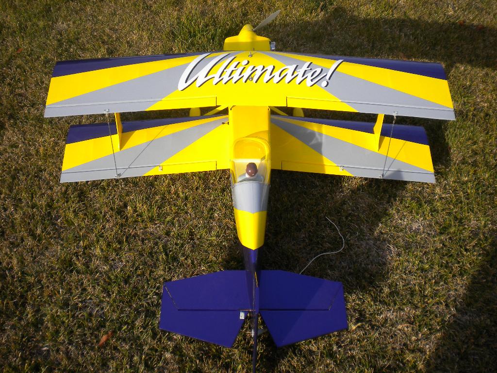

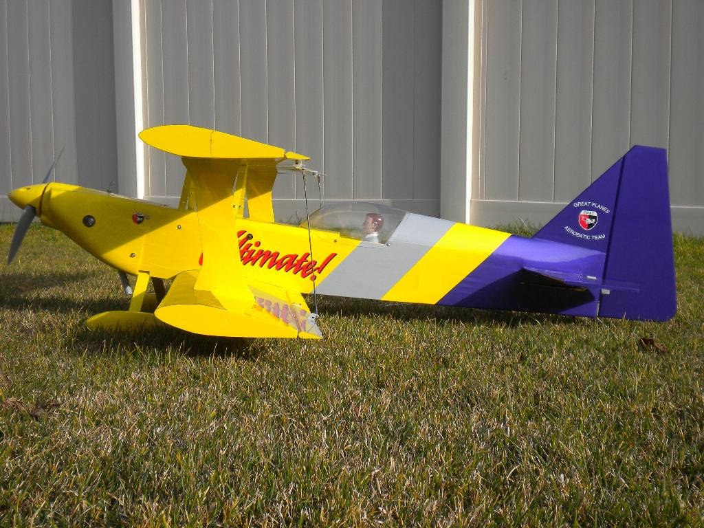

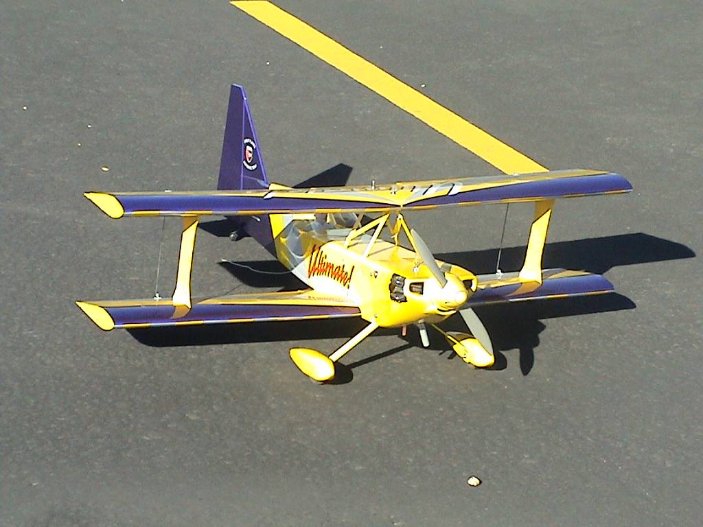

Nice Bipe , Here,s a pic of mine. Saito .72. Thing is a little hotrod.

Looks awesome cant wait to maiden mine

Whoa dragonov - I really really like that covering scheme and color choice. Looks great!

I bet the checkers took awhile. Looks really nice . I did a Slowpoke with checkers and it took me forever ,
My Ultimate does,nt really have any bad flying traits and is one of the easiest of my planes to land. The only problem I have is it gets small fast , just to give you a heads up .

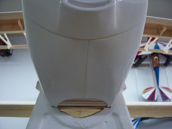

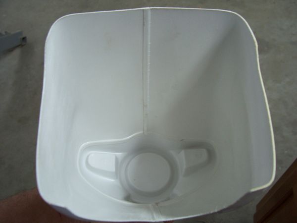

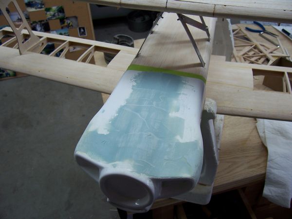

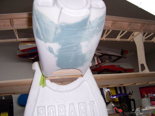

Oldscaleguy ,I had the stock cowl on mine for some time now . I glued it together with thin CA and then used a good grade of lite body filler, not Bondo brand .Here,sa few pics of the cowl. I do custom airbrushing on motorcycles and just usre the automotive primers and thinners, So far it has held up really well.

That looks great. What brand of filler did you use?

I don't think the abs plastic cowl and wheel pants will hold up. i will probably order the fiber glass ones . I also had to re cut the parts for the front turtle deck because the wood for that was so warped i couldn't use it. Other then that, the kit was an easy but long build. Mostly long because I didn't get out to the shop as much as I wanted too.

Evercoat Lite weight part# 100157 . It,s over a 1 1/2 yrs on the plane and still looks good. But , this is the first ABS cowl that has,nt gone to pieces with in a few days of flying. I did insulate the cowl mounts and srews , and this seemed to knock down the vibration alot.

Another thing you can do is to layer thin fiberglass cloth inside the cowl and wheel pants, that adds a lot of strength and durability to otherwise thin vacuum formed plastic.
