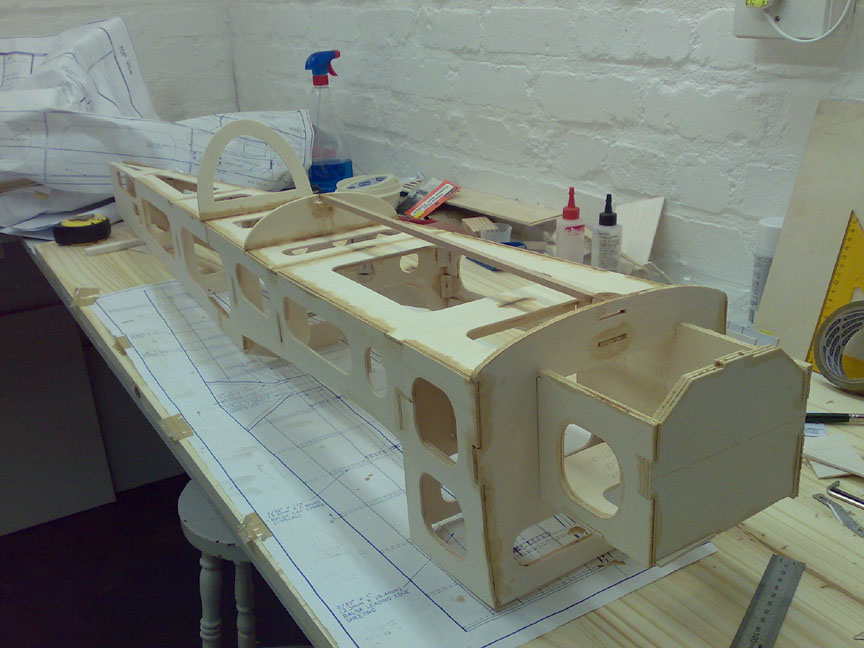

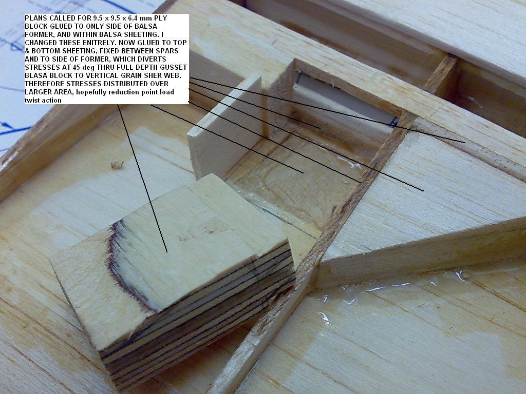

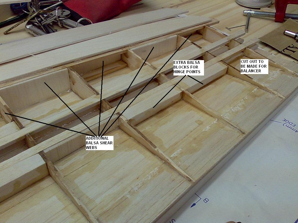

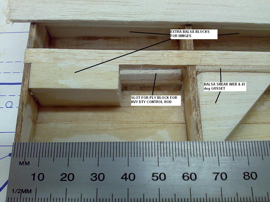

Nice kit, just gotta get back to building it.
Points to note. In the wings and Elevator I have used lots of additional Shear Webs, careful on the balsa grain. Must run vertically. I also used A LOT of balsa triangles throughout the fuzz.After intial gluingI done everything againwith Ultra wood glue (Must be water proof)
Also I did not like the blocks for the horns in controlsurfaces. See my pics

EF,
Aren't you adding too much weight to your model?
Everyone recommends to keep these models light because they end up heavier than spec.
Just a thought.
Old 11-16-2009 | 12:00 AM
Joined: Sep 2009
Posts: 30
From: Cape TownWestern Cape, SOUTH AFRICA
Default RE: Hostetler or Midwest Extra 300XS??
More strength than weight. Using basla and very little epoxy. Mostly Cyno and Ultra wood glue (Water proof) Using Carbon undercarriage, Chief aircraft also sells them. Horn blocks and shear webs definately need strengthening, most elev but also wings.
