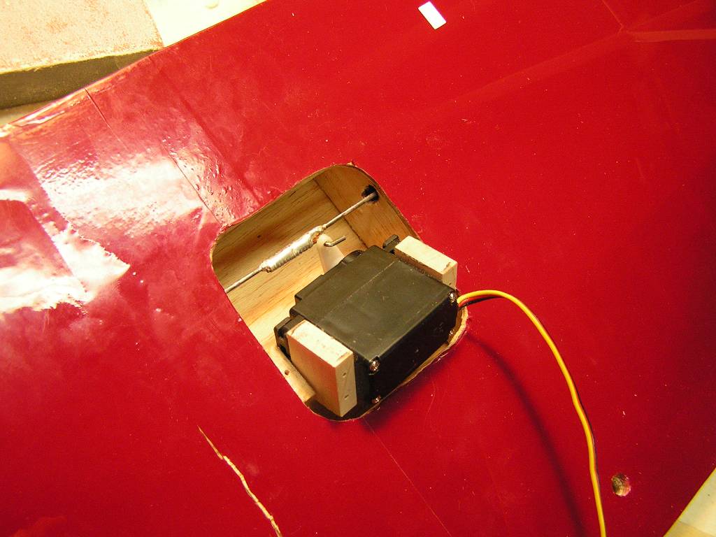

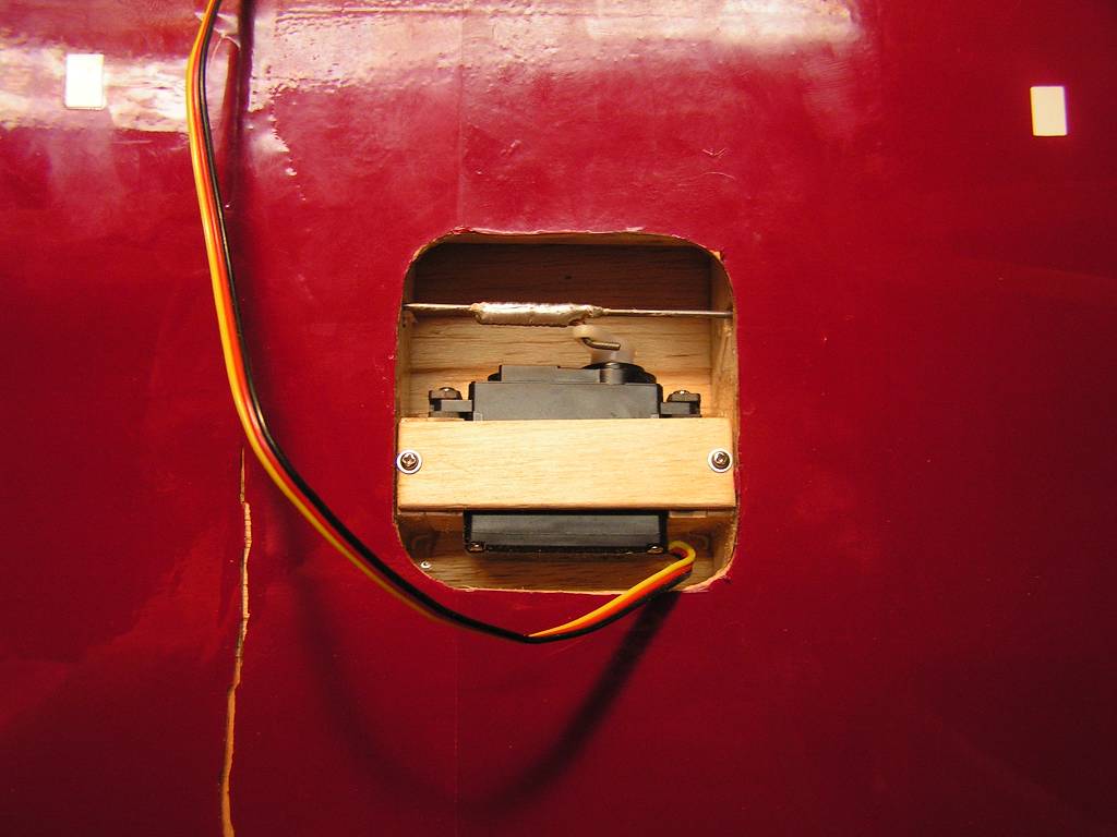

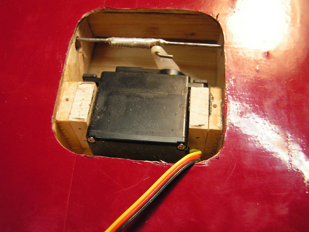

Okay,
Here are those pictures I promised. The servo is mounted to a pair of hardwood blocks in the usual way. That assembly slides into the wing cavity, hooks onto the long pushrod and is held captive by another pair of blocks that are epoxyed into the wing. That has to be a tight slip fit so the servo cannot move from side to side. The rod that runs the length of the wing and and hooks to the belcranks helps to keep the servo in place forward and aft. The servo is then held down by a plywood strap and two servo screws. Simple really.
Oh, the crack you see in the wing came from an incounter with the ground during a stall on a take off. Be very careful boys, this is a touchy aircraft.

Senrak, that looks much nicer than what is described in the manual. My manual says to glue a sheet of wood (I think it was plywood, but don't remember now) to the underside of the top wing sheeting. Then, I am supposed to screw a plastic servo tray onto the plywood. I'm not sure if the servo tray was included with the kit as I didn't have time to look for it last night. I'll do that later.

Thanks for the pictures Senrak! Very much appreciated! So just to clarify, the servo is held from moving forward and backward by the pressure of the servo being squeezed between the 2 pieces of hardwood? This seems reasonable...

I did put a tiny drop of thick CA between the plywood strap and the top of each of the blocks that are attached to the servo. This assures that the servo doesn't slip toward the pushrod when it is under pressure from being actuated. Be careful though, you don't want to glue the servo in permently or you won't be able to service it. If you are very careful about getting a good fit between the blocks there is no way the servo can move laterally. The fit cannot squeeze the servo mounting blocks, as that would defeat the flexibility of the groumet mounting system by pushing the blocks tight against the servo. Make the fit between the blocks just tight enough that there is no movement between them.
There is kinda a trick to getting the assembed servo installed. The servo arm must be screwed onto the servo before attaching it to the pushrod. Stick the hook of the pushrod into the hole in the arm and then kinda swing the whole thing around and slide it into the cavity. You will see what I mean when you try to put this all together. The picture might help explain.

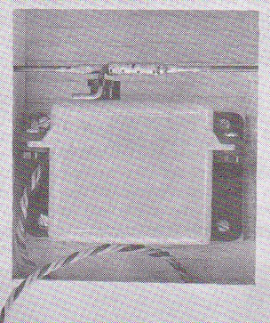

Hi Sketchin,
My manual states on page 22: "The aileron servo is mounted on a plastic tray designed to hold just one servo. The tray is in turn screwed to a plywood plate which was glued to the upper center section sheeting. The plywood plate, in this case 3/16" thick, also serves to raise the servo to the perfect height for the small spur wire."
Unfortunately, the plywood plate and plastic tray do not appear to be included with the kit as there is no mention of them in the parts list.
I'm not sure about the manual edition. I could not find any marks clearly denoting the manual edition. The back page does state Sig Mfg, 1987 and to the right of that, "30793."
Interestingly, the plans do not show the plate or tray!
Here is what the picture shows.
