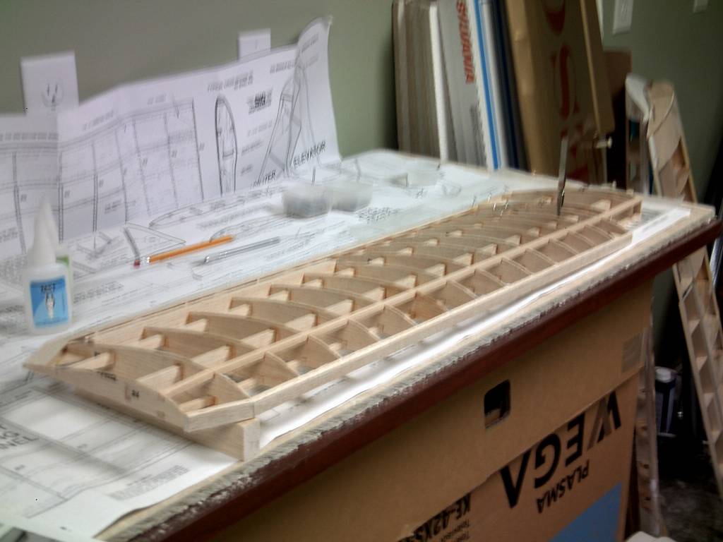

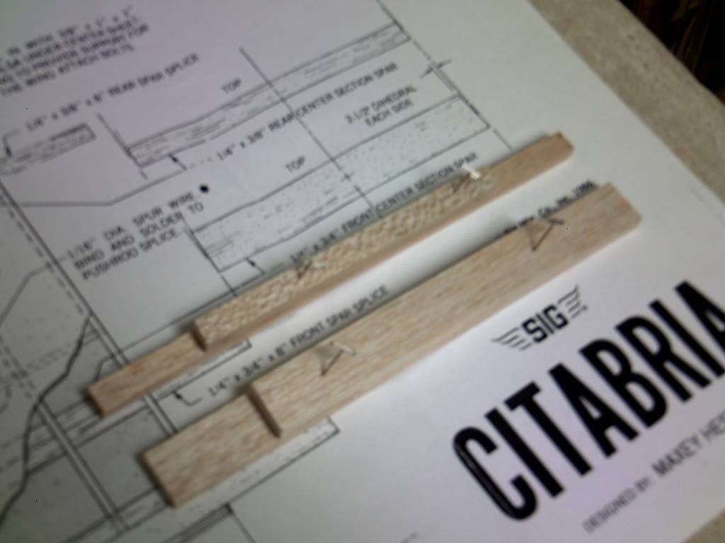

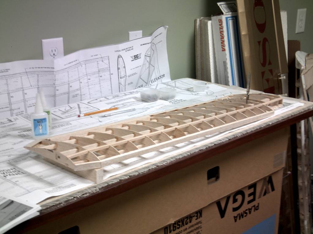

I finished the second wing last weekend and got started on the middle wing section. That section is pretty straightforward and I hope to complete it this evening. The hardest part is getting the dihedral set; however, it just needs to be done precisely. The actual process is not to difficult.
I should say that one thing is a bit tricky. The instructions say to paste the dihedral guide to a piece of balsa. Fortunately, I realized (at the last minute) that I need to trace the guide first. If I cut it out of the instructions, I would have lost the back page!
Old 04-06-2010 | 11:35 PM
  #30
Joined: May 2007
Posts: 186
From: Nashville, TN
Default RE: Sig Citabria Build

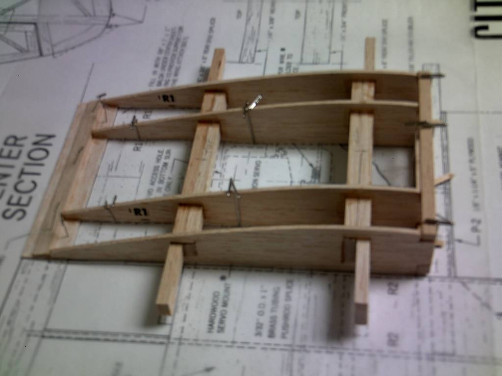

I finished the center section! Well, I guess it's actually not done as it needs to dry a bit before I can remove it from the building board. Anyway, now it's time for some sanding of the wings and center section.
The only issue I had with the center section was that the instructions were not very clear about the construction of the spars. The instructions clearly stated that I had to carefully cut the ends of the spars to match the dihedral. However, they did not state that I was supposed to glue two pieces of wood together to make the spars. Fortunately, the completed spars were shown on the plans and in the instructions. I've included my own versions here....

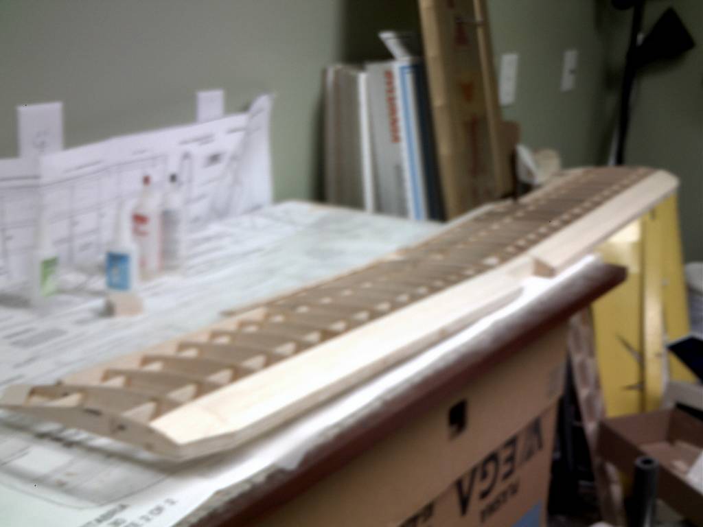

It's been awhile since I've posted anything, life caught up with me again.

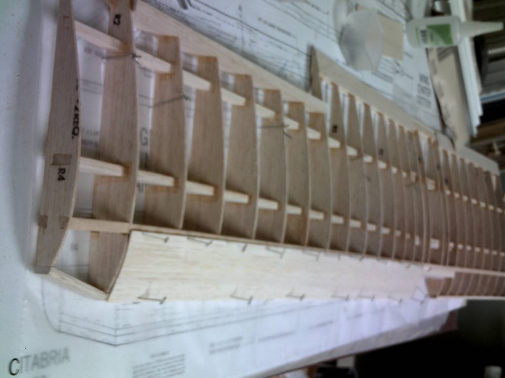

I have a few new pictures. First, I fixed the rib that I cracked while sanding the wings. Second, I glued the wing halves to the center section. I thought that process went remarkably well. You'll notice that one of the pictures is a nod to the writer of another Citabria thread.
Now, I am in a bit of a dilemma. I'm trying to figure out how to translate the instructions for the next step. If I remember correctly, I was told to notch out the inboard wing ribs and glue the doubler in place. It looks like it is talking about the doubler in the front of the center section. However, I see no way of making a single notch. Instead, it seems that I would need to cut off the inboard ribs so that I can place the doubler behind them. I've included a picture to try to make my point. Please let me know if any of you have better ideas!

Looks like you're on the right track.

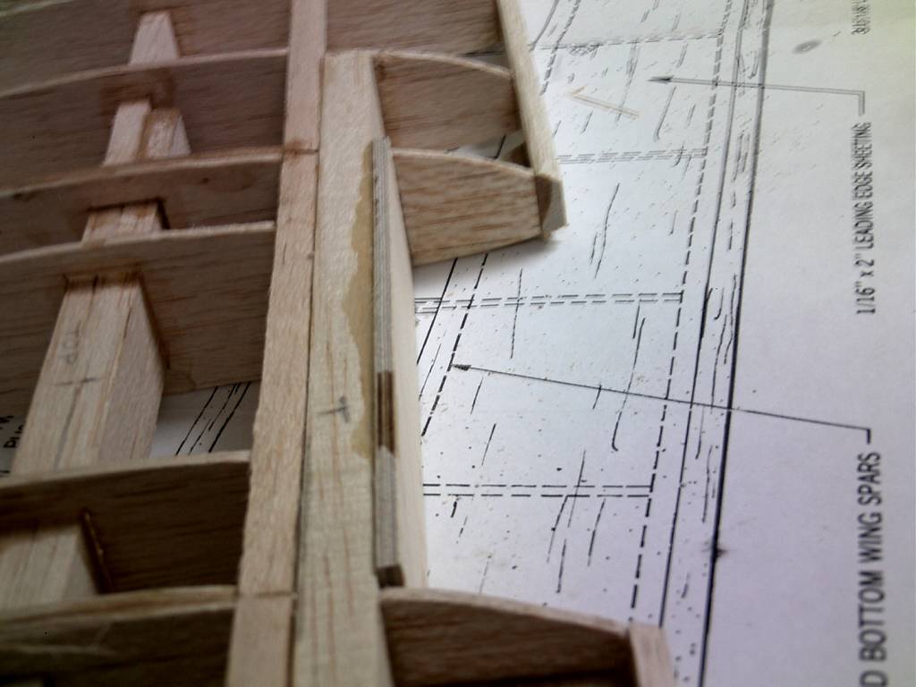

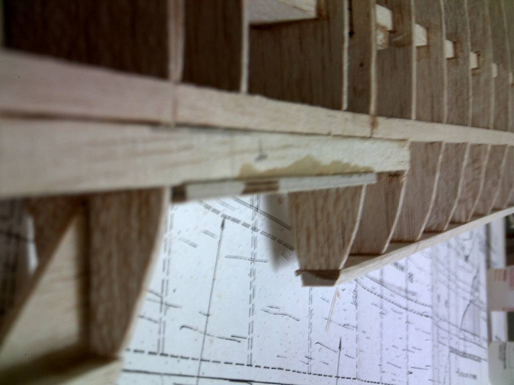

I bit the bullet and cut "slots" for the doubler on the inboard R2 ribs. The instructions called for "slots." You can see how I interpreted the instructions in the picture below. After doing that, it was rather simple to install the doubler. However, I should point out that I had to shorten it and then cut the ends to match the dihedral. Neither of these tasks was mentioned in the directions or plans. Then I glued the plywood plate to the front of the doubler.
Unfortunately, my favorite task now awaits... LOT'S-O-SANDING!

I finished the sanding of the doubler last night. It turned out OK and wasn't nearly as difficult as I expected.
I moved on to the next step which is to glue on some sheeting on the bottom and top of the leading edge of the wing. At that time I realized that I forgot to sand the bottom portion of the leading edge. Oh joy! More sanding to do!
The instructions state that I should do my best to prevent warping of the wing as I glue the sheeting on. Does anyone have any recommendations on the best ways to prevent warping? It doesn't look like I'll be able to tack the wing down to the plans very easily. Thanks in advance!

Hi Starwolf,
I'm glad you got that doubler figured out. I knew you could do it. Nice work.
Make sure that you sand that leading edge to match the plans and keep it straight along it's lenght. If you use a 2 foot long sanding block this becomes an easy task. When you are attaching sheeting it is important to keep the wing half that you are working on tight to your building board. Pin it tight in areas that will allow you to remove the pins later. You don't need the plans underneath it. If it's not flat and straight it's likely you will end up with a warped wing, and warped wings do not fly well. Pin it down so you can cover the top of the wing first. After the top sheet is on it is less likely to twist.
I like using contact cement (Weldwood) because it is the easiest method and holds on like grim death. Coat the framework wherever the sheeting will touch, and the underside of the sheeting with a thin coat. Let it dry to the touch. Line up the sheet. Use pins to slide it down and guide it into place. You only get one shot. You cannot move the sheeting after it is down. When the top is covered you will find that the wing structure is becoming more ridgid and it is easier to keep it flat and straight. Use the same method on the bottom. You may have to elevate your board to allow for the dehydral in the wing when it is upside down.
Good Luck

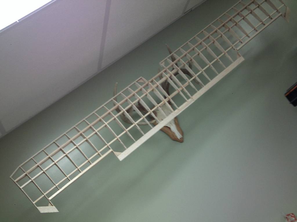

Thanks Senrak! I followed your advice and glued the top sheet on first even though the instructions state to glue to bottom sheet first. It was easier to pin the wing down doing it your way. I didn't use contact cement as I thought it would be too unforgiving. I used thick CA instead.
I then cut the holes for the aileron pushrods and glued the bellcranks together. Pretty easy, but I should have followed another poster's advice and drilled the holes for the pushrods before putting the wings together!

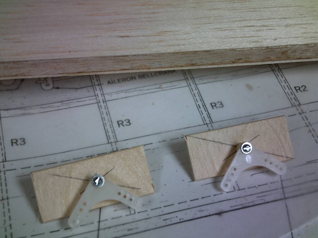

I glued the bell cranks in place. In order to position them correctly, I used a shim and marked it to the desired depth. Then I used the shim to position the bell cranks. The attached picture shows the shim next to the bell cranks.
