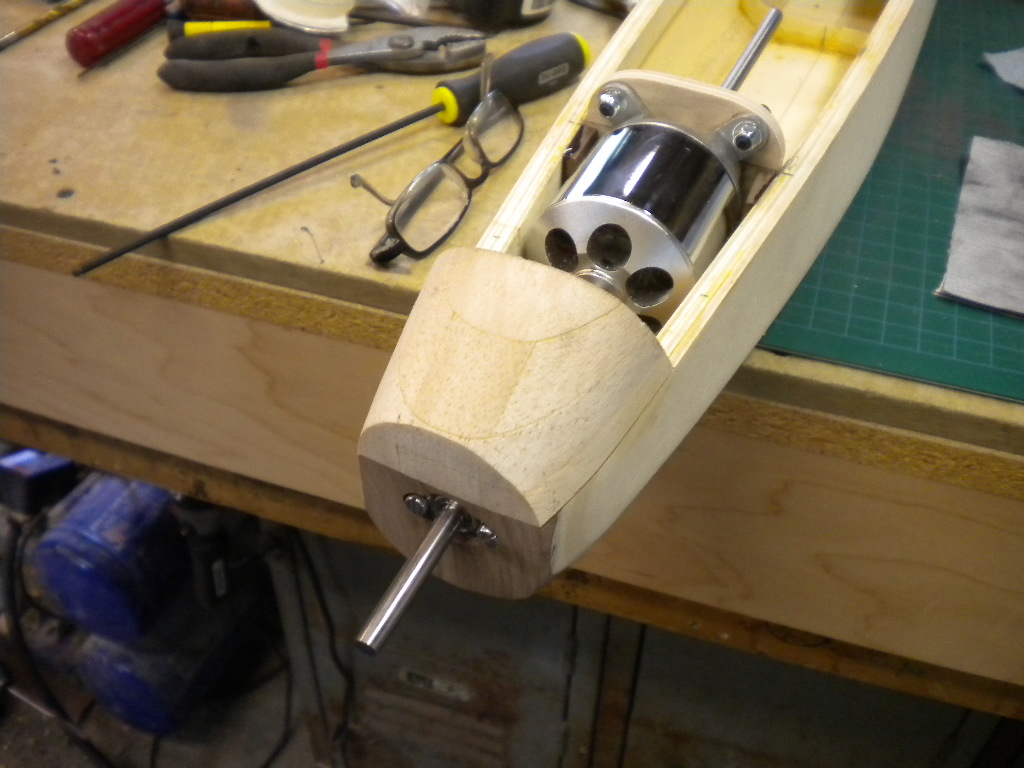

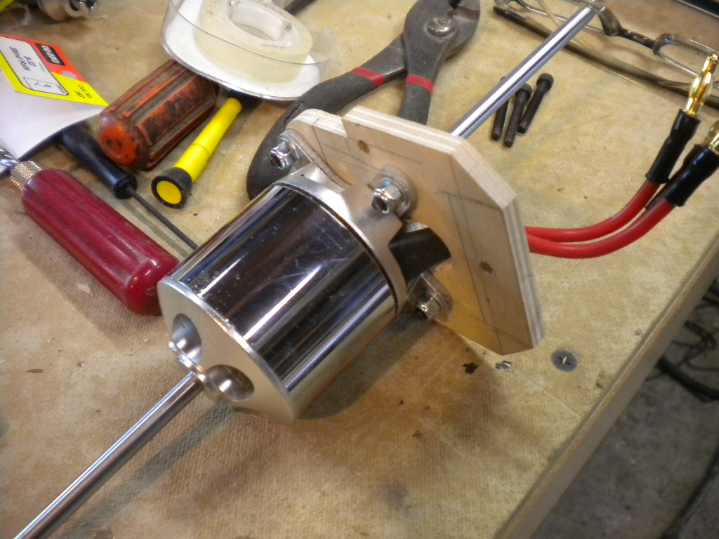

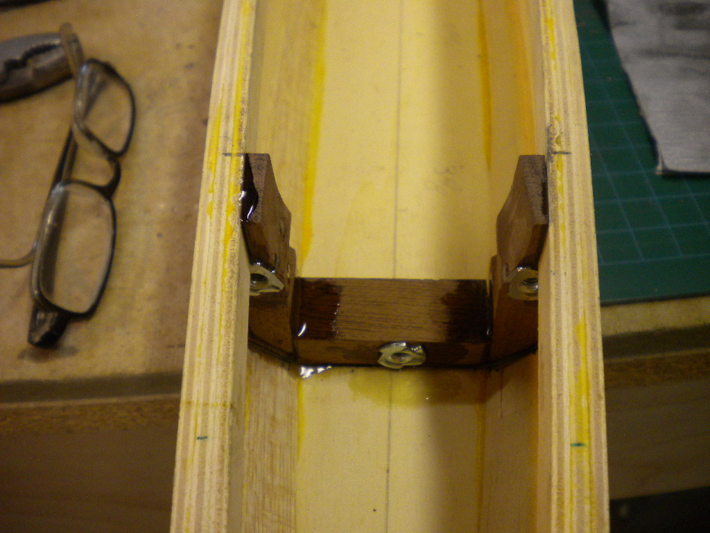

Meanwhile.... motor mounting. Wow this is tedious work. The long shaft needs to line up with the bearing. The firewall needs to be in the same plane (as in geometry... obviously it needs to be in the same plane/glider
) as the bearing. Then you're working inside an area that has curved side and bottom. Anyway, cross my fingers... I think I have it all right. I just epoxied the blocks into place and they have the T-nuts any everything ready to go. Once dry, I should be able to bolt it up and see if I did it good enough or not.
I also hope I have enough strength in the whole thing. The motor has to be above the cockpit sides by about 1/2", so there was no way to really anchor the uppoer part of the firewall. I have screws in each side and one on the bottom. I suppose the bearing in the nose will play a big part in torsional stress on the firewall. It certainly is not going to rip out forward. I think it is 'good enough'. This motor is huge. It seems like I checked it once and got 1700 watts on a 17x10 prop. Lets see, if it will in fact do that... I'll have close to 200 watts per pound! That should do it. [8D] Or, I might have a noseless model. [X(]
So, this is all good. If this plan works, I have knocked out one of the really hard parts and tomorrow, when the epoxy is dry, I'll know for sure. I should get my other prop adapter Friday or Saturday. I can then cut the motor shaft to length, put in the set screw notches and bolt it all together. Heck, I might even have to fire it up! And, if in fact it is successful, I'll get some shots of this whole business.

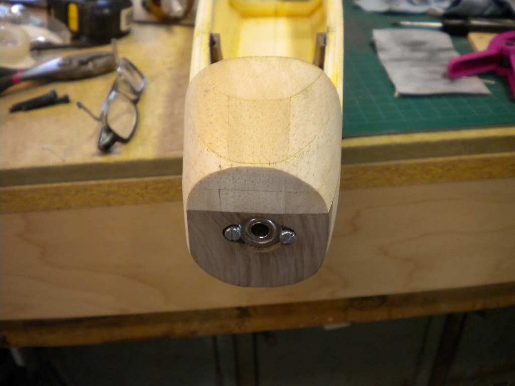

I am a bit anxious about the folder and the nose. The main part of the nose is walnut. The upper part is balsa. I'm yet again thinking that I might give it a coating of thin CA to harden the balsa before covering. Maybe that will help with the bit of prop damage inherent in these folders. OH... the Aeronaut prop is gorgeous! I have a number of these but none this big. I think I have a 12" in my Cularis. 17" is beastly looking in comparison!

Swish!!! Fit like a glove! I was worried about needing to do some shimming, but so far it seems that will not be needed. I'm thrilled! The big worry is over.
You can see it is really tight in the photos. I wanted this motor/weight as close to the nose as possible. More ballast up front will be in very limited space. I have good down thrust, but almost no right thrust. I'll just have to deal with that. Maybe I'll mix some rudder or aileron or both into the throttle? While I was laying it out, the motor would have needed to go way back to get much right thrust. As it is now, I have a couple of 3700 mah 25C lipos that should do a good job just behind the firewall. I'm hoping those and the few bits more... ESC (which I will for sure set up with soft start), a couple or few more servos, receiver... and I hope my balance is really close. I'm hoping for no more needed weight up front. And I surely hope for no needed weight on the tail!
So, the photos. I have the full length of the shaft in the photos. This is because I need the prop adapter before cutting it to length. It will be cut so that the shaft collar can be installed behind the motor which should leave it close to flush with the back of the firewall. The front... I'll work out so that the spinner is close to the nose of the model. I'll grind in some flat spots where set screws go for the prop adapter and the two areas that are flat on the existing shaft.
Removal/installation of this unit is 6 screws. The spinner screw, the two prop adapter screws and the three screws that hold in the firewall. In one photo, you and see the seven screws through the firewall. The one center bottom and the two outermost screws hold the firewall to the block supports. I used 8-32 screws for these. A triangle is the key. Three screws give you a triangle. Four screws give you two triangles. Two triangles really aren't much stronger than one. All the force should be forward (unless I nose in [X(] ), so I should only be dealing with shear force on these screws. I gave the firewall a 'really' good tug and it didn't budge or flew. I think I have 'enough'.

Geez man, those pics look GOOD!!! As far as the right thrust goes, I really wouldn't worry a whole lot about that anyway. That critter's got a looooooooooong fuse and I'd be willing to bet that just a bit of rudder on launch will more than do the job. Your layout (radio, etc) really sounds pretty fair too and I'm sure you're not gonna need tail weight. And even if you do, all it's gonna take is moving the batteries back a bit - easy as pie!
I was truly wondering about your motor mount screws but now that I've seen them I feel a whole lot better. You can tow my van with that screw mount!!!! I know very little about the electric motor set-ups but one thing I've heard over and over is "cooling" - sometimes related to the motor, sometimes related to the ESC. As you're doing the final set-up, make sure you've got good flow all around up there.

Thanks for the huge vote of confidence Dave! On the right thrust, well, weight closer to the nose was way more important than needing to give it a bit of rudder during powerups. As this is a 'glider' first, hopefully there will be no more than maybe twice per flight when the motor is actually powered up... so really not that big a deal.
I just about lost the nose off my powered Cularis. I was really surprised by this. It has a pretty powerful system in it but what I learned from that was the gyrotorsionalscopic (how do you like that word?) forces must be more powerful than just the tug force. It was those up - down - left - right forces that did the damage. I reinforced the whole nose area with fiberglass/CA over the foam and no problems since. I also extended the glass back down under the belly to protect it on landings. Anyway, at this point the motor system on the Merlyn should not have more pull than 10 pounds for certain. I can tug substantially more than 10lbs forward on this mount. And there is the bonus of the power system being supported on both ends. That front bearing will eliminate any side forces on that mount. I think this method should actually allow a greatly reduce firewall mounting... it really only needs to support the tug force and the rotational torque of a powerup. Again, I'll set the ESC for soft start.
And then cooling. Back to my Cularis. I can pretty much empty a 2100mah LiPo in that bird in about 2.5 minutes. That's a LOT of power. It has I believe a 45amp ESC in it. The Merlyn will get a 80amp ESC. The Cularis has fairly smallish holes in the nose and worst exit holes under the wings. I did a lot of enlarging of those holes to try to dissipate the heat. I think they say to have at least twice the exit hole size vs. the intakes? But, the Cularis is also basically a big insulated foam box with not a lot of open space inside. I have learned to do like a 15 or 20 second launch under power... let her glide about for a bit... do some trim work... then after a minute or so do the second powerup for about the same time and then she is up as high as one normally needs. I think I can be over 1000 feet in that time. After a quick flight, the battery and ESC are very warm, but I've never had an issue using this method.
On to the Merlyn and heat ventilation. I really don't want to be reducing the bit of slick that this old design has. It really isn't all that bad. Also, I sort of accidentally went from flat bottom wings to the Selig <sp?> 3106 is it? There was an option to add another 1/8" of sheeting to the bottom from the leading edge back to the spar. I really only just now learned this was an 'option'. It was in the plans... I did it. But, doing this left a step at the spar, so the covering wouldn't have attached to the ribs on the bottom and would have been flat and maybe flapping a bit from the spar to the trailing edge. What I did is added a second stack of rib caps from the spar back and planed/sanded a gradual curve down to nothing at the trailing edge. The outcome should be a wing that is even more modern and from what I understand, more 'slick'. I really had to do this so my servo pods could be mounted flush with the covering... and those have the same curve sanded into them. Blind luck... learn later that I did really good. Crud... meanwhile back to heat....
The Merlyn fuse is pretty large and wide open front to tail. Adding a wheel will give me an 'exit hole'. That leaves the question of what to do for an intake? I really do not want to do anything. I also have been questioning this reasoning. Adding holes adds resistance. But maybe I will go ahead with my thoughts on a couple of intake holes in the nose. I would expect that a fixed wheel would create a bit of a vacuum behind it? So the exit should be fine. Oh well... I think this is my final resolve on that issue. Thanks Dave for making me think about it some more.
Skids - I will not have a belly tow hook. It will either be aerotowed or motor powered. The idea with the motor 'module' it to be able to quickly exchange that 'pod' with a nose two release 'pod'. So, no tow hook to think about. I have been a bit worried about ripping up the covering on the bottom front and have been thinking that some packing tape over the covering would be a good idea. Having the wheel is hopefully going to reduce that wear. I got a response on another thread about locating that wheel. They said it should go under the leading edge of the wing... that sounds about right. I have to decide how much wheel to expose under the belly if it is not a retract (and yes on K.I.S.S.). I'd like it not to be 1" and 1/2" is likely too little, so maybe 3/4" is about right? It will still be sliding over the top of the grass on most fields, but that shouldn't be too bad. Also, this wheel should help a bit with less friction during a tug takeoff.
The tail skid is by the plans. It extends below the rudder which actually tapers upward toward the TE. It has a piece of Heart Pine laminated into the center, so should wear really well, but again, I'll like but some packing tape over the covering to protect it. I think this will suffice for rudder protection. Good to think about this though.
